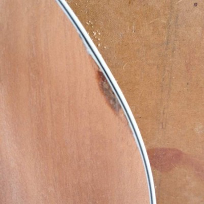

I'm hoping someone can advise on a good patch on what will be a dye stained finish.
This attempted patch is shellac and sawdust which I have done before, but this time things don't seem to be going well see pic:
I think the fault was caused by a slip while sanding the carve before the binding was on, leaving a dish beside the binding.
I have the offcut from which i could harvest a small piece if necessary, but I hope there might be a simpler way for an invisible patch.
Things were going so well....
Big ugly Scar..

That is not Good. I would dig it out and patch with matching wood. Only way to go here. It will be worth the effort in the end.
I always think that a well fitted wood filler patch is superior over dried glue especially for trying to match the existing, surrounding finish.
Carefully cut it out to a depth of maybe 1/8" (but removing the least material possible) using vertically cut chisels and/or knives, or a small router. Then close fit and glue in a tapered patch. It can sometimes be done to the point of invisibility, or at least that's the goal.

You could do a sunburst with no problem IF you put the color in the finish and not as a stain in the wood. Tint the lacquer and put the dark coats on first, finish over with clear. When you don't try to use color that is supposed to soak into the wood, you won't have any trouble.

hi. I went weak at the knees on reading Barry's advice, but i really had no choice ..so ..i cut with an assortment of hobby knives chisels...whatever..
the patch was small and flimsy and broke a number of times...
I have never done anything like this, and never want to again...but..
here are the 'after' pics...
The bandages are just off..still a lot of prep to do on the the top, but I don't believe I could have expected a better result due to my relative inexperience. Thanks for all your considerations guys
