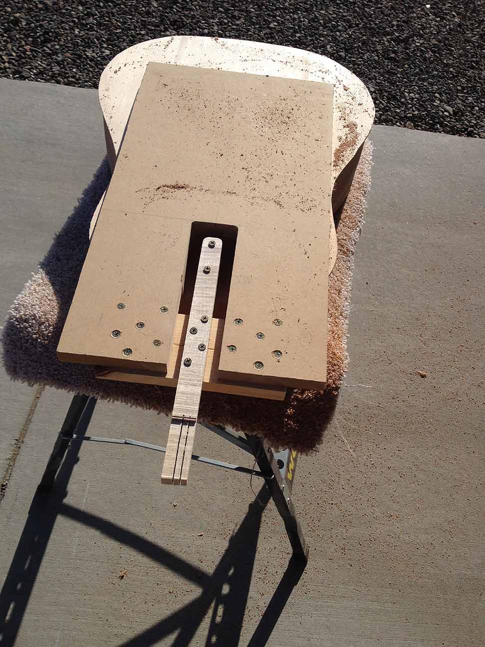

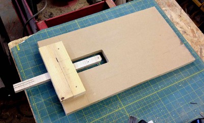

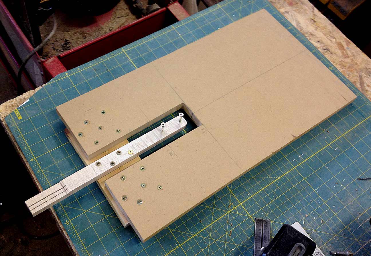

How about making a template with a central tongue that you can screw into the middle of the area to be removed. Once the perimeter of the pocket is cleanly cut, you can remove the template and carefully free hand the cutting out of the center. Or, then make a template that fits the pocket with the center excluded so you can then cut out the center. In other words, two templates, two steps.
- Posts: 1197
Re: Attach routing template to spruce top
Thanks for your replies. Bob, I think I'll try your idea as the simplest and most secure. I'll try to modify the existing template I just made to put a tongue in it to screw down to the central pocket area. I'll let you all know how it works out (or if I'll be rebuilding the guitar.
- Posts: 981
You can attach the existing template to a new board and cut just the perimeter with the existing template leaving the tongue on the new piece, now, the new template.
- Posts: 1197
Too late, I already modified the existing one with scraps, and I'm too cheap to waste another piece of MDF.
Maybe a little overbuilt, but I don't want it to move.
Now I just need to ramp up my intestinal fortitude to use it on the guitar, but scrap first as usual.

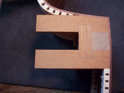

I build a composite heel-block which leaves a 3/4” wide by 3/4” deep pocket that runs about 3/4 the depth of at the top. If it were music it would be a waltz.

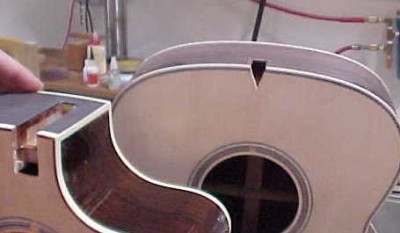

Anyway, I cut a notch in the top/sides where the neck goes, big enough to get a 1/2” bearing-on-bottom router bit in there and use the pocket as a guide. I just rest the router on the curved top keeping it perpendicular by hand control. As this doesn’t cut through the top (because I stops the bearing at the bottom), I save the tear out part for when I pretty it up by hand. I've taken to scoring the face of the mortice by hand. A foot operated on/off switch helps here.

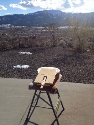

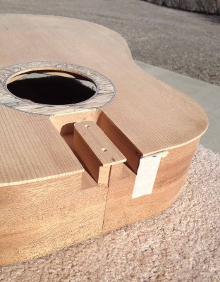

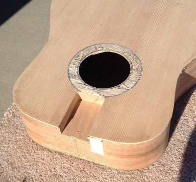

Yesterday most of the snow finally melted and it was 50 degrees outside, so I finally did the neck pocket.(I like to route outside so the wind blows the dust away.
) It went well except for chipping out part of the side. I put tape on the right side of the pocket where I knew there would be a problem, but didn't realize the bottom would be too (and it looks like it wasn't glued very well either.) I guess pre-scoring these areas as you suggest would be the way to go. Live and learn. I found the chip and glued it back in, so it should be fine.
Here's a few pics of the results.

- Posts: 981
Congratulations. Nice rosette.

Here is a picture of the heel block of my most recent build. This guitar is an experiment, in case you're wondering what the inner plate is about. The wood was narrow and long. Thinking about my speaker building days I'm aiming for some lengthening of the box as found in transmission line or folded horn speakers. Just a slight boost in the lower range would help the smaller box. We'll see:

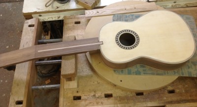

There is a 3/4" spacer at the bottom of the joint as pictured here on a cut-away; the V-cut to get the bit inside, and the result with extra space in the top for the truss rod. Clamp the guitar upright hand holding the router. The router stops at the V in the top when the bearing hits. Finish by hand:

Ok, so now I get to air my dirty laundry.

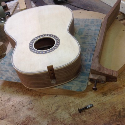

I hadn't done this joint for 5 years and had several guides to put in my tenoning jig and used one too short. So I had to move the threaded inserts closer together. That required filling of the original hole in the headblock and drilling a new one after the body was together. Also that nasty little bit of tearout on the top just below the mortice. Let's keep this to ourselves.
You could glue the this but I want to be able to take it apart in future. A dovetail would be easier to take apart.
This joint is fairly easy to make a nice fit and take apart again. That's important when you have to do it 3 times because you're still not happy with it.
Here are a couple of pics that I think will explaine it. I use epoxy on the threaded inserts. I used to worry about the strength of these, probably because of some implied inferiority by some. I read an article in American Lutherie magazine, by a physics oriented builder, that the pull on the heel 2 1/2 inches from the top, with 165 lbs tension (med steel strings) was 35 lbs. Or so - thats from recollection. And if they come out... well, just put them back in.

Here's the design of my neck attachment. It's held on by string tension (and a nice tight pocket), and it's so great to be able to adjust the action with just the turn of a small screw through the fretboard. Here's the thread if you haven't seen it, and a pic from that thread.
