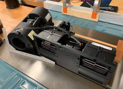

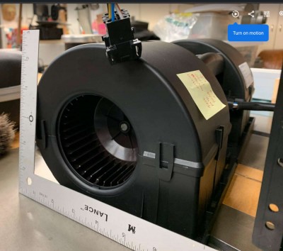

I've been planning on getting a shop air filtration system, and almost bought one for myself for Xmas. By coincidence, someone at my day job bought a used military transport HVAC air handler. It had 4 blowers in it and he sold me 2 of them ... for a song. and i can't sing, so that's sayin' sumthin'.
they are Embpapst, German made, units that can do 700 cfm. At only 6"x12". And they are not used, they are brand-spanking-new.
So I need to build a hanging shop air filter(s) around them. My sinuses will thank me.

Check out my blowers!

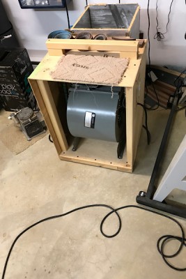

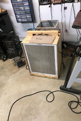

This is what I did. It sits on the floor and blows up to the ceiling. I use the 3M Filtrete 1900 filters. I have a duct that I attach to it when I spray to blow the fumes out the window (the box containing the guitar to be sprayed backs up to it in the front). A timer shuts it off so I can clean the air after I leave the room.
Nice blowers.

Bob Gramann
Posts: 1120
Location: Fredericksburg, VA
Re: Shop air filtration build - Advise welcome
Post by Bob Gramann »
That would be it. Lowes gives a discount when you buy 4. All sizes cost the same, but you get more filter surface the bigger the filter. I use the 20x25. I took one apart. The pleated filter was 8 feet long.

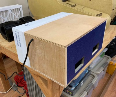

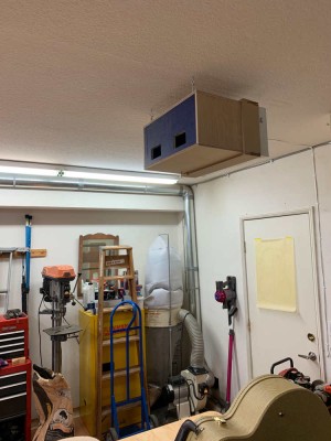

Below is the bid from the front. I made them from plywood material i have just laying around - The face piece has a purple plastic veneer.
The 2 rectangular holes are where the air comes out - and boy, those blowers can push a hurricane of air.

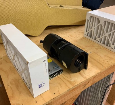

Behind the unit I've placed the "guts" of what is in the box.
Chuck Tweedy
Posts: 1182
Post by Chuck Tweedy »
The rear with the "guts" in view.
The guts are the blower, a 24 volt DC power supply, and the filter.

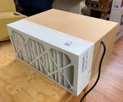

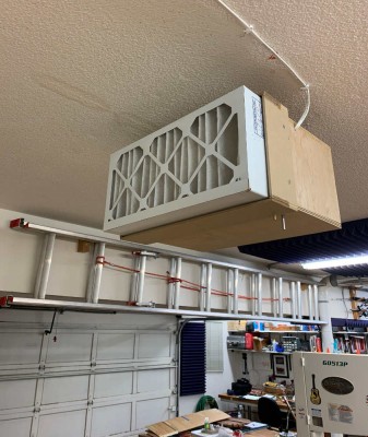

And finally, just the back.
So far the filter is just duct-taped on to the back of the box - which is designed to be the same OD as the filter.
Here's the thing...
Thanks for bringing up NordicPure, but I am NOT impressed with them.
The filters are supposed to be MERV13, which should be filtering small particles at a high efficiency. But the filter media on these is not great. It is not even as thick/dense as the filters i usually get for the house (Honewell), and those are not rated as high. I also bought some filters for the house since I was on the site and i needed some. They are supposed to be MERV14, but it is the _same_ media as in the 4" deep ones.
There simply is not enough density of filter media in these to be what they claim to be. Beware.
So what? So, I'll get some better filters of the same 20x10 dimensions and work from there.
Anyhow, the general design is good. I still need to mount the unit on the ceiling.
I have a potentiometer poking out of the box so i can easily control the blower speed, and i have a pressure port so i can monitor the back pressure of the filters (these have almost NO back pressure)

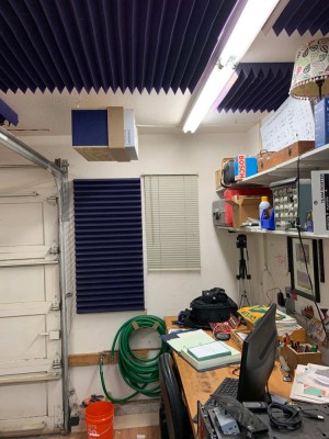

Follow-up:
System is complete. I have made 2 boxes, added Filtrete 1900 2nd-ary filters, hung them on the ceiling, and put them on remote control.
They are in opposite corners of the shop - pointing so they circulate the air in the room. It is real nice.
