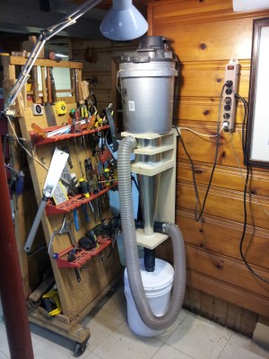

my shopbuilt wall-mounted system has worked very well indeed with no appreciable collection of dust in the upper grey bucket where the HEPA filter is (see pic, also a construction thread from a few years ago). However, I later built a movable version on a furniture dolly that is a bit too clumsy to move around the tight spaces of my place. I'm thinking of building one with the Thien separator, but I'd really like to manufacture several mini- micro- separators for each machine.
from top to bottom: buckethead vac w/ HEPA filter, shopbuit 6" dia cyclone, collection bucket, the cyclone exhausts directly into grey bucket
