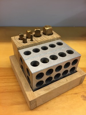

Some years ago I made a holder for my 1-2-3 blocks and brass setup bars as shown in the pic below, and decided I needed something similar to organize my feeler gauges so I wouldn't have to remove and replace them from the post, or worse yet, have them loose in a drawer somewhere so I'd have the devil's own time finding a specific size.

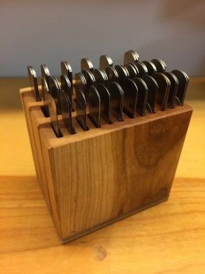

I cobbled together the holder shown in the second pic below from some sappy cherry I had in the stash. I used a rip blade that cuts a flat-bottom kerf to cut 9/16" slots into the stock. The blade was a scrunch over 1/8", so I just cut a slot and moved the fence over by 1/4" and cut the next slot. Whacked off three pieces about 2 3/4" long from the resulting board, glued them together with some 1/4" MDF on the open side and the bottom, slopped some BLO over the whole thing, and Bob's your uncle...
There are 12 slots per row, so I know that the front row ranges (left-to-right) from .001 to .012, the second from .013 to .024, and the third from .025 to .035

Looks like it will do the job... (don't let it fall on the floor)
Jim McConkey
Posts: 1096
Re: For feeler gauges
Post by Jim McConkey »
Lining the dividing walls with outdated calendar magnets would go a long way to help with that problem.

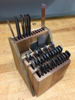

This has, shall we say, "evolved" since I first posted this.
Now it has places for a short 3" scale, a fret-rocker, a StewMac setup scale, some fret shields and nut slotting files.
