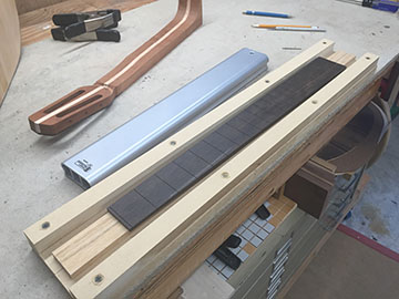

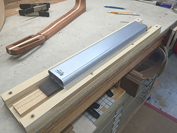

Here is the version of fretboard radiusing I am presently using. It is simple, it is labor intensive, but it works well. I will say though that the more elaborate types as presented by Martin Taylor and Mike Trobaugh are outstanding and maybe I'll build one someday when I'm tired of the 'back and forth' sanding approach.
The jig is simply 3/4" MDF with an 1-1/2" x 1/4" oak strip centered in the trough to raise the FB and allow for a side space in which most of the sanding dust collects. I simply center the FB on that strip.I have since tack-glued a thin piece of wood as a stop at the nut end and simply use a couple of thin pieces of double stick tape to hold the FB in place. I use a 20" radius for my instruments right now and pretty much any other sanding beam would fit in the trough. The one thing you can't get away from with either version when you want a different radius is the need for additional sanding beams ($$) or additional ridiused jig components and then you're dealing with removing the router, plus additional storage, etc....
I am considering adding a handle to the sanding beam just to make it easier to grab on to. Another thing I've found was that the full length sanding beams, if that is what you like, are the best. When I used the shorter ones I had a tendency to end up with tapered ends on the fretboard and the full stroke of the long beam eliminated that.

This is exactly my method, but with a shop-made 16" sanding caul. Yes, put handles on it!
