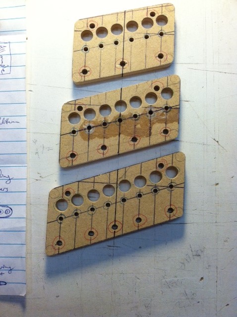

Howdy, folks. In an attempt to improve accuracy and repeatability in my work, I've made some templates of a bridge base plate. They should serve as a drilling guides, as well as outline and centerline references. I think the pictures will explain a bit...
The templates are in 1/4" fiberboard (reinforced with CA after this picture).

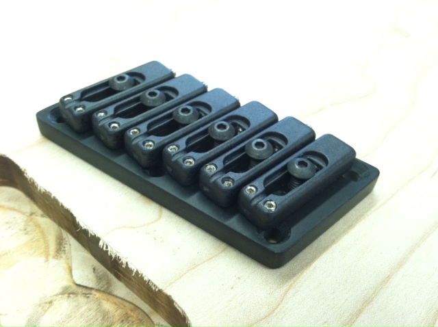

These bridge plates will utilize Graph Tech Wilkinson saddles (I've seen a number of folks using this solution for multi-scale bridges).

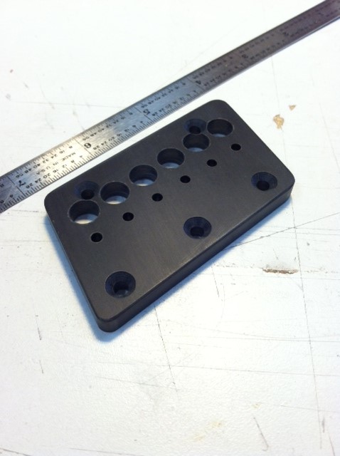

Looks pretty cool, but there are some issues. First, I need to re-think the string-through-body escape hole: the largest hole on the plate is long enough for a range of intonation adjustment, but being a circular hole, is too wide for the saddles' height-adjustment screws to stradle. It really should be a slot. I'll fix that on version 2.0.
The biggest problem, though, is that I really need to drill those saddle post screw holes VERY accurately. Here's where I need the advice. How does one mark out and drill holes and get them to go where you want, using basic layout skills and a drill press? My work is very close, but the saddles are clearly not equally spaced on the plate. Should I ditch the fiberboard and use the phenolic as the template? Once I do that, how do use the template as an accurate drilling guide?

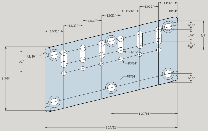

Here's something else, though: I downloaded the free version of SketchUp, and have been playing around with drawing my bridges very accurately so that they could eventually be translated into tool paths (by someone who knows more about CAD/CAM that me!).
That looks pretty good! And hey, wouldn't it be great if I could just print this out, stick it to my work, punch the drill points, and Bob's yer uncle?
Here's my next challenge, then... how do I print it out full scale? There are all sorts of file types that SketchUp will export: pdf, eps, bmp, jpg, tif, png, exp, dwg, dxf. I tried it as a PDF, but that didn't work. I am not learned in these sorts of things.
EDIT: (sigh) Google is my friend, as is the help page on SketchUp. I am holding a full-scale printout of my bridge. Cool!

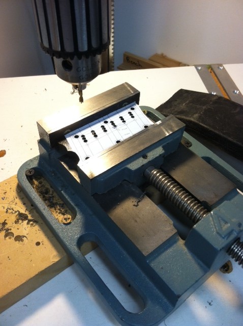

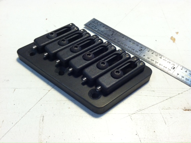

I just finished up a successful attempt at bridge plate version 2.0.
A 1:1 scale printed template drawn in SketchUp was glued with a thin smear of fish glue to a piece of 1/4" phenolic, and then I used an awl to punch the drill points. The print options in SketchUp give a high definition print that is very crisp and fine-lined. I buried my brad point bits in the chuck to minimize deflection, cranked the drill press up to 2300 rpm, and went for it.

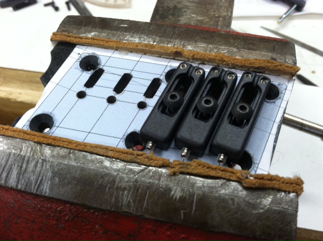

I used needle files to blend the three holes that make the string-through slot. This was a little tedious, but doable in phenolic or wood. This would be challenging in aluminum or brass.
Testing the alignment of the saddles. It was VERY good.
Phenolic, being a plastic product, can be polished to a fine finish, but I just went up through 1500. The dull finish actually matches the Graph Tech saddles pretty closely.
Pretty damn sexy, eh?
