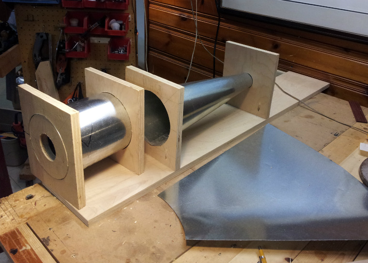

Hi, here's the details.
While reviewing shop-vac cyclone systems that I saw on the internet, there were a few things that I thought were not optimal. Most appeared somewhat bulky and unstable to move around, and usually the plumbing connection between the vac and the cyclone was likely more complicated and longer than I thought necessary. So I decided to make a wall-mounted system that is stable, compact, and with minimal plumbing.
I lack the fabricating skills and tools of a sheetmetal worker, i.e. drafting patterns for shape & seam allowances, and folding the seams and soldering them. Besides that, a sheetmetal worker usually would construct the cyclone first, and then attach the finished cyclone to a supporting structure. I decided to use the support structure as an armature to shape the cyclone. I made the cylinder diameter 6", and the funnel length 18", and the inlet was 2.5"D and the outlet 3" D First I cut 8"x9" rectangles, marked the centers, and then cut out the centers.

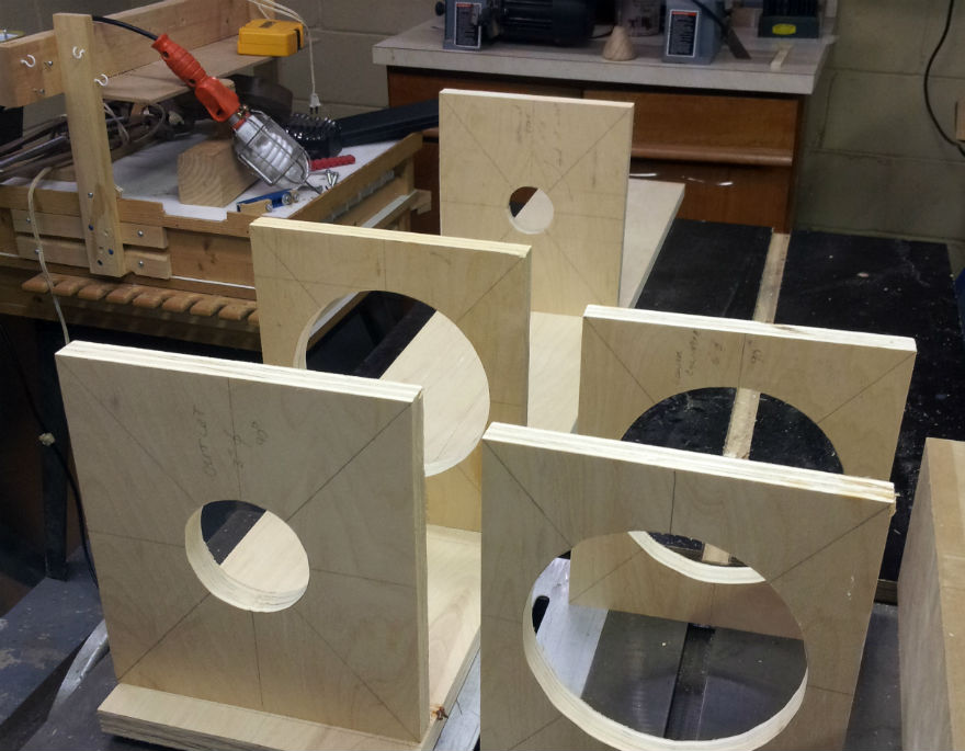

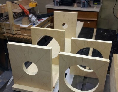

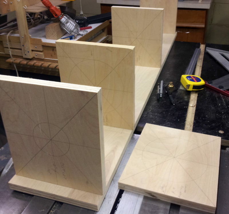

After fixing the supports rectangles at their stations with pocket screws, then I cut the sheetmetal for the funnel to the approximate shape and inserted it into the support. I then traced around the support to mark the exact cutlines, removed the sheetmetal and cut it. Then I put it back in the form, and used aluminum duct tape to fasten and seal the seam (this makes a smooth seam, and is strong enough because the supports hold the shape.) I fitted the sheetmetal for the cylinder but waited to tape the seam until the tangential inlet hole was cut out. (The sheetmetal on the bench is the approximate shape for the funnel, to be used on the next cyclone).

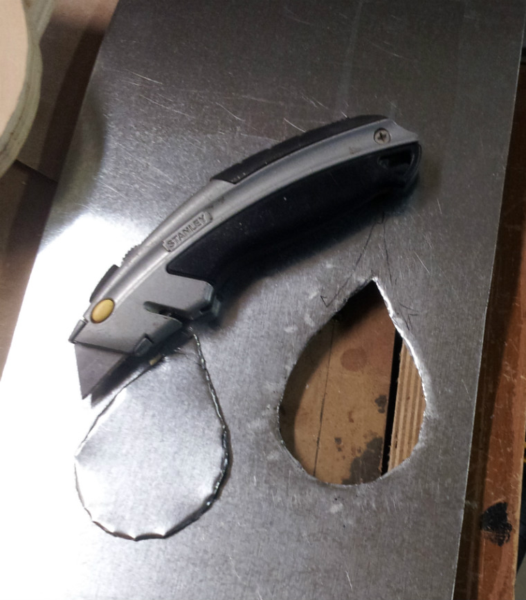

Shaping the inlet is the most difficult part. I found an old textbook 'Sheet Metal Work by Neubecker that is freely availble online (interest to look at!), and learned how to draw a pattern for the inlet tube (p. 136). I cut the tube, and then held it up to the sheetmetal to trace the hole's shape, and then I removed the sheetmetal and sheared through the metal with utility knife by placing the metal over the crack in the bench. I then cleaned up the hole with a hammer and file, and refitted the metal into the supporting form.
