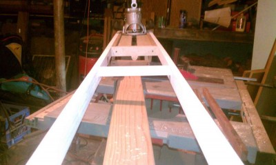

To address this issue, I have developed a fretboard "shaping" jig that DOES take the fretboard taper into account, because the jig actually pivots off the theoretical convergence point of the outermost strings. Instead of using the fretboard end radius, my jig uses the actual bridge radius, so that is predetermined based on player preference, feel, etc. I say "shaping" instead of radiusing, since in theory the jig will work with any (reasonable) nut and saddle shape, even if one were convex and the other concave. I actually used this to effect in the last instrument challenge, where I created a twisted fretboard surface.
I need to take more pics of the jig in action, but here are a few to whet the appetite. In this pic the two lines depice the fretboard end and nut, respectively. The router carriage is affixed to two lengths of wood beams that extend to the convergence point, where it pivots on a steel rod.

Here is a view from the pivot point. The round part under the jig is 1" in diameter, and there is one on the other side of the carriage, where the theoretical bridge is. What makes this jig work is that both these "followers" are identical, and the same cross section as the 1" core box bit in the router. The bit is also set at the same "depth" as these two followers. In this way, the carriage can be tilted and still produce an accurate cut. If your start and end radius aren't too drastic, even a straight bit would work (and probably cut faster) and the jig design itself would prevent the corner from digging. Since the "nut" side template is a distance from the nut, it's radius needs to be calculated, though it's rather easy to do. To keep the fretboard edge the same height, you would have to layout the guide templates so that the heights are the same at the bridge and nut widths.
It should be clear to see how a twisted board could be produced, simply by making "canted" templates. This would necessitate using a round bit.

Here's the fretboard form the last challenge, which has a 10"-14.6" compound radius, AND is twisted 5.5 degrees (1.5 to the left at the fretboard end, and 4 at the nut) for a total of 8 degrees from bridge to nut. This is also a multi-scale fret arrangement as well...
