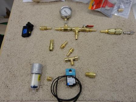

First up, the basic bits and pieces. Specialized parts - such as the vacuum controller, mac valve, filter, and gauge - were purchased from JoeWoodworker.com, but everything else came from Home Depot. All fittings are 1/4" ID brass with 3/8" barbs to link the 5/8" OD braided tubing.

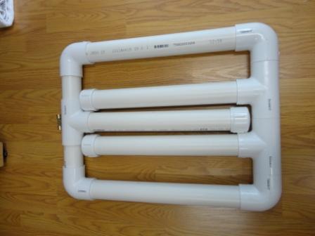

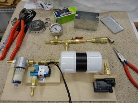

Here is the main manifold coming together.
Re: Jason Rodgers builds a vacuum clamping system

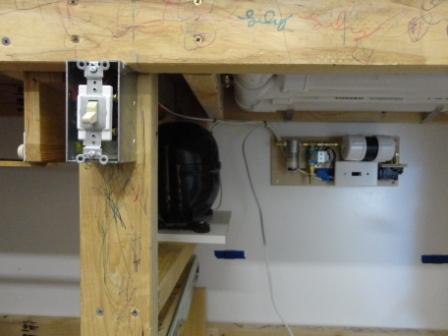

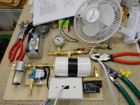

And now wiring. I decided to wire a fan into the mix to cool the pump. Not sure how hot that thing is actually going to get in use, but as you'll see below, it's installed under a bench, so I wanted to keep the air moving around it.
A vacuum system is like a compressor system in reverse: both need a reservoir system to keep extra pressure so the pump isn't running constantly. Joe Woodworker suggests a reservoir made of PVC. I built mine with smaller pipe and in a maze-like assembly to a) be able to tuck the whole thing under a bench, and b) get as much volume as possible in that predetermined space.

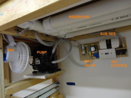

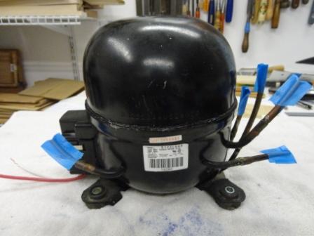

Here is the refrigerator compressor that I am using. Thanks to my dad for pulling it out of a (decommissioned) fridge at the dump in their small town. I ran all over the Portland-Metro area trying to track one of these suckers down with no luck!
All of this is tucked under one of my benches. If you saw my post on my shop construction, you'll remember that I have a very limited space (88 square feet), and so I need to be very efficient with the installation of anything in the room.

And here we are all plumbed, wired, and ready to roll.
The vacuum controller is dialed in to pull down to just shy of 24"Hg, then kick back on at 21"Hg. While my wiring of the extra component - the fan - didn't result in success on the first test run, I figured it out and was very happy to find that the plumbing is tight and holds vacuum well.

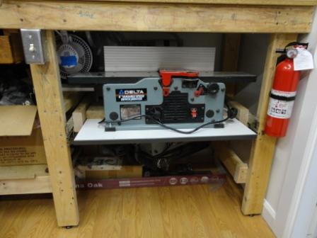

And here's where it all lives! Again, if you saw my shop build post, you saw this picture of my pull-out, flip-table shelf for the jointer and belt/disc sander. Yep, the whole vacuum system is in there, and nothing gets tangled up.

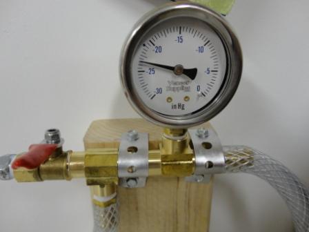

If it's not clear from the various pictures, the gauge and ball valve are plumbed through the bench top, right over the manifold, and are attached to the wall at bench level, right next to the go-bar deck.

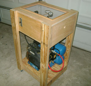

I have a simpler system but my tank is big enough that the mac valve liked to bounce on and off rapidly at the end of the cycle. Now there's a leak somewhere so it never shuts off, that fixed the bounce at least. I have it in another room so I can't hear it. I just wish I had a remote switch to turn it on and off without having to go through 3 doors to unplug it.

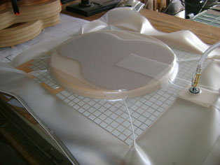

I built one using the JW concept as well. Without it I could have never made the laminated backs that I'm presently doing correctly, and I have a few poor ones to prove it. Also, isn't fun to build your own tools and save a few bucks for buying wood?

DJ, is that one of the veneering bags from Joe Woodworker?

The bag is actually from QualityVac.com. It is a 3'x3' - 30mil Poly bag that was on sale. They're nice guys and very helpful and open with advice and they have a decent website. I almost opted to make my own bag to get a more custom size but after reading a lot of stories on them I just didn't want to fool with it and the glue and such.
