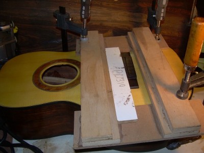

I was routing a saddle slot today and thought I would post a few pictures of the way I do it. I like to rout the slot after the bridge has been glued to the soundboard, and in this case, after the guitar has been strung up and the best saddle location found by placing a temporary saddle under the strings. It takes some of the pressure off having to place the bridge precisely where the saddle slot needs to end up.
After the slot location is determined (by measurement or using temporary saddles) a line is drawn on the bridge. The jig is then aligned using a piece of wood that gives the same off set as the router bit.

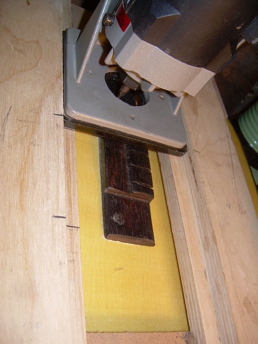

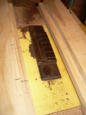

The router is placed in the jig and the bit is located at the "start" and "stop" ends of the rout and fiducial marks are placed on the jig. These allow a clear view of the end points of the rout. The router is adjusted to make a shallow cut, placed in the jig , raised so the bit is slightly above the bridge, switched on and gently "plunged" into the wood. The router is then moved back and forth to the fiducial marks and the end points of the rout. This is repeated as needed to give the full depth of the rout (I usually do it in three passes).

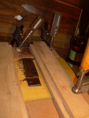

The reason I use - three - clamps placed over the sides is I don't want to place "tons" of clamping pressure on the edges of the body. One clamp slipped on my first pass, but two kept things held in place. I reset the third one before the next pass.

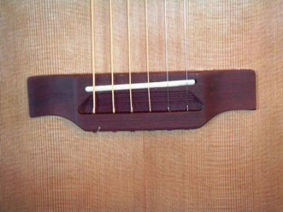

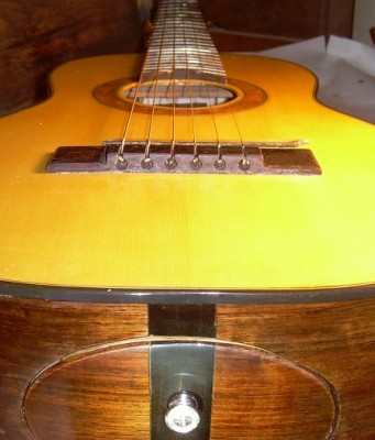

Hi Carl,

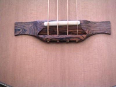

This is the latest permutation of my travel guitar bridge. It is made so the strings slip out the back and remain with the neck. The neck unbolts and slips into the body through the tail port of the guitar. The neck is retained at the peghead in a recess in the head block and bolted through the heel at the tail port. The bridge was redesigned from my original to increase the gluing footprint and add additional strength to the slots
Re: poor man's saddle mill
Here is the "old" design. There was another design in between that used a closed slot - it gave more foot print, but no additional strength to the slots. The latest design is probably the heaviest of the three - gain some, lose some.
Looks like the slots are generally sized to the stings. How are you cutting them?
Hi Carl,
I start them with a half moon blade mounted in an oscillating saw, and then widen and "ramp" them as necessary with various saws and files before gluing the bridge to the guitar. The windings at the ball ends are fatter than the string so that is taken into consideration

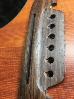

Thanks, Clay. I figured you had an easy way. Here's some pics of my attempts at a pinless. Not shown is a round bottom groove milled on the drill press across the front of the bridge to hold the string balls. Holes were drilled from that groove into the recessed area in front of the saddle. I like your slots better. The bass bridge is Bocote, the other Manzanita.

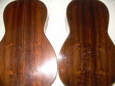

On the guitar pictured above I tried a new waterbourne finish (Endurovar) and found some things I like and some I'm not real happy with. What I like is the ease of application (brush-able) and environmental friendliness (low odor, VOCs), but things I don't care for is the difficulty of touching it up and the way it changes the color of the wood.
Here are two guitars made with matching wood. The one on the left finished with Mohawk nitro, and the one on the right, Endurovar.

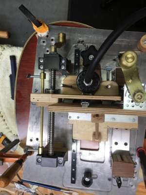

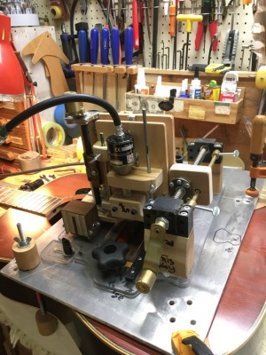

I think this may qualify as a poor man's saddle mill because I spent less than $200 on it. I built it a couple of years ago but have been reluctant to post it here cause it is such a Rube Goldberg looking tool. But here it is anyways. I made it with linear slides and zero-backlash ball screws that I bought of eBay. It uses a 60k rpm pneumatic spindle that gets used in other jigs. I took some inspiration from David Collins bridge mill that is no longer available.
- Posts: 3254
It is kind of heavy but that may inadvertently help stability. The ideas I got from David Collins is to use two base plates that allow incremental adjustment so that I can make the cut in several passes. I can easily move the upper base over a few thousandths by using feeler gauges so I can widen the slot to the desired width. Taking small cuts creates a very smooth channel.
It's a thing of beauty!
- Posts: 1182
its a beauty all right.
but Barry, i don't get the blocks with the big slits in them. On the opposite side of the unit from the X-stage. In line with the Z-stage.
what are those blocks for?
- Posts: 3254
Stops. I had to add another set of stops for each axis because the ball screws exert a lot of force. Not really happy with the design or function of the stops. Need something smaller and stronger. Ideas?
