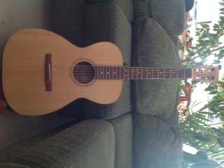

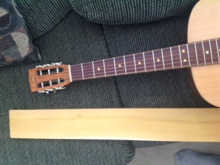

I finished my second flat top about a month ago. It is a 12 fret slot head sort of based on a 000. Spruce top, Walnut back and sides with a cherry wedge. I'm quite fond of it, but the reason I thought it might be interesting to some of you is that the fingerboard and bridge are cooked osage orange. Here's a photo, with a piece of the raw osage I cut the fingerboard from beside for contrast.

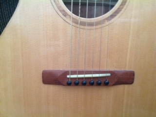

Incidentally, the position markers are holly. Here's the recipe: Wrap the board in aluminum foil (shiny side in) and cook in an ordinary oven at 350 F until you like the colour. This could take several hours. You don't actually need the foil. I think that it slows the overall process, but drives the colour deeper into the wood. That is when you shape parts, the wood will be a little lighter underneath, and this is a bit more pronounced if you don't use the foil.
There is a little tung oil on it, which did darken it a little. Here is the bridge.
- Attachments
- 12 fret bridge.JPG (27.66 KiB) Viewed 24652 times

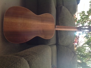

A couple more pictures. The back - nothing cooked back here.
- Attachments
- 12 fret back.JPG (31.94 KiB) Viewed 24652 times

Full frontal
- Attachments
- 12 fret front.JPG (32.77 KiB) Viewed 24652 times
