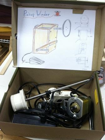

As you may have read in my discussions on pickup flatwork and winder platen design, I've been researching pickup winding and have built my own winder. Jason Lollar's book, Basic Pickup Winding and Complete Guide to Making Your Own Pickup Winder, is a great education, and there is obviously a ton of info online, as well (much of which probably stems directly from Lollar's book). Thanks to the folks here who have participated in my posted discussions and have contributed to my knowledge thus far, particularly David King and John Sonksen.
The concepts and construction of my design is gathered from many examples, but it clearly looks most like the Schatten winder that StewMac sells. Lollar's design includes a second motor for a cam-driven wire guide, but hand-guided winding is plenty good for my purposes. Here is what I started with: a box of sewing machine parts and a pretty little drawing (my 9 year old daughter asked me to sit down and draw with her one afternoon- while she attempted a portrait of the cat, I drew up what I was thinking for the winder). It's not complete, but one more trip to Ace should wrap it up this weekend.

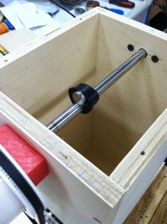

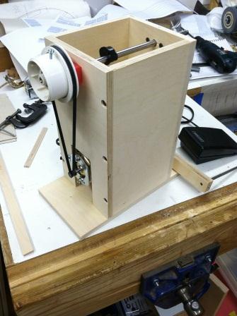

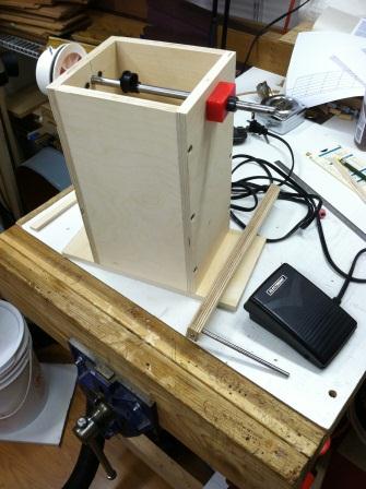

And so I went about building the box/tower with 1/2" plywood. The red blocks are UHMW plastic. In this picture, the wire guide arm is not yet attached.
A view from the other side.
What's not seen in either of these photos is the pedal/power jack and switch panel on the back. I was very lucky that this sewing machine (my wife's old machine that broke down) had so many usable pieces that went together in this project so well. Even the 1/4" rod for the wire guide came from the needle shaft.

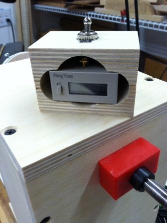

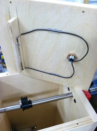

In the platen discussion, we also got into the topic of counters. I don't know how accurate this setup is (what with the issue of "bounce" in mechanical switches), but I think it will work for my purposes (i.e., ham-fisted, scatter-wound hum-wreckers).
The main sewing machine shaft had this cam affixed to it, for transferring power to the bobbin and fabric advancing mechanism in the base of the machine. It made a perfect mount for this neo magnet...
... which activates this reed switch (thanks to John Sonksen for the reed switch).
The reed switch closes a circuit that advances this very simple, battery powered digital counter. The toggle switch on the top is an on/off to stop the counting when not actually winding: when mounting the bobbin or stopping to reverse and fix some errant wraps, you don't want to throw off the count.

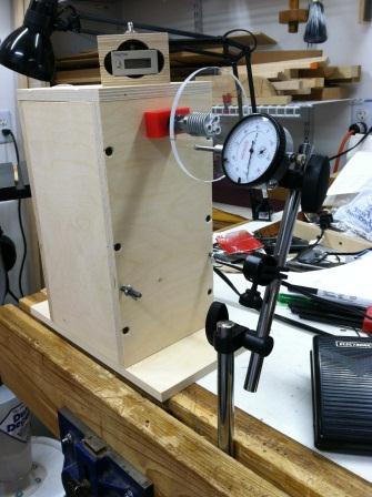

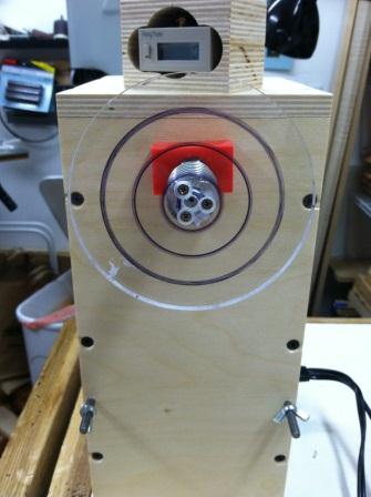

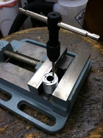

On to the bobbin platen. I went with a light-weight plexi disc. It's just two pieces glued together with CA. To mount the disc, Lollar recommends tapping a shaft collar for three screws. Again, the Sewing Machine Anatomical Donor provided: this worm gear was tapped for three 3/8" 4-40 machine screws.

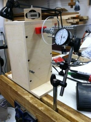

Getting the disc to run true took a little fiddling, but I got it down to about .05" or less of runout. I discovered that the plexi didn't glue up perfectly flat, so some of that wobble is in the disc itself. I think that's within an acceptable margin of error for my purposes. Heck, when I visited John Sonksen's shop, we wound a coil by double-sticking a bobbin to the turny knob of a whole, unmolested sewing machine!
And here is the final picture of construction thus far. I drew a bullseye on the disc to help with centering the bobbin since I didn't exactly get the platen centered on the shaft.

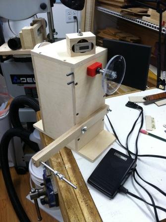

Anyways, here is my complete winder machine.

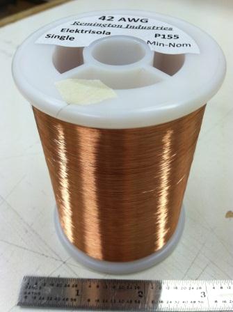

I've also purchased a 1lb spool of poly coated 42AWG magnet wire from Elektrisola through amazon. Y'all GOTTA check that out! I don't know how much magnet wire typically goes for, but a 1lb spool was a couple bucks less than StewMac sells a 1/2lb spool, AND it's free shipping. I figured I'd need as much as possible, as I'm likely going to break and tangle a lot of wire. A 1lb spool of 42 wire is 51313 feet, or over 9.7 miles!!! That oughta keep me busy!

Oooooo, wire in the mail.
