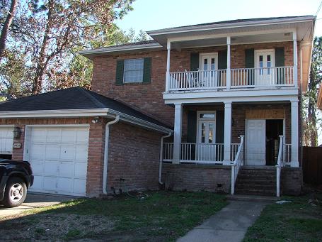

My friend Cheryl and I flew down to New Orleans this past week to make sure that we would be set for a two week volunteer project. I am sure glad that two of us went! There are few working traffic lights and a lot of missing street signs so she was a fantastic navigator and picture taker and list maker and all around help.
Amy Hopkins - 01/08/2006.18:38:39
MIMForum Staff and Poet Laureate
The family that lives here is a musician named Bruce Barnes (nickname "Sunpie") and his wife Maria, and their two children. Sunpie is a park ranger in the Jazz heritage park and Maria teaches high school French and Spanish.

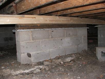

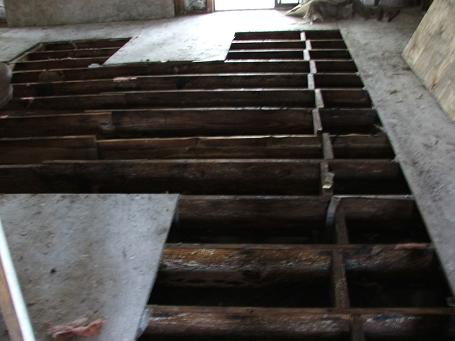

But the floor looked pretty funky and on crawling into the crawlspace...........yuck.
Amy Hopkins - 01/08/2006.18:46:02
Someone years ago had stapled sheets of plastic to the underside of the joists! It was probably to prevent moisture from rising up to the joists but in this case it held all that water up! They were still soaked!
Amy Hopkins - 01/08/2006.18:49:19
We hadn't intended to do any work, just check out the situation. But the joists had to dry out. I bought a couple of tools and a respirator and coveralls at the Home Depot so that I could go under the crawlspace and pull the plastic off.
Amy Hopkins - 01/08/2006.18:54:50
It was pretty gross under that crawlspace! But we got all the plastic off and hopefully the joists will dry off. Sunpie and Maria should be able to get more cleared off before we get back.

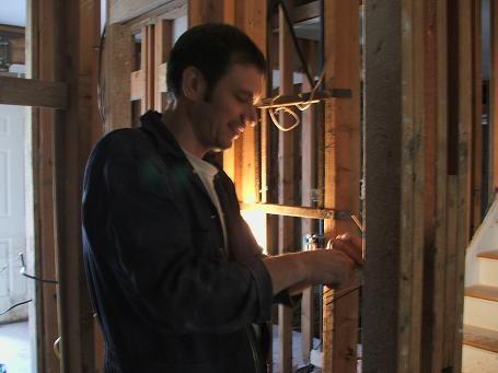

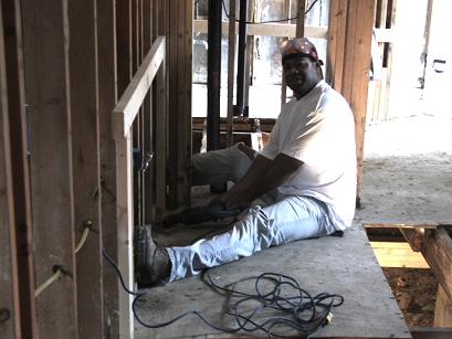

Dave LeFever got started right away on the wiring, switching all the old boxes and all wires that ran below flood level. I had brought wire and boxes from our True Value in Pennsylvania. Sunpie and Maria's house was built in the seventies and there were a lot of unnecessary kitchen wires, typical seventies! A built in wall toaster, a funky intercom system. The house itself was really well built though, two by ten floor joists, three quarter plywood on the floor. We ran power from the neighbors house for our saws and the lights that we needed.

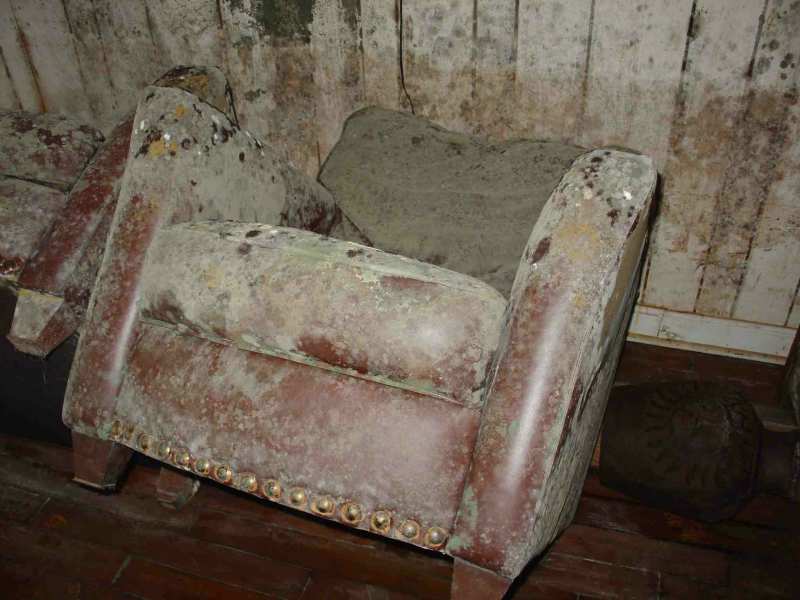

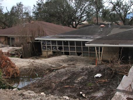

While Sunpie's house was NOTHING like it had been, mold hanging in streamers from the ceiling, it was still really yucky because of the water that had been trapped in the floor system. We all wore respirators working under the crawlspace and much of the time that the floor was open. You kind of develop a symbyotic relationship with your respirator. Being under the crawlspace is a bit claustrophobic anyhow and the lessened breathing you get wearing the respirator limits how much time you can stay down before going outside for fresh air.

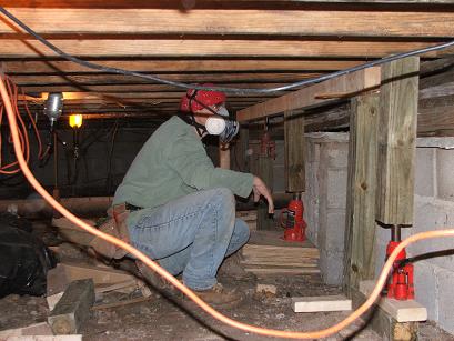

Snowbear and I did most of the crawlspace work. He tore out the old air conditioning ductwork, the insulation surrounding it was soaked and the whole duct under (and probably over) water level will be replaced. I started right in jacking up floor joists to replace the two main beams that run the length of the house. They were one of the few things on the house that were poorly designed, just four two by fours stacked up. I replaced them with the same, but then re-inforced them with two by sixes on each side to make a beam that was bigger and stronger. Here is the sagging original beam.
Amy Hopkins - 02/06/2006.07:51:09

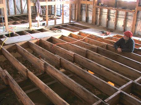

I built a temporary support of two by fours and cut short posts to jack with. Some of the floor was easy to jack up, once the plywood was off of it! I started with the easy side, no walls above to weigh the joists down.
Amy Hopkins - 02/06/2006.07:56:53
Cheryl and I had torn out some of the plywood on our first trip down, I wanted to get as much of the wet plywood out and new floor down as was possible. Tearing out three quarter plywood and hauling it to the curb was a job! Also the kitchen had subfloor and linolium, Sunpie and one of the guys in his band had torn out some of that but the subfloor was nailed all to hell and gone and was a bear to tear out. We made a pile on the curb, every few days the Army Corps of Engineers picks up the trash. I wanted to ask where it went, but right then was just relieved to see it go.
Amy Hopkins - 02/06/2006.07:59:39
We got the jacks situated and after a few false attempts, up went the joists.
Amy Hopkins - 02/06/2006.08:08:58
The mold on the joists was already going away, each day before lunch and before we left, I kicked everyone out of the house and sprayed everything I could reach with a mix of bleach, water, and mold killer recommended by the folks at Home Depot (our heros!!!) Every day the house smelled better! Snowbear had fixed the water lines the first day, so we had working bathrooms upstairs as well as running water in the hose outside. It was a little weird to go upstairs in the house and see the kid's rooms in perfect shape, while the downstairs is so devastated. I used a two gallon hand sprayer to apply the bleach solution.
Amy Hopkins - 02/06/2006.10:38:05
Then slid in the new two by fours and nailed everything up. Easier said than done when we got to the sections where there was some weight on the walls.
Amy Hopkins - 02/06/2006.10:44:31
We couldn't stay down under for really long periods of time (a couple of hours and you really need a break to take off the respirator) I cut new plywood as soon as we could and laid it on the floor, on the one hand I wanted to give the joists more time to dry, but on the other, I was looking at safety and getting the job done. There was pretty good ventilation under the crawlspace, so I figured that it would dry out, flooring or no flooring. Cheryl nailed off the entire floor, and got started on the insulation of the exterior walls.
Amy Hopkins - 02/06/2006.10:47:40

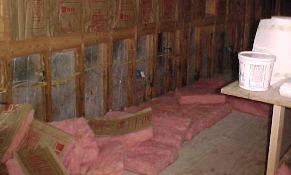

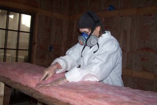

At this point, a lot of the wiring was done and Cheryl was cutting and installing insulation. Turned out she has a real knack, in almost thirty years of doing carpentry, I've never seen as neat and nice a job!! I wacked together a table so she didn't have to cut on the floor and she did a beautiful insulation job. We left the stapling to Sunpie and Marie, after electrical inspection.
Amy Hopkins - 02/06/2006.19:33:22
The walls were looking good, Maria was really sweet and said that it looked better than the old wallpaper.

The electrician had done some wrapping up in the house, Dave LeFever had gotten the bear's share of the wiring done on the previous trip and the electrician got us a hot box downstairs as well as replacing a few more wires higher up (the water had wicked up the paper covering the wire so some of the higher wires needed to be replaced) I hung all the stair posts up out on the deck to scrub and paint. The house smells a zillion percent better but it was still nice to work outside.

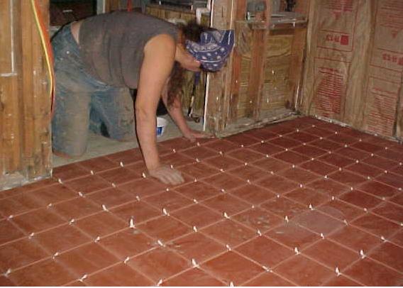

We set up a little table on the screen porch and had a hot plate and little fridge. I fell in love with the Geckos, they wandered around on the screen and would puff out their little orange thingys on their necks.
Amy Hopkins - 08/27/2006.12:58:24
The moment of truth! The first sheet of drywall went up, 5/8 is heavy to hang!!I hung the sheets from the top, the ceilings are 9 foot and if there is a lesser flood anytime, the bottom foot could be pulled and replaced. This was my reasoning anyhows, we'll see what the future holds.
Amy Hopkins - 08/27/2006.13:06:02
Sunpie was off Sunday and Monday so we were able to really get some drywall up.We put the stairway back together and there were some bits and pieces of framing and backing that needed to go in but for the most part it went smoothly. We hung the living room and the hallway.

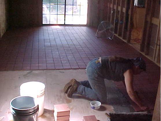

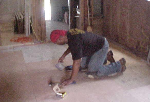

The main part of the house is three inch yellow pine tongue and groove, it used to be oak but we are doing pine now. The kitchen will be the red quarry tile, about two hundred square feet. I'll be down there from Friday to Tuesday, Sunpie is trying to get off work Saturday but it may only be Sunday Monday and Tuesday. Dave and I will get a good start Friday.

We used the air gun some (once we got all the attachments right-two trips to the hardware store!)but hand nailed a lot of it. On Sunday, Sunpie's son who is nine came in right after soccer and had a blast hitting the power stapler.
Amy Hopkins - 10/01/2006.09:53:10

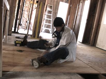

The floor looked fantastic! We worked til one in the morning, on Monday morning Sunpie came early and we sat and played music for a little, it was hard to get rolling. We finished up the main house floor and started the underlayment in the kitchen.
Amy Hopkins - 10/01/2006.09:56:42
The tile seemed to take forever, six inch tile is really pretty but takes a while. We were going to leave Wednesday but ended up working til midnight. Laying tile is hard on the knees no matter what kind of padding or kneepads you use.
Amy Hopkins - 10/01/2006.09:58:54
Finally the last tile. Dave snapped this shot at a little after midnght on Wednesday. A bath and a couple of hours sleep and we left at three thirty for the drive back.

We are terrible photographers, and it seemed like all the pictures I took were of peoples rear ends. Here is Dave and Aurilien (I think that is how his name is spelled.
Amy Hopkins - 10/01/2006.16:51:13
And Sunpie, his carpentry ability has improved tenfold since I was down there the first time.

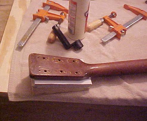

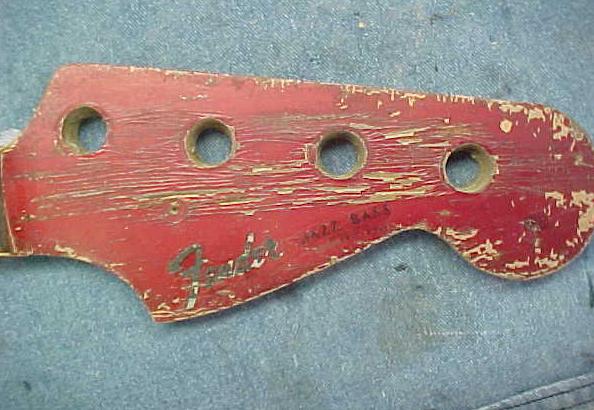

Oh, I also fixed the next door neighbors Martin with a headstock crack, where there is a will there is a way. Two blocks cut from a 2x6, a bit of drywall, some jigsawed out curved cauls, a bit of leather for padding cut from an old glove, flooring strips to support the body and there it was.
Amy Hopkins - 10/01/2006.16:54:28
And a really good solid clamping-I would have liked the hot hide glue but one makes do.
