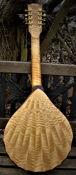

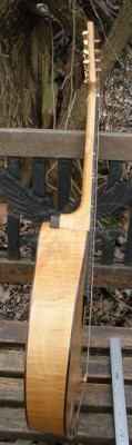

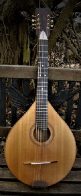

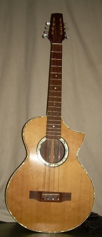

I have made some short scale (22 1/2 inch) double strung tenors (as I call them) on an LG 3/4 pattern body. The are strung with octave pairs like a 12 string and have worked quite well. One of them did have 5 courses (10 strings) and also worked fine.
On the Octave mandolins I found that using cylindrical arching on the soundboard and doing a reverse taper on the body (like the old citterns) allowed me to add some additional stiffness to the top and move away a bit from the "guitar sound" and give it a stronger attack.
For the 4 course instruments I found good quality mandolin tuners worked well and for 5 course individual mini tuners worked fine. Ebay had some 5 on a plate tuners, but they were somewhat marginal quality.

As Jim mentioned I also prefer a slightly wider string spacing than what McDonald uses, but again - it is player preference.
On the shellback instrument the player eventually wanted to explore 5 course possibilities, so with the wider neck I separated the strings of the lower course (and changed the string gauges) which actually worked fairly well. Later I did build her a 5 course,10 string cittern (Sobel's usage - actually, organologically most mandolin type instruments could be classified as citterns)

Thanks for the pictures. It looks like a 3/4 size donor guitar and 5 courses of strings would make a pretty cool instrument tuned like an octave but with a low C perhaps. Citterns have different tuning apparently so as a mandolin player I would not know how to play it. The good thing about strings is you can change them around and try things out.

Awesome chatoyance on that one! Like Clay's, the body on mine is also tapered, 75 mm sides at the neck, 84 mm at the tail. Not sure where I picked that idea up from.

Just to add some clarification - the reverse taper on the body allowed me to use a taller bridge with greater downbearing and the cylindrical arching added some stiffness to the soundboard which the combination of I think affected the attack of the instrument. Tilting the neck back to make the bridge taller may be equally effective.
My preferred tuning for a 5 course cittern was GDAea (Irish music). keeping the number of different notes limited I found helpful for open chords. I have known people to tune them CGDAe to good effect (I'm just not that good of a player).

On the scallop shell backed instrument pictured above the owner wanted to go lower (CGDae) so we split the bass course as I mentioned. She was a lifelong mandolin player and an excellent musician with a beautiful voice. After her passing her son brought it by for a tune-up and new strings. She will be missed.
The angle formed by the strings as they pass over the bridge and the tension on the strings determines the down bearing (down pressure)on the bridge and can have a great affect on the sound of the instrument. It is not so much the height of the bridge, but rather the the way it affects the angle of the strings over the bridge. As you mentioned with violin family instruments this can be a critical factor in the way they sound.
