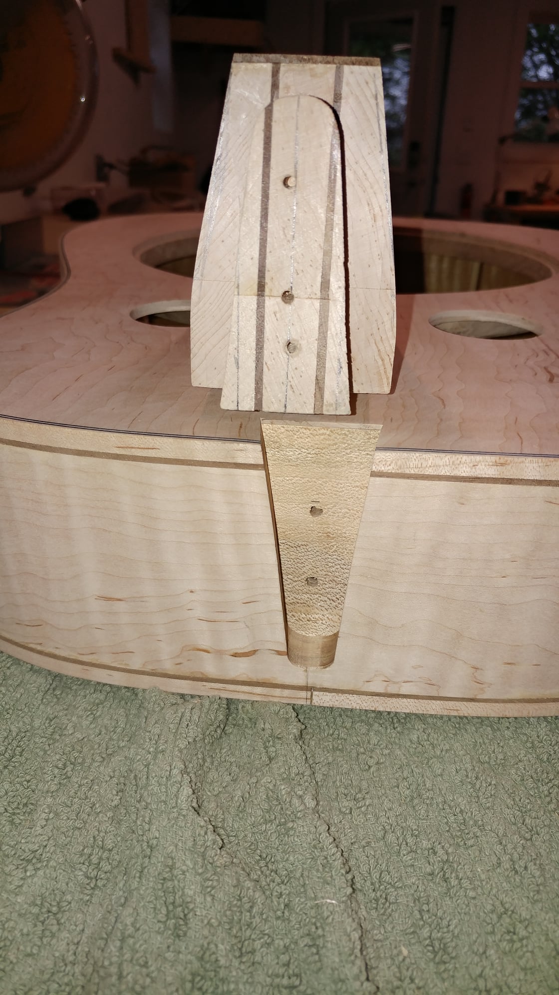

The neck dovetail will be locked in place with two screws installed from the body interior. Drilled the holes though the neck block from the outside, then inserted the neck and marked the hole locations in the neck heel. ( The third hole is left over from the dovetail fixture).
I am not planning on gluing in the neck after finishing. Looks like the dovetail joint, locked in place with the screws, will be strong enough. I like the idea that the neck can be removed for any future repairs or adjustments. Time will tell...-

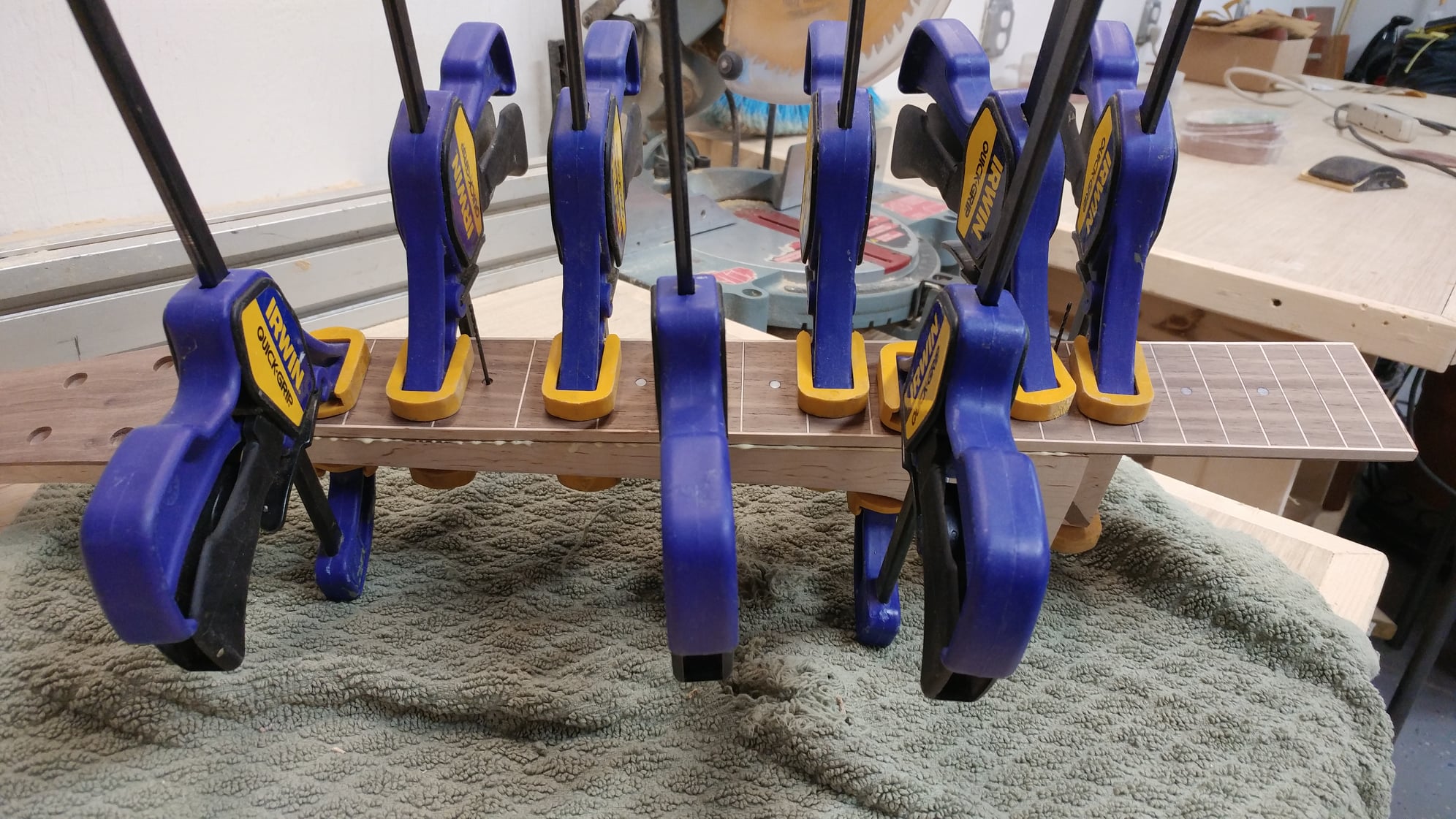

Under this forest of clamps is the fretboard glued to the neck. This is where the two pins really help with alignment.
You can never have too many clamps!-

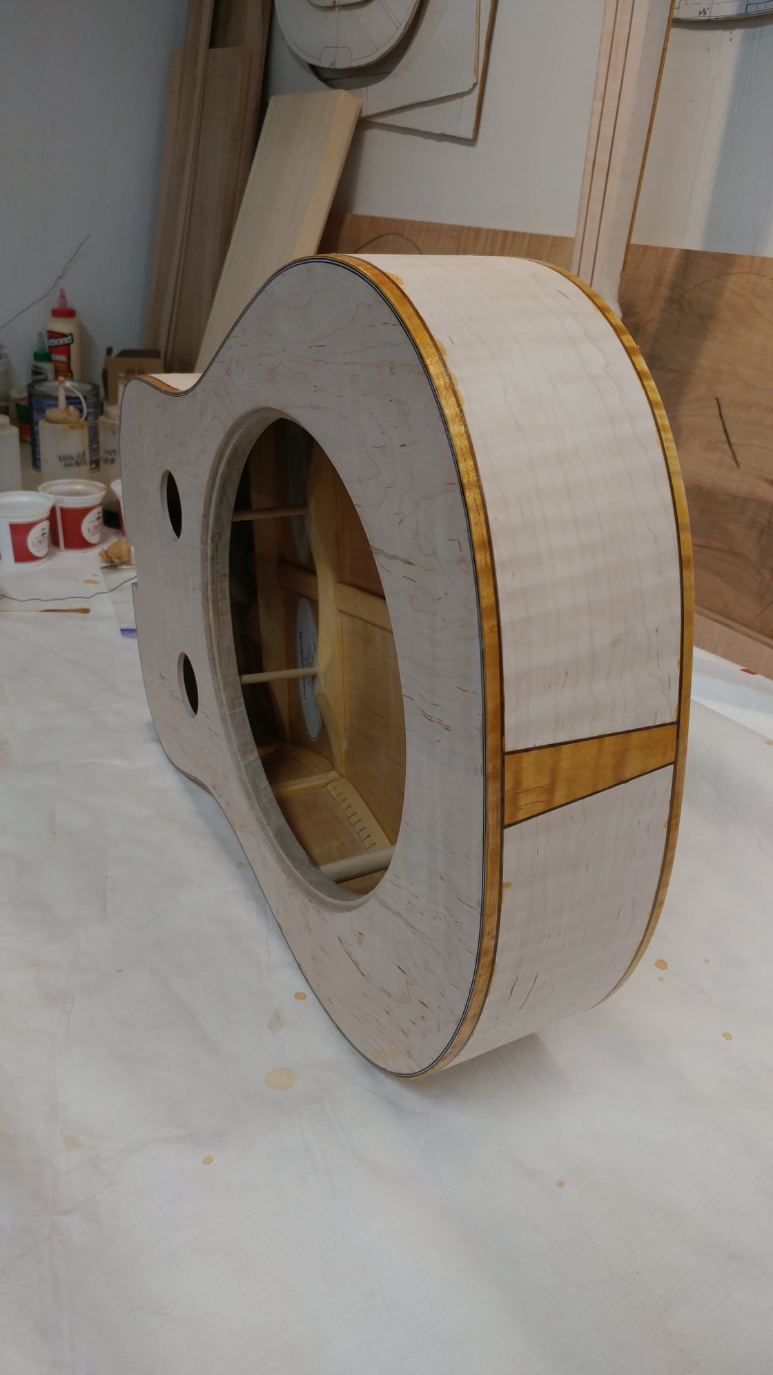

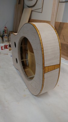

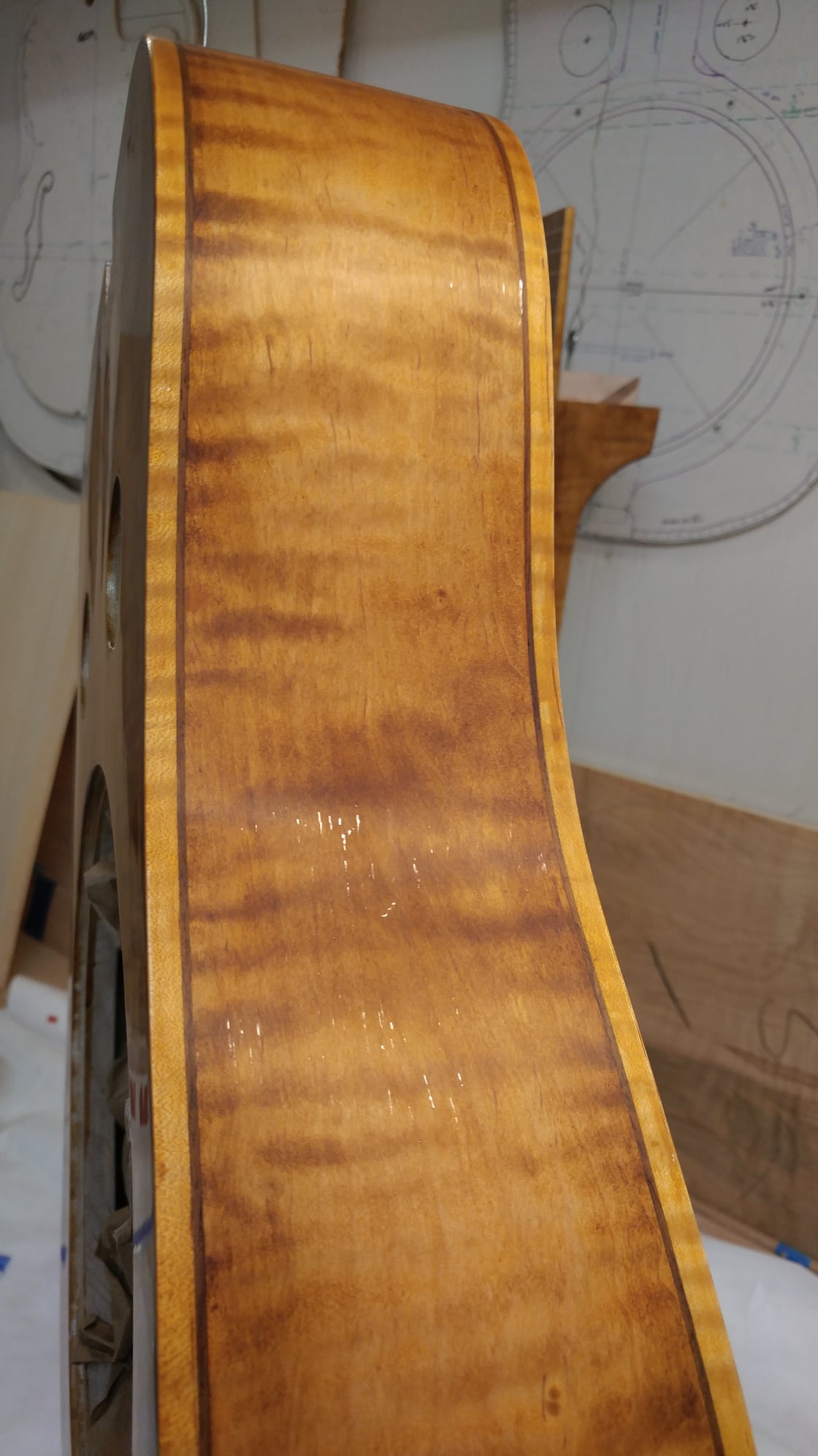

Re: Squareneck Resonator - Detailed Build Notes
Several hours of sanding completed. Wet with distilled water, wait overnight to dry, sand to 220, look for flaws and repeat two more times! Taped to expose the binding, then dyed with Honey Amber, sanded and dyed again.
Dyed with Vintage Maple, then sanded back when dry to help accent the curly figure.
Two coats of finish on the binding to seal the dye.
Taped off the binding to protect it from the dye on the main body and neck.Dyed with Vintage Maple, then sanded back when dry to help accent the curly figure.

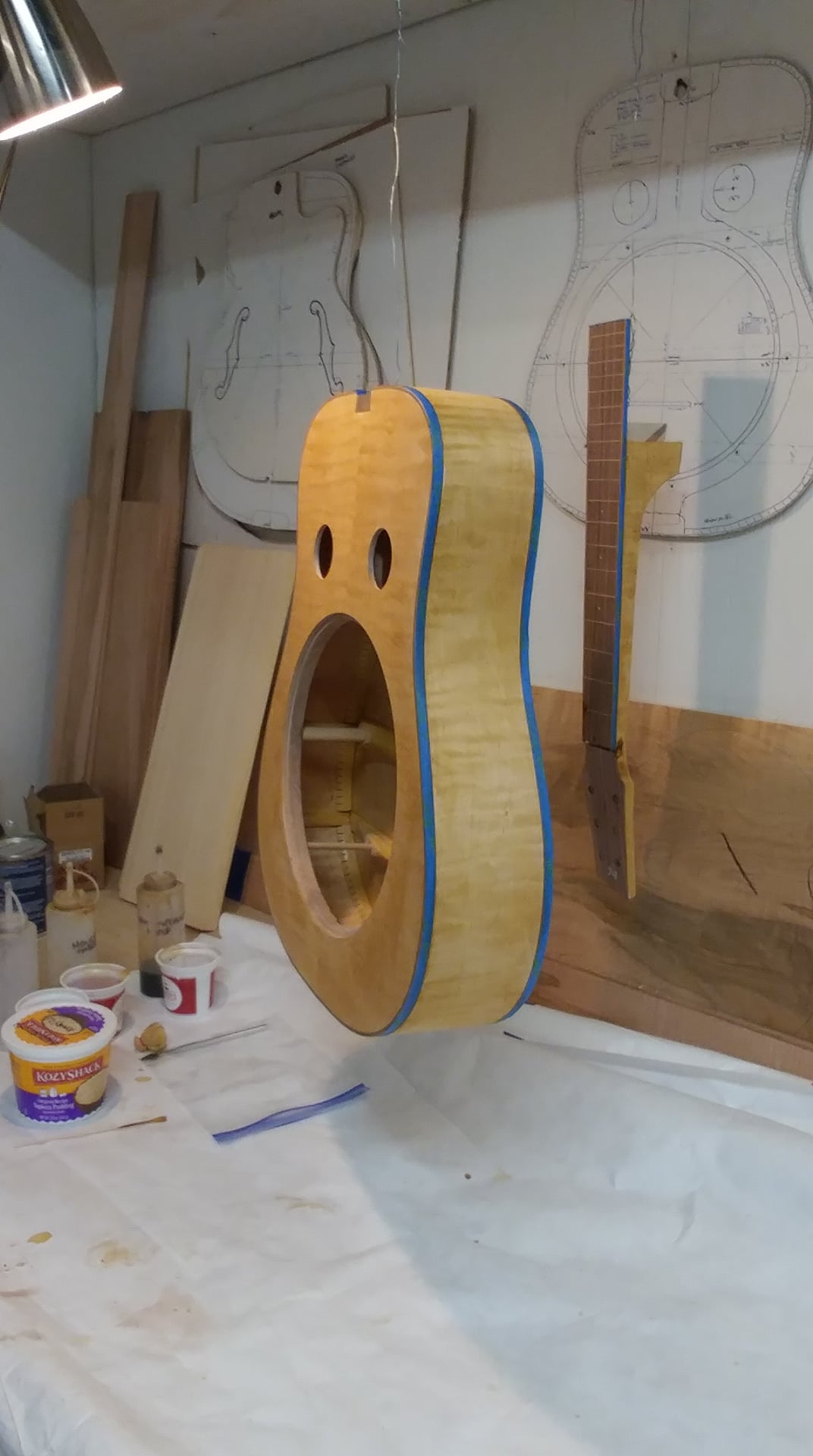

Here is the sunburst dye before blending with alcohol.
All using TransTint dyes in alcohol: Honey Amber for the entire body, then Vintage Maple from edges, followed with Medium Brown for the edges and waist areas.
I have really limited experience with sunburst finishes like this. It's a challenge to have everything flow and blend evenly, and have to guess what it will look like after the varnish is applied. The goal is to get the curl in the maple to "pop".

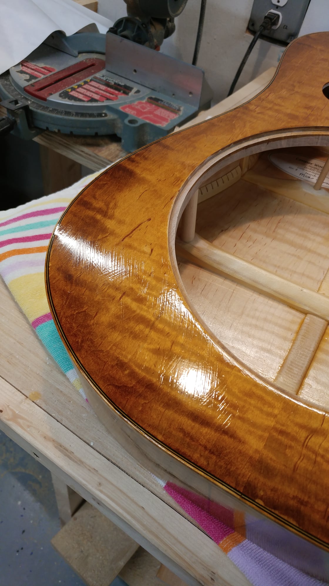

The finish is General Finishes EnduroVar waterborne urethane varnish, applied with a foam brush. We have a HVLP sprayer but have not taken the time and effort to figure out how to spray this finish.
The schedule was:
1) 3 coats, wait 1 hour between.
2) Dry overnight, then dry sand with 400 grit. The finish does raise the grain some so it feels rough before sanding. The finish sands to a non-tacky fine powder and easy to vacuum off the dust.
3) Repeat with 3 coats an hour apart, dry overnight and 400g sand again.
4) 3 more coats, as thin as possible with even coverage.
5) The finish needs to hang and cure for 5 days... The brush marks are obvious in reflected lighting, but not to worry...

After 5 days curing, the finish can be level sanded with 320, 400 and 600 grit dry, then wet sanded with 1200 and 2000 grit. The goal is to create a level and smooth satin finish.
Then it hangs another 5 days to cure some more. (So hard to wait!)-

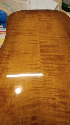

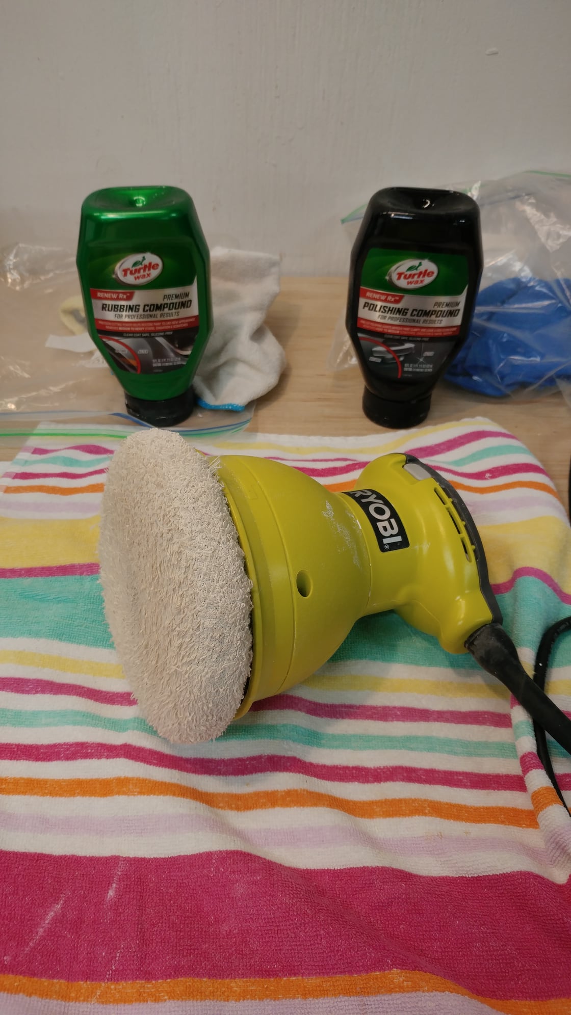

Five days later...
We use automotive rubbing and polishing compounds with a 6" buffer to "finish the finish" A few hours work and:

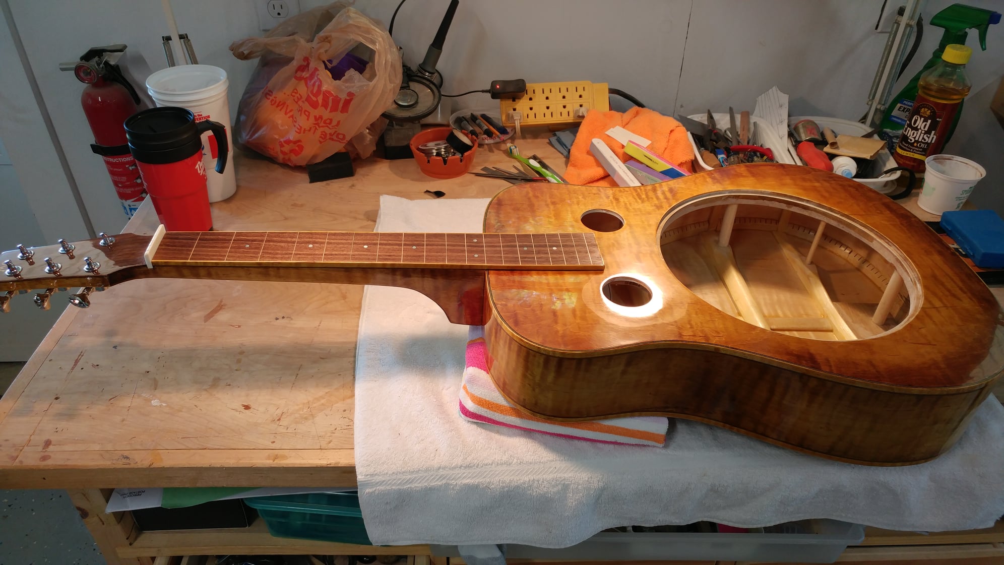

Carved and installed the bone nut and slotted for the strings (0.325" string spacing). Installed the Gotoh 510 tuning machines - these are really good machines!
Neck meets the body again! Two screws with bellville washers are installed through the neck block from the inside of the body to lock the neck in.
The walnut fretboard gets 3 coats of Formby's Furniture Restorer oil. The Beard Shockwave saddles (Hard maple capped with Ebony) to the spider bridge, Bevel the front edge, then measure and notch for the strings (0.450" center-to-center string spacing.

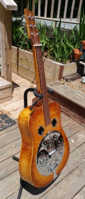

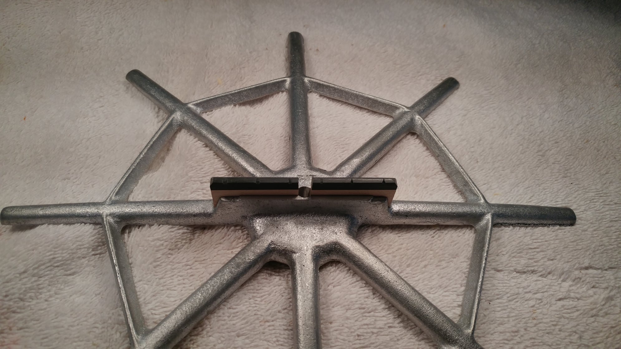

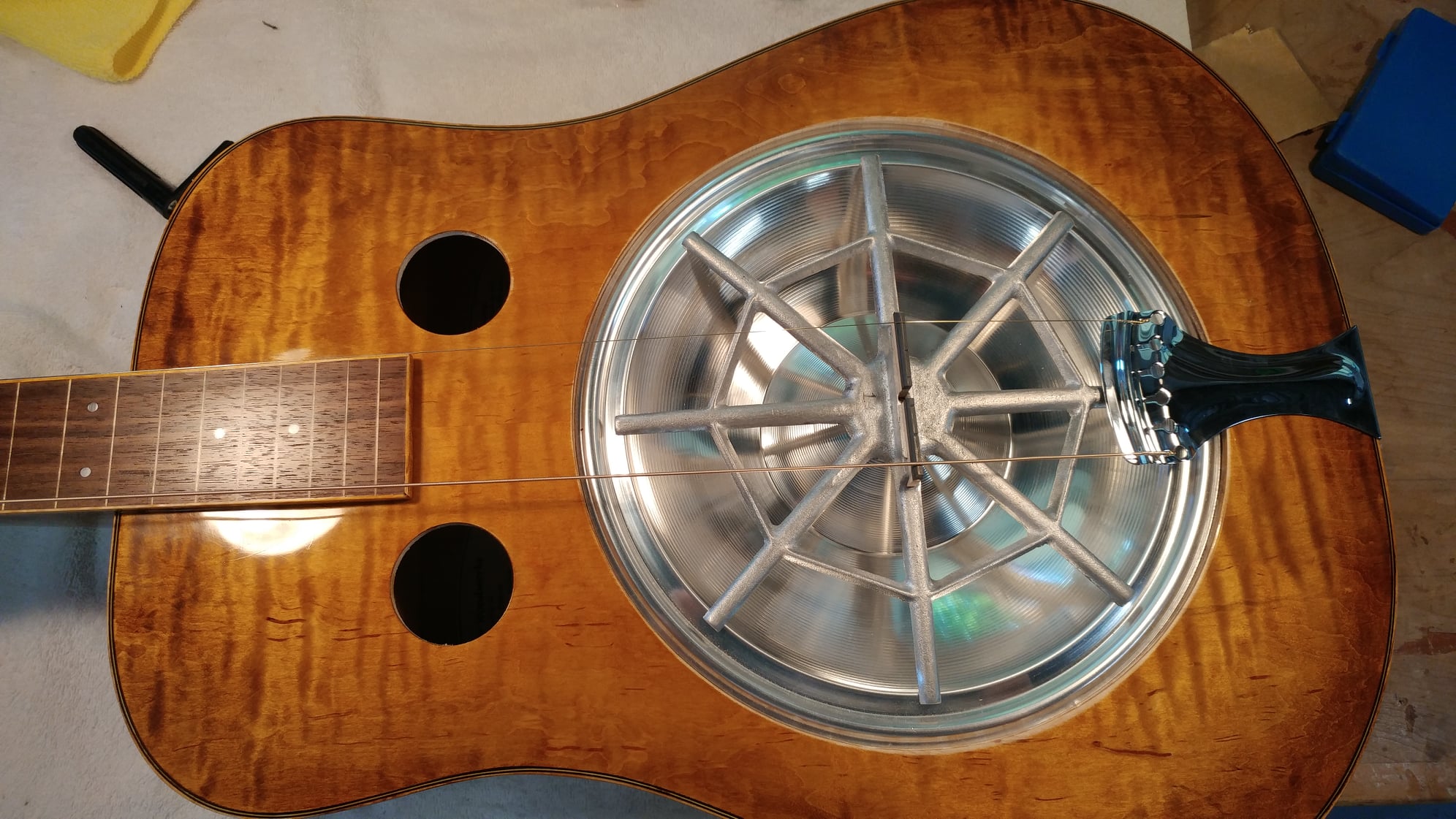

With the assembled cone and spider dropped in the ledge, the outer strings can be installed to check alignment and confirm the position of the tailpiece, then drill and screw on the tailpiece using a strap lock button. (Landed right where it was supposed to - what a relief!)
- Check and tweak the string notches at the nut and bridge.
- Install the coverplate with screws.
- Install the sound rings.
And... It's a dobro! Tuned up to pitch and it didn't fold in two!
Here's a picture out in the sun. It's staying reasonably in tune considering it was just assembled. Sounds really good, not as bright as I would have expected given the solid maple construction. The intonation is excellent. Pretty loud also, and I already think it sounds better than my other dobros (My bride thinks so too).
I'll try for some "glamor" photos and post later, but I'm not much of a photographer.
