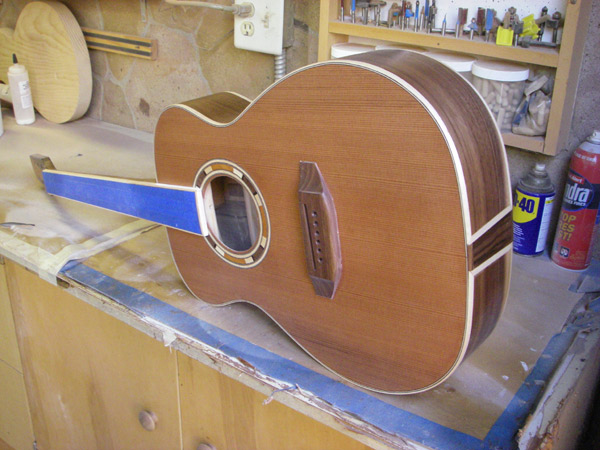

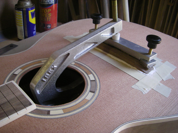

I had a rare three day weekend this week, and got quite a lot done. Here I glued on the bridge. I have seen that most everybody glues on the bridge after they have finished the guitar. All the books I have read do it this way, but I like to glue the bridge on to the soundboard before finishing, then mask the bridge. On this build I will not mask the bridge, because I think the waknut could use the lacquer finish.

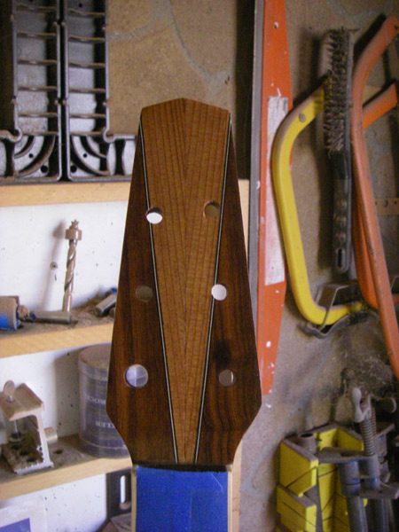

Big mistake! Very frustrating! I was very careful to measure the positions for the tuners, but not carefull enough. As you see I drilled the hole for the top tuner 1/8" short of the matching tuner. What's that they say "measure twice, cut once". I was always going to keep this guitar for myself, so I am going to leave it as is to remind me to be more carfull.

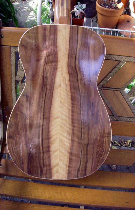

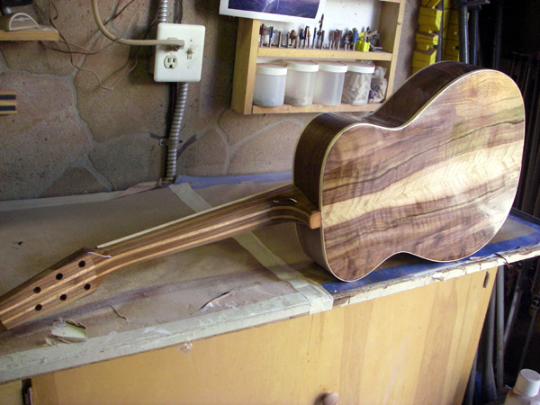

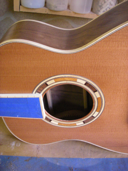

After sanding with 120, 220, 320, and 500 grit sandpaper, I sprayed on four coats of Mohawk vinyl sealer lacquer. This really brought out the colors of the wood. The redwood deepened and the walnut darkened. These pictures do not show it, but this guitar came to life with the lacquer. I can't wait to put on the gloss coats. Here are a few pictures of the guitar with the vinyl sealer.

Another shot of the back.

And a third picture of the back.

Here is a shot of the redwood soundboard.

And a close up of the soundboard.

After giving it some thought, I have changed my mind about leaving the holes in the peghead as they are. It would bother me forever, and I have a fix in mind. The holes I drilled have two thickness. The hole from the back of the peghead is 3/8", and the hole from the face is 1/4". I am goling to plug the back, and face holes with dowel, and re-drill the holes. I will drill the high one 1/16" lower, and the low one 1/16" higher. The dowel will act as a shim, and support the tuners. The washer will cover the shims, so they should look fine. We will see.

Looks great! I think the bridge looks a bit big.

Love the back. I agree the bridge looks a bit chunky

Thanks for the coments. Mark and Steven, the bridge looks much bigger in the picture than it is (the picture is keystoning quite a bit). If you check my early posts of making the bridge, there is a picture of it next to a standard Martin style bridge. I made my bridge about 1/8" wider and 3/8" deeper because I was concerned about using walnut for the bridge, and wanted to get a better footprint on the redwood. I was concerned about the bridge pulling off the redwood. Looking at the guitar from a straight angle, I think the bridge LOOKS OK. I am not sure about how much this will affect the sound? The guitar has a nice deep resonate sound when I tap it, so I hope I haven't made it too big? We will see. Thanks for the positive comments about the walnut back. About a year and a half ago my local hardwood dealer had a special purchase sale on walnut ($6.99 per board ft.). I looked through about 70 boards, and found three that were quarter sawn, and bought those. The back and sides of this guitar and the drop top on the Les Paul I am building for this challenge, were cut from one of those pieces. I still have enough from this board to make another back. I got very lucky finding this wood. I check out the local hardwood dealers in my area all the time ( I have become a woodaholic).

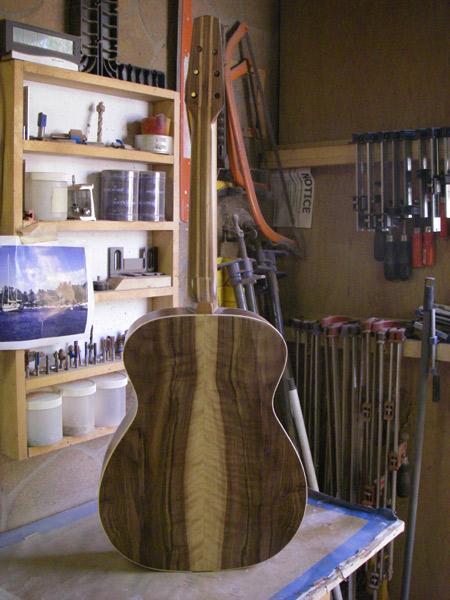

I pluged and re-drilled the peghead, to fix my mistake. I moved one down 1/16", and one up 1/16", and they match up much better.

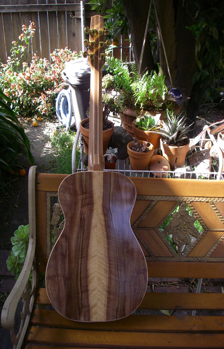

Here is a shot of the back. I wish I could take credit for the beautiful grain in the walnut, but some tree did that all by itself.

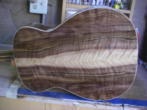

Here is a shot of the full back.
