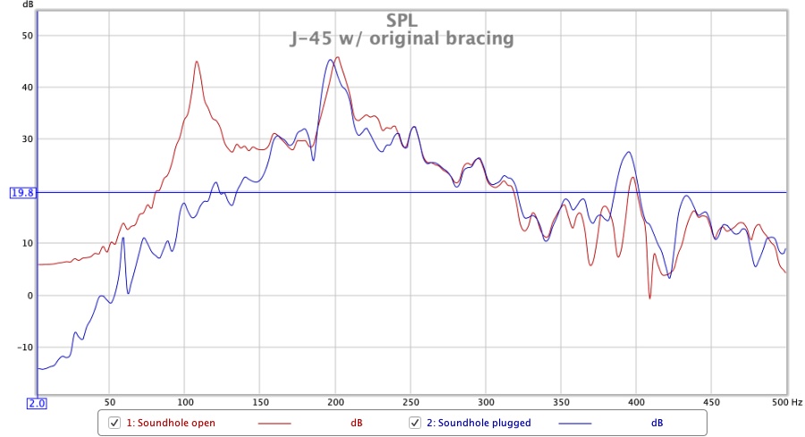

Also, here is a frequency spectrum of the guitar with the original bracing. The neck and bridge have been removed. I am no expert on interpretation of these graphs, but the blue line shows the guitar with the soundhole plugged with a foam insert which cancels out the body resonance (110 Hz) and the contribution of the back. The gap between the red and blue line around 230 to 240 Hz is the back's interplay with the top.
I am using a free software program called Room EQ Wizard and a USB microphone to make this plot.

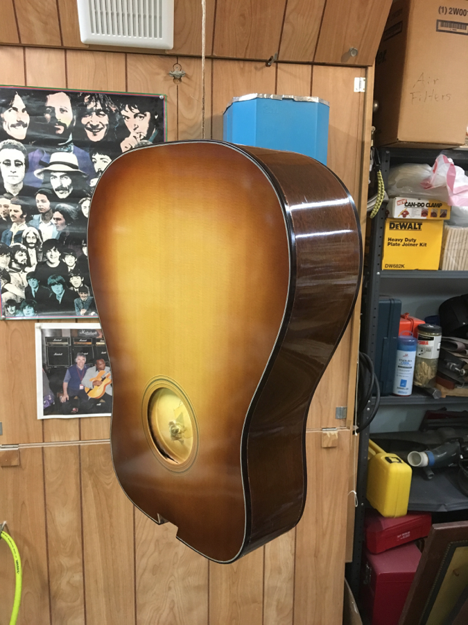

Well, fast forward a few weeks and this is where I am at: new top; binding replaced; finish on top and binding sprayed and curing.
One new shop addition is the bathroom exhaust fan installed near the top of my spray booth. I let it run full time to remove the off-gassing lacquer fumes during curing to keep them from getting into my house. It seems to be working well.

Re: Repair of 1975 Gibson J-45
That is looking really nice Barry.

Post by Mario Kessels »
Great repair. Nice to see the use of the copper sticks, I always dislike the use of my SM steam needle ans was wondering if it would be worth changing to this kind of operation.
Great craftsmanship

Post by Gordon Bellerose »
Even though I didn't get to see pics of the top removal, I have enjoyed this thread immensely.
Nice job on the burst! Better than new.

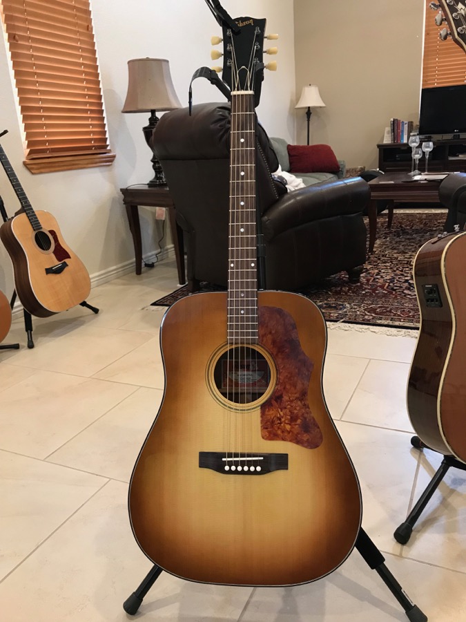

Just to tie up this thread, here is the completed project. Turned out good and the client was very happy. It certainly turned out to be a massive project, but the wall hanger can now be played.

Post by Bob Gramann »
That’s a beautiful job!

Were you able to hear a difference in the sound of this guitar, with all the changes in bracing you did?
Posts: 2635
Thanks guys. The final guitar sounded very good. Unfortunately I was not able to hear the guitar when it came in for repair because the neck was so twisted that it was completely unplayable. The bass strings were about 1/2" above the frets. I can't imagine that it's tone was very good though due to the really heavy bracing and the big honking bridge plate. My new top with the light scalloped bracing probably was half the weight of the Norlin one. I did not get a chance to do a frequency chart on the new top, darn.
