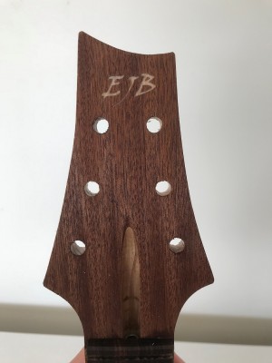

I just did a headstock inlay with some casting epoxy resin filled with blue tint and glow powder. Cut the inlay on the CNC with a .020" pcb end mill

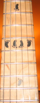

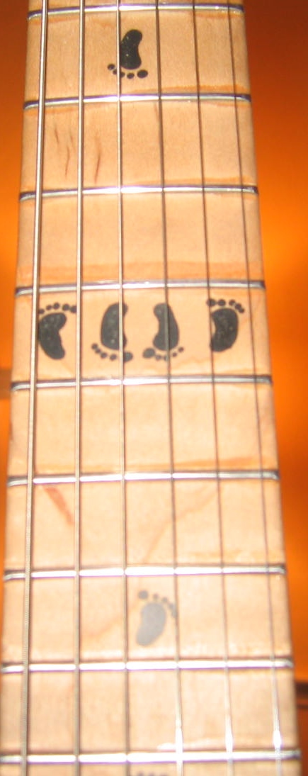

This is an inlay process that I do on guitars I build for myself. Its nothing more than depressions carved in the wood and back filled with black CA or colored epoxy. I've got three different sized thin brass templates and the toes are done freehand.

Do you use the templates strictly for marking or as a cutting guide? Do you ever observe any wear on the epoxy fill? Not sure of its wear characteristics vs. wood.

Of course the maple necks have a lacquer finish but even on rosewood, using white epoxy, there hasn't been any problem with wear at all. I've never done anything large. My templates are only used to draw the desired pattern in pencil and the footprints lend themselves to allowing deviation as wet footprints on pavement generally aren't consistent either. I'm just using a handheld rotary tool with the standard Dremel engraver bits from the hardware store - low tech.
