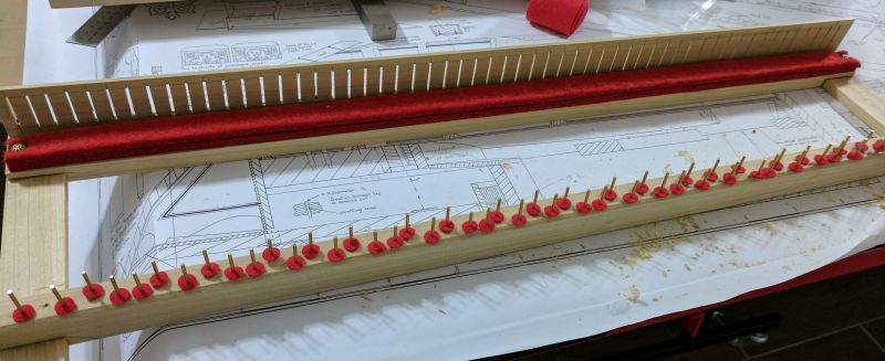

Here the rack is in place (not glued yet) and I've installed the balance pins and put a small felt bushing on each pin. More felt is on the back "touch" rail. I think it serves two purposes- to adjust the touch/travel of the key and to provide a soft (quiet) landing site when the key is released. Next is to cut the keys apart!

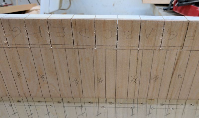

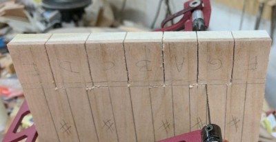

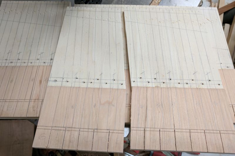

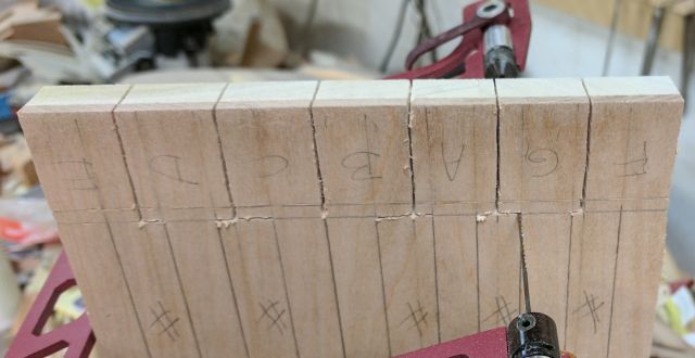

On to the keys. Mr. Barnes recommends a saw that makes a 1 mm kerf for cutting the key fronts and the back/tail ends can be cut with a bandsaw. The fretting saws that I have weren't quite deep enough to let me get to the corners. A small douzuki saw might have done the trick. So I went with a coping saw that cut a sub-mm kerf.
Here you can see the initial straight cuts.
Between the B and C and E and F keys, there are no sharp corners so you can cut straight through to split the keyboard into 5-6 sections that make it a little easier to work on.

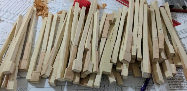

I used a coping saw again to cut the right angles.
And all finally cut. They need some cleaning up and the cherry tops need to be popped off of the sharps and replaced with the final sharps (which still need to be made). Then slots and guides need to be cut and the holes need to be opened up, so still a good amount of work to do...
