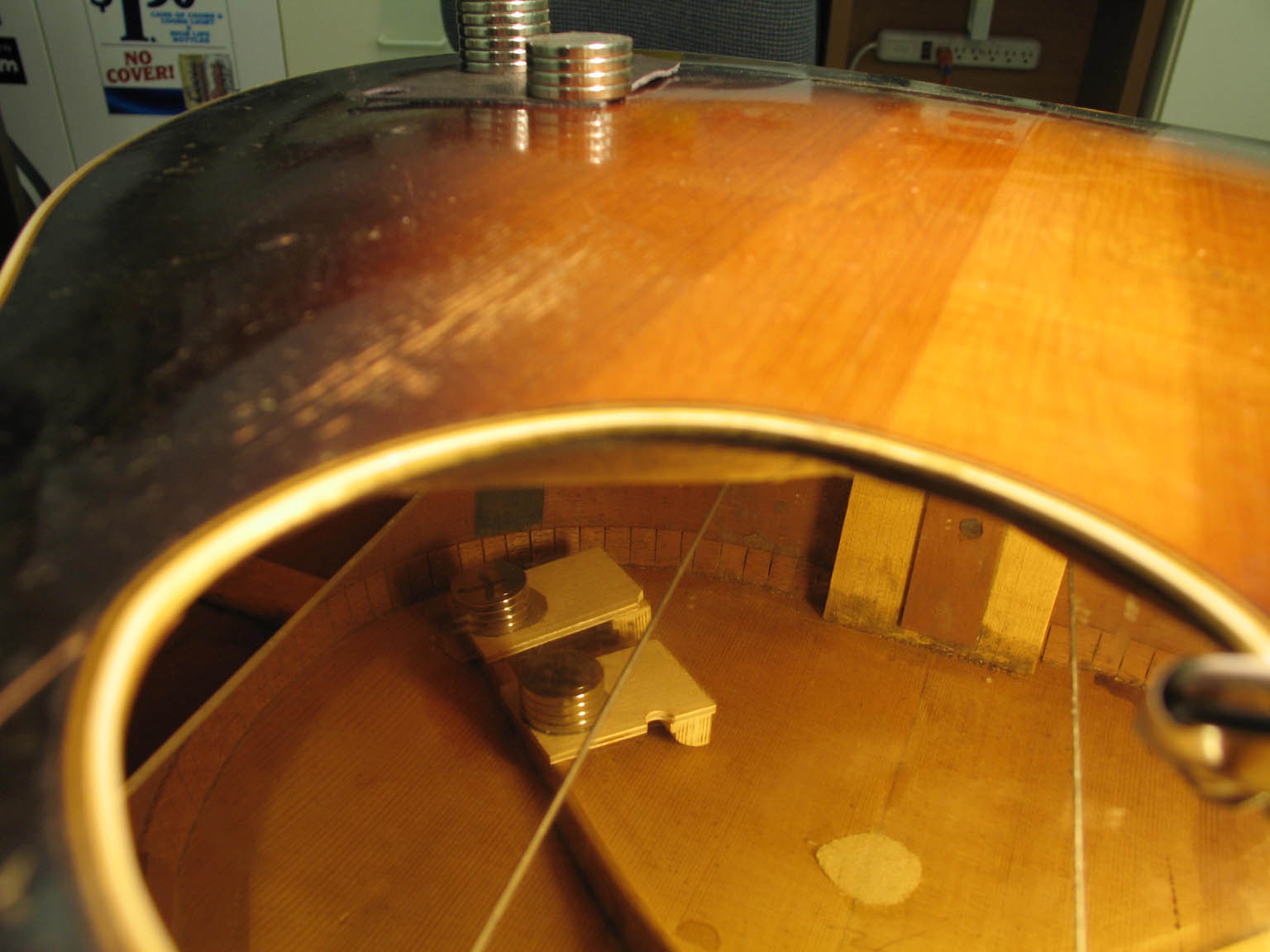

One of the very interesting features of T.J.'s system is the way the cleat fits into a matching groove on the inside caul. This keeps things from shifting around during assembly. Your veneer cleats, or my double veneer cleats, could be set inside a rectangular groove in some kind of flexible caul. A piece of extra wide plastic binding strip could be laid up with a couple of smaller strips to make a rectangular groove to lay the veneer into. Double stick square magnets on top and Bob's your uncle. T.J.'s magnets are 3/4" square and have a pull of about 20 pounds each. I will have to build a prototype now.
One other observation of T.J.'s kit is that the square magnets act like one big magnet. So when you are using the two cauls, the magnets not only pull the two parts into alignment sideways, but also long ways. It is very interesting and necessary when you are trying to line things up on either side of the guitar. You can't see where the caul is supposed to go when you are working with your arm in the guitar, so this 2-way magnetic alignment effect comes in very handy. I don't think you would get this effect with round magnets, or at least it wouldn't be as strong.

I got ambitious and did two cauls at once on a crack that spanned a brace. Three down and one to go.

I played around with the flexible caul idea we talked about. I used some round neodymium magnets I had on hand. I placed them in square corian holders and glued those to a strip of cloth. The first set I left square, but then the light bulb came on (briefly) and I thought I better make the other set have angled sides so they can be "bent". I'm thinking two pieces of low tack tape could be glued together to hold the veneer to the magnetic strip, and could be peeled off after the glue has cured.

How much clamping pressure did you get? T.J.'s cauls are so strong you feel like you cannot pull them directly apart. You have to twist the outside caul to get it to come free.

The magnets did provide a good amount of clamping pressure for clamping the veneer cleat. I'm sure it would vary depending on how far apart the magnets were kept by the thickness of the sides. As a first iteration I am happy with it and I think it will work for most situations. I do see room for improvement. Using the larger disc magnets available and gluing directly to the bias tape might be less trouble to fabricate and provide even more clamping pressure. But I used what I had (I tend to collect junk, so when I can find a use for it, or "re-gift" it to someone who has a use for it, that makes me happy).
The strips do pull themselves into alignment, as you mentioned the plexi cauls do, however placing the second caul in close proximity I think will still be necessary because once some of the magnets make contact it seemed difficult to slide them. Using less strong magnets or having glue on the cleat material (to lubricate the surface) may make positioning them easier. Have you found that glue helps the cauls slide easier? I left the cloth tape a little long on the ends. I can grab it and peel it away from the side if I need to reposition the cleat/caul.

Glue on the cleat helps a little bit to slide the cleat into position. Sounds like you have a good setup. I used HHG on the three cracks I am dealing with and the rapid positioning and no need for clamps made this possible.
