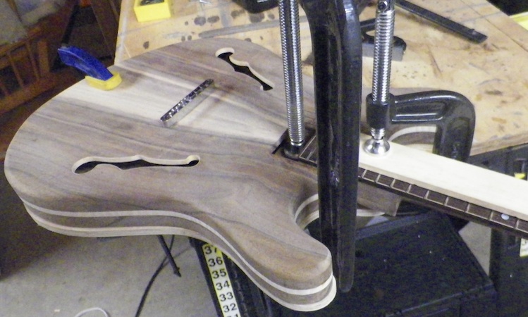

Do you have any photos of how you attached the neck? I really love that neck joint.
Chad McCormack
Posts: 89
Joined: Fri Mar 02, 2012 4:02 pm
Location: Berwick, Maine
Re: Chad McCormack's "Equator" Semi-Hollow
Post by Chad McCormack »
Thanks Art. I don't really have any good photos of the heel block prior to setting the neck, but here's what I do have:

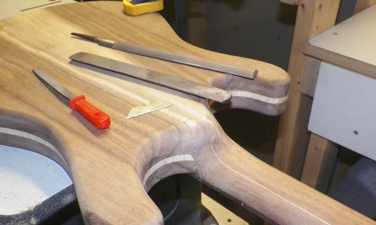

You can see the heel block right under the 16th fret. Once the neck is glued and set, it's just a matter of rasp/file/scrape/sand until it looks and feels like what I want:
Art Davila
Posts: 292
Location: Chicago, Il U.S.A.
Post by Art Davila »
Wow that was serious chuck of wood to rasp and file.
Did you use any power tools to get it close and then use hand tools, or was it just hard work and dedication.
Cause I gotta be honest, I tend not to be all that great at using a wood rasp and file.
(experience limited to shop class back in 1979 do not remember ever getting good at that.)
I have done all and claw feet on furniture with a flex shaft and motor but I have such limited experience with the hand tools.
I guess the best way for me to learn this stuff,
is to find the cheapest scrap wood near the same hardness and make some woodchips making neck heels till I feel that I could have a go at the more expensive woods.
Posts: 3243
Be aware that not all rasps are equal. Having the right tools is 50% of the formula. The old 4-in-1 rasp that you find in most hardware stores is not the same as a Nicholson rasp or some of the other specialty brands that are now available.
