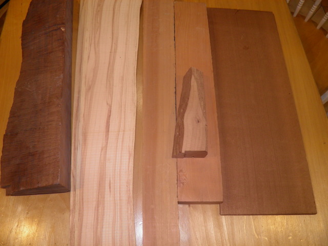

I debated on joining this challenge since I am 0 and 2 on completing the previous challenges on time, but since the theme of this challenge is right up my alley I couldnt resist. I plan on building a classical guitar. With the exception of the top and the fingerboard all of the woods used were salvaged by me, within a 30 mile radius.
back and sides: Carob (Ceratonia Siliqua)
top: red cedar cosmetically challenged $5.00
neck: douglas fir (recycled old growth)
linings: Monterey Cypress
bridge: Almond
Head and Bindings : claro walnut
Fingerboard: tbd
bracing: redwood fans and doug fir bars

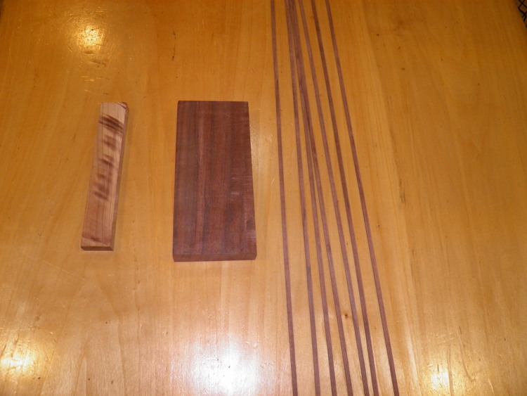

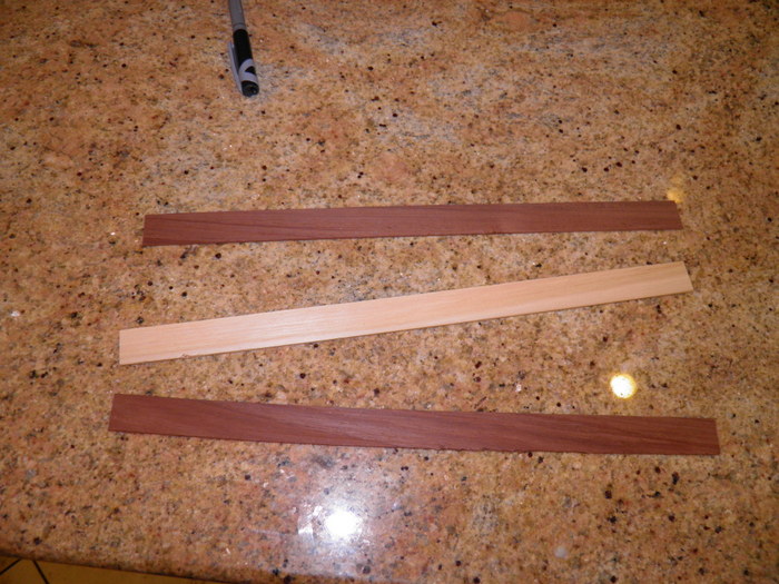

Postby Edmundo Azalde » Thu Apr 19, 2012 10:02 pm
Thanks Jim
I always assume that I am doing something wrong. You never know with software.
I managed to mill some of my wood. I made the head and bridge and also ripped some bindings.

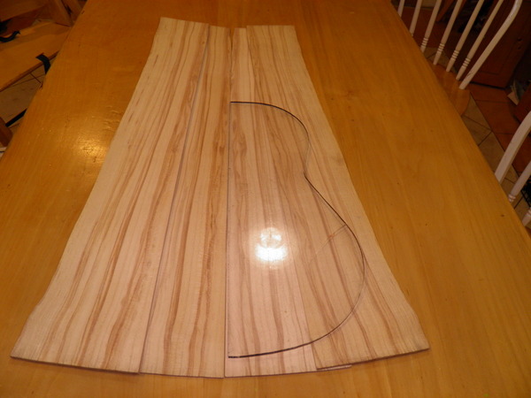

Postby Edmundo Azalde » Thu Apr 19, 2012 10:13 pm
The Carob tree that I got the wood from was cut down by my neighbor across the street about six years ago. It was growing in the strip between the sidewalk and the road. It was small 12" in diameter at the most, which dictates that my back will be 4 pieces. I wanted to make the inner two pieces narrower than the outer two but as can be seen by the template I barely make it with equally sized wedges.

Postby Edmundo Azalde » Thu Apr 19, 2012 10:22 pm
I jointed and glued the inner pieces first. I inserted a walnut spacer between the joints. I repeated the process for the outer two pieces.

Postby Edmundo Azalde » Thu Apr 19, 2012 10:24 pm
Here is the completed back plate after cutting and cleaning up.

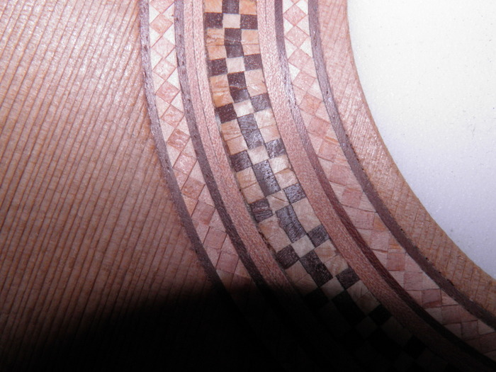

Postby Edmundo Azalde » Thu May 03, 2012 3:14 am
I made the inner mosaic ring out of Claro walnut and Monterey cypress. and inlaid them on the soundboard
Edmundo Azalde
Posts: 12
Joined: Sun Apr 15, 2012 11:44 pm
Location: San Jose,CA
Re: $100 Local Materials Challenge: classical guitar-Edmundo Azalde
Postby Edmundo Azalde » Thu May 03, 2012 3:26 am

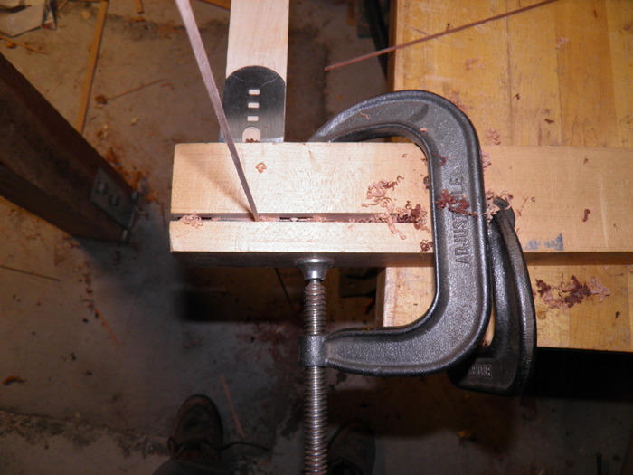

The inner/outer ring is a diamond mosaic of Redwood and Douglas fir. The lines are Claro Walnut and Madrone. I sawed my veneers and then thicknessed them by pull scraping them. I like how you can thickness the veneers quite accurately with this crude tool.
pull scraping
Edmundo Azalde

Postby Layne Campbell » Fri May 18, 2012 10:07 am
I have never heard of thickness scraping, how does that work?
