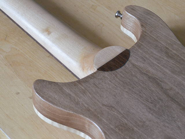

- Beate Ritzert
- Posts: 607
- Location: Germany
Re: Cutting fret slots failed. And now?
Well, the same neck: a nasty mistake while fitting it - the neck pocket was so tight that i did not fully see that misfit because the neck never was correctly in the pocket
The gap appeared to be a lot narrower as you can see from the slice of maple it dit already fit into the slot. And i should possibly not work at 3 o'clock in the night... And i needed to deepen the neck pocket a bit after sanding the body.
Anyway: the opposite side seems mostly "ok" although not "perfect".
Well, as a repair i am considering filling all three sides with a narrow stripe of rosewood. Intentionally make a contrast. Or would You use maple or walnut for that?
- Posts: 106
Use ebony to match fingerboard.
- Posts: 106
Oops....fingerboard is rosewood.
- Posts: 1182
i agree - use a dark wood to make the contrast - you can see how it would look in your photo where the shadow is acting as a dark line
- Beate Ritzert
- Posts: 607
- Location: Germany
What do you think of the following idea to hide the gap frm the back (where it is widest)?
Regarding the gaps on the sides. These are much more narrow. I am considering to do a very narrow inlay of, say 1.1-1.25 mm (< 1/20 in), but i am completely unsure on the best way to cut such a slot. The cutaway would enforce a cutting angle of about 45° if i used a large chisel. And my smallest chisel is 2 mm, so i need to buy something appropriate.
- Posts: 3243
I like the back inlay. Looks intentional instead of corrective. Very creative.
- Beate Ritzert
- Posts: 607
- Location: Germany
Thanks.
The main reason why i did not just do it is the questions on tools and procedure for the slots on the sides, which need to be done first, see
