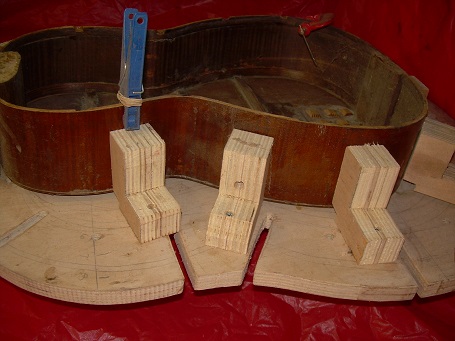

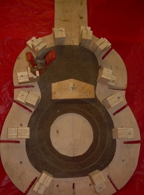

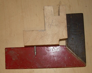

I sometimes use the solera method, but rather than make the plywood have the proper profile I add a built up cork and rubber composite layed on top of a flat plywood workboard. This allows me to change the arching according to the type of guitar I'm building. Originally I drilled holes and slots and used dowels and spool clamps positioned around the perimeter but later decided "L" blocks screwed directly in the plywood was easier and worked better. YMMV

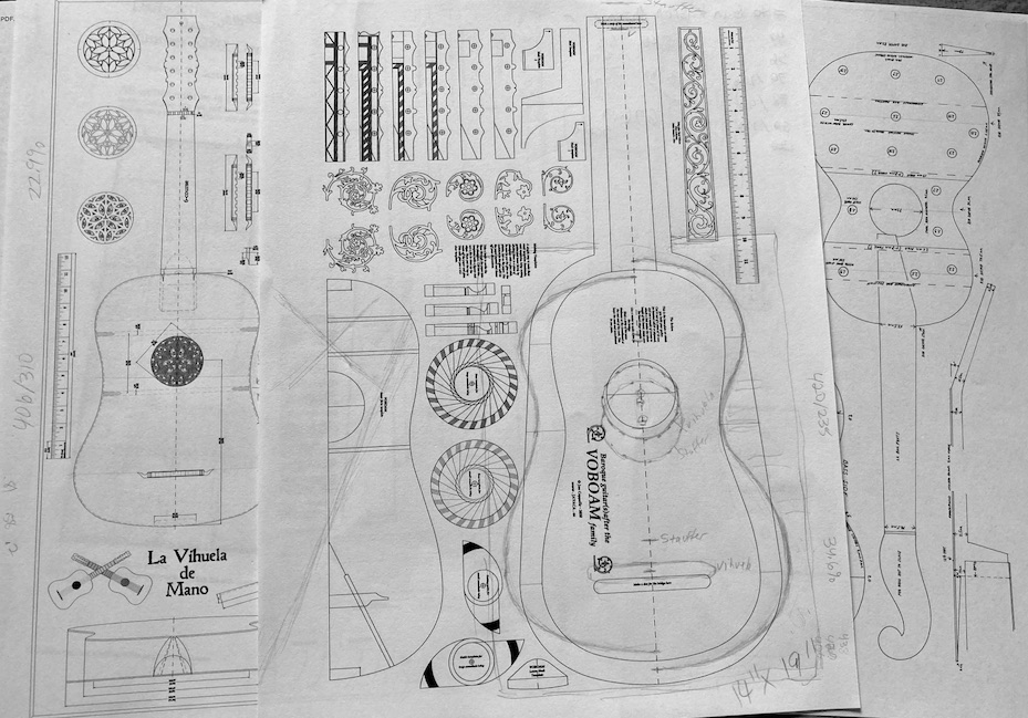

Clay, I like the idea altering the solara to use it for many different projects. I have 3 smaller guitars that I'd like to do, and others probably too. Two of them I'll probably do sort of like they were originally; though I might do the Voboam with a double X bracing, and not the transverse bars. It looked promising on the other I was doing, but I changed to 2 bars when the barn wood top split to pieces. The Stauffer I thought maybe using the oxidized copper plate that SnowManSnow showed on the other forum.
I like the over the top short, fat look of the vihuela, but MIGHT make it 21st century with a multi-scale, and twisted neck. I can see how both might make playing easier. Why not try it? I don't do much that is normal! If I did that, it would need a dedicated form of some kind. I might even do it with 13 strings, seven courses. Narrower spacing might be easier with the fan frets? I like the wider spacing I gave it, and the feel of the double strings on the Baroque. Short fat fingers, and the lighter tension per string.
Thanks for the idea
Ken
