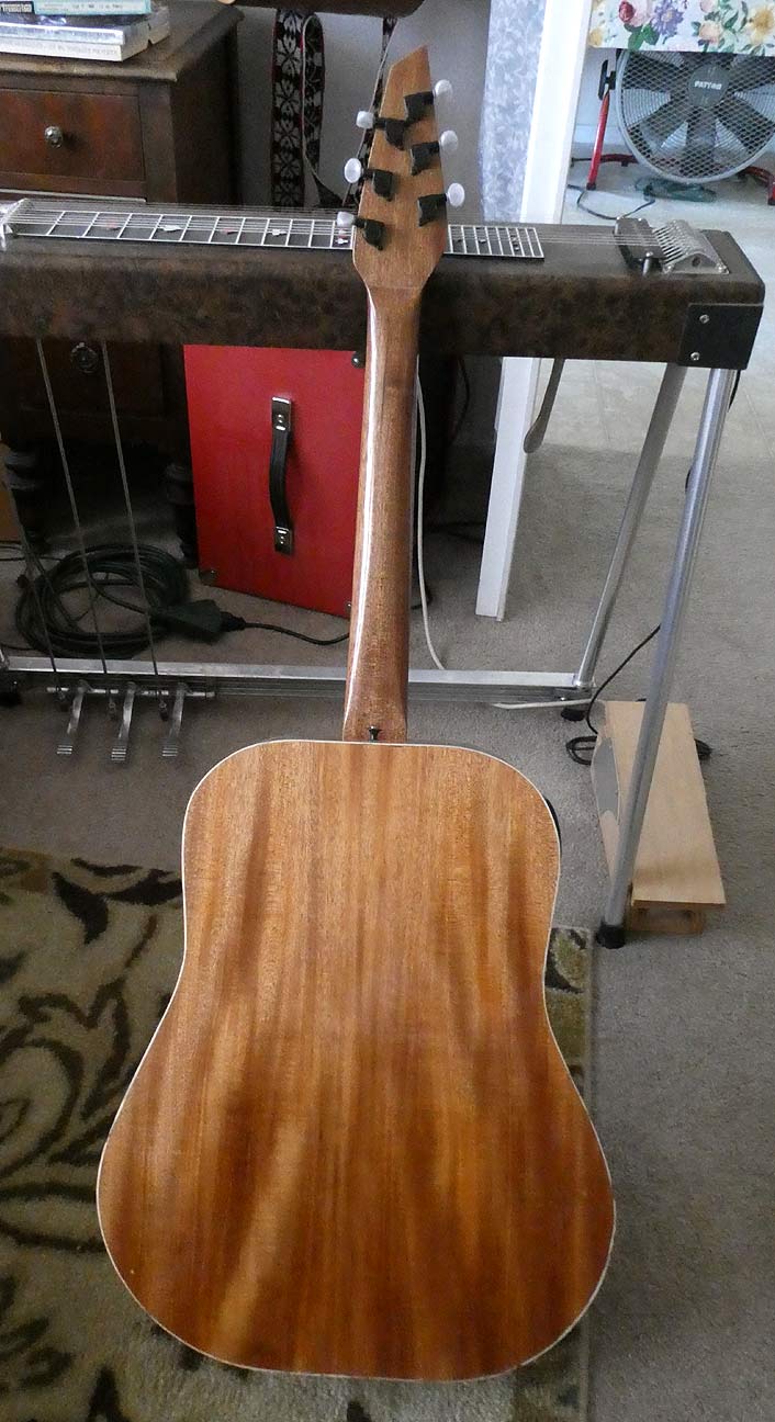

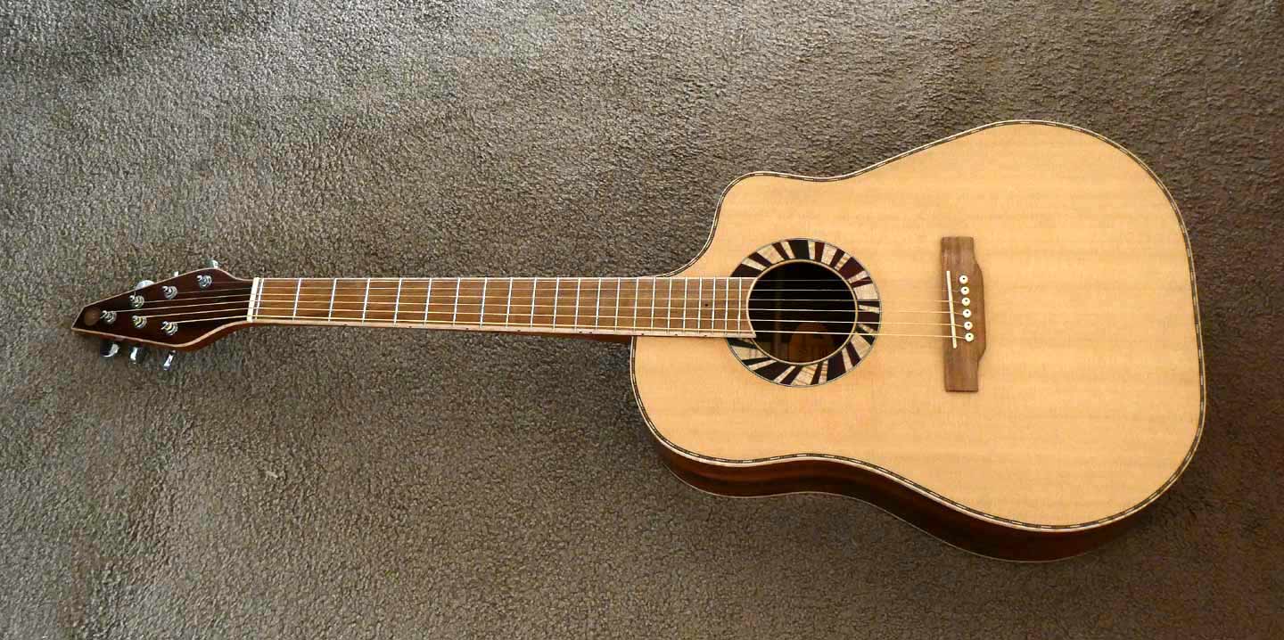

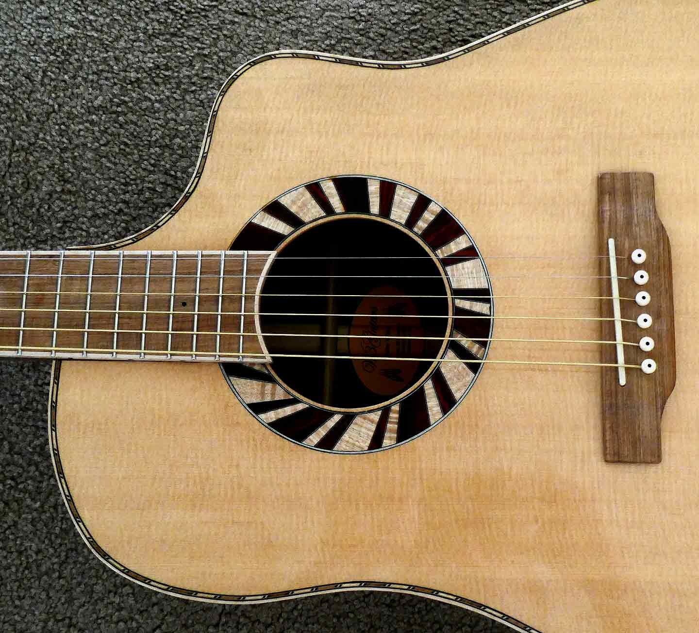

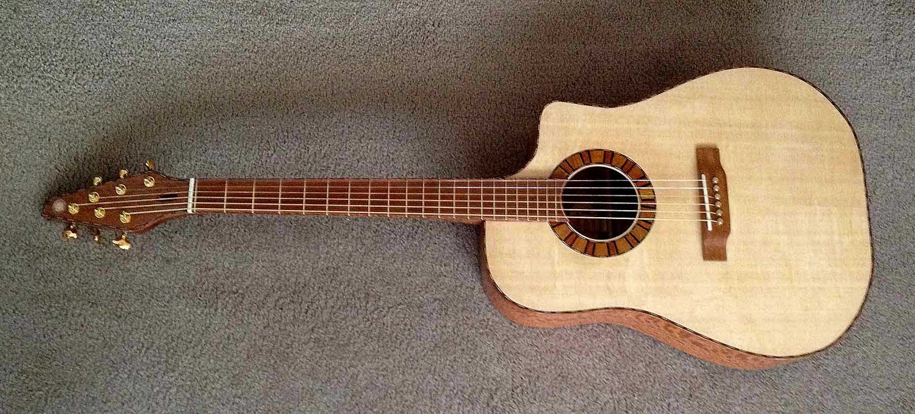

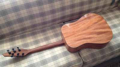

After several years, I thought I'd try my hand at an acoustic guitar again (besides resophonics.)
Back, sides and neck are mahogany, top and headstock veneer spruce, bridge osage orange, fret board Honduran rosewood. It differs significantly from the usual build in that it has a solid body type neck pocket and heel, a Smallman type adjustable neck (and an overly large head block to accommodate), double X bracing, flying buttresses, a zero fret and straight pull to tuners. The head stock inlay is a Mexican 5 peso coin.
It has some cosmetic defects, as do all my builds, but if I live long enough I may make a perfect guitar some day.

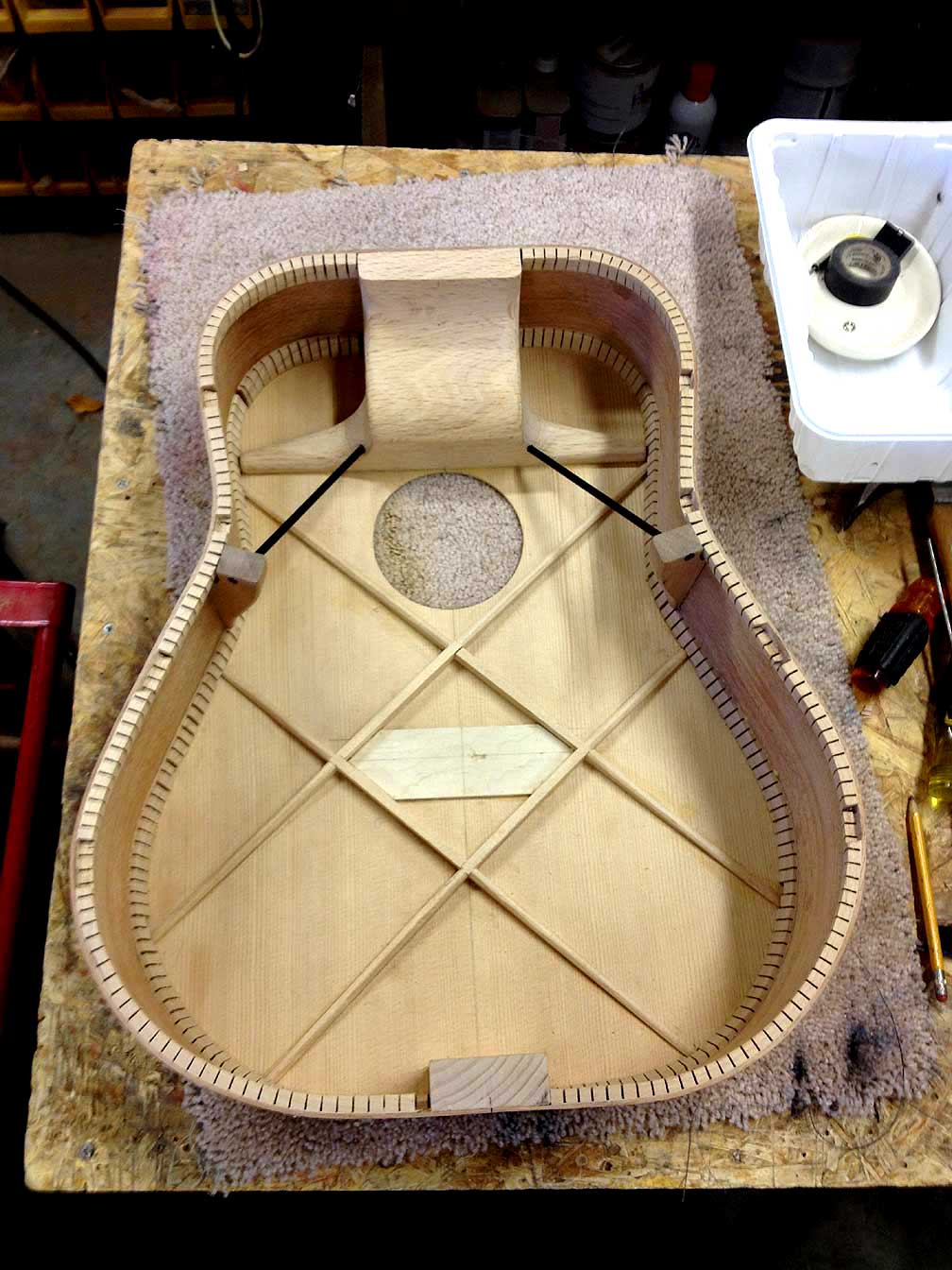

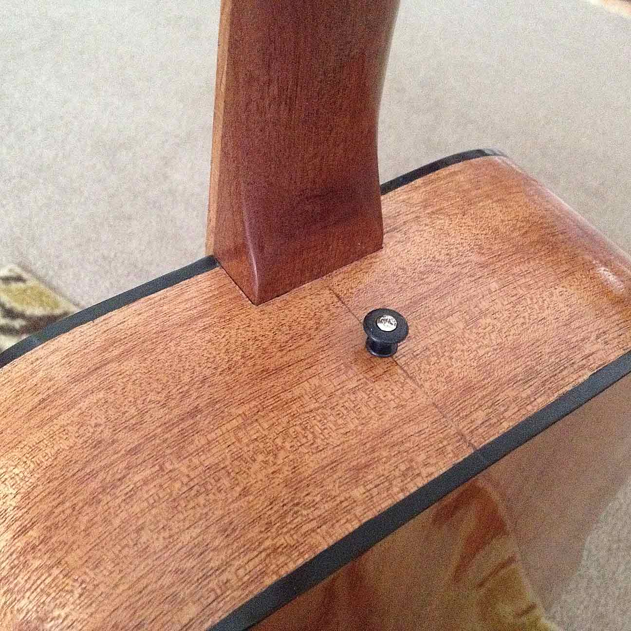

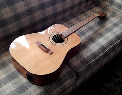

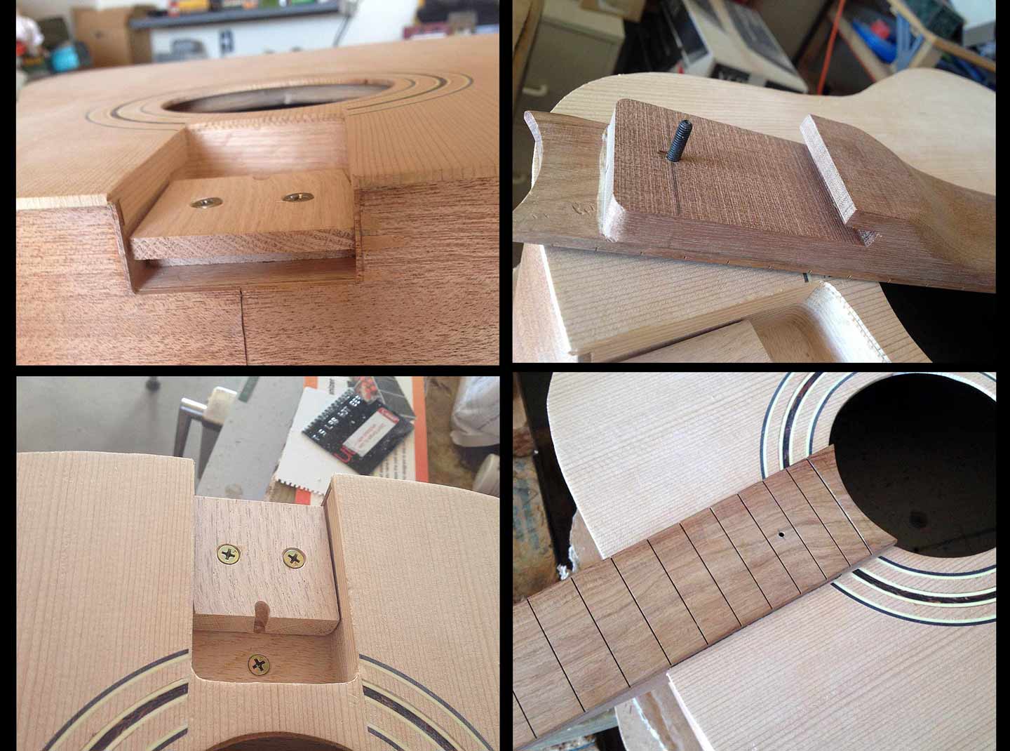

A few more pics.
Bracing.
Neck assembly. The Allen screw adjusts the neck angle, accessed through the hole in the fret board. The striker plate is the 3rd drywall screw. String tension holds the neck in place.
Bracing.

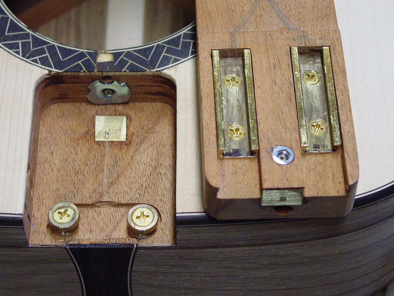

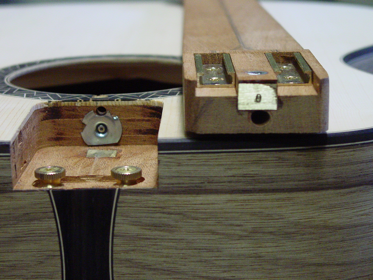

Nice neck adjust Peter. My initial attempt at this was similar to yours but for some reason I couldn't work out the hinge to my satisfaction. You make it look simple. In the end I found some brass hardware and accomplished the same thing in a different manner.
My only worry with the system is that in time the end of the neck may "ski ramp" but the three I've built ranging from 2 to 10 years old show no signs of deformation. I skipped the intonation adjustment after the first one as it became apparent that it was unnecessary.
I like that massive neck block coupled to the UTB. I've added that detail to my standard neck guitars also.
Here's a couple of pics of the original during the build. Action adjust is the same as yours and intonation I adjusts through the soundhole just below the trussrod.

Hi Steven. Your design looks like it is very stable due to the metal parts which I assume fit fairly tightly together. I think part of the reason mine works well is because of the tight fit laterally of the neck into the pocket. I have to force it in and it easily stays in position without any strings on. I could adjust the intonation a small amount by putting a shim in the groove in the neck, or by adjusting the position of the retaining block that is screwed into the pocket. I'll hope the neck doesn't ski ramp, though a small amount shouldn't cause any problems.
The neck block is made of oak, as it was the strongest wood I had available. However, it is heavy, and for future builds I will pare it down and use a lighter wood - maybe alder, since I have plenty of it. I like that it includes the UTB, but will also make that lighter since the CF buttresses should take a lot of the stress off the upper bout.
If you (or anyone) has any suggestions on how to improve this, please post.

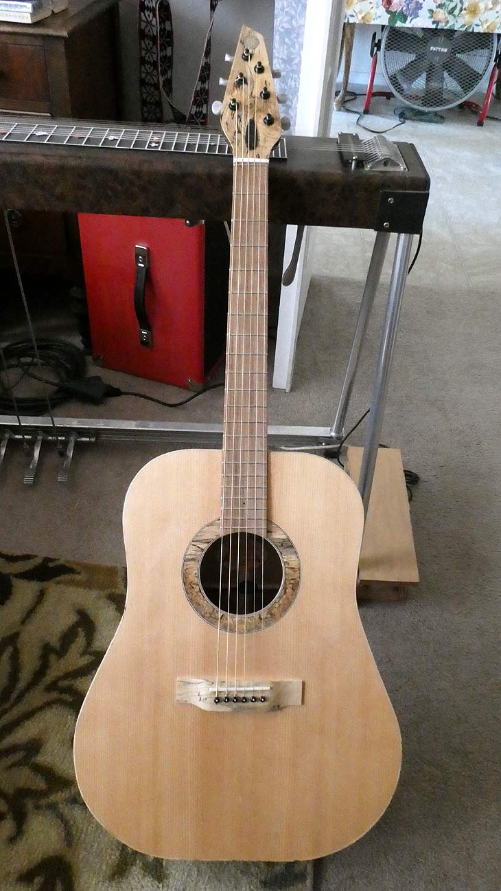

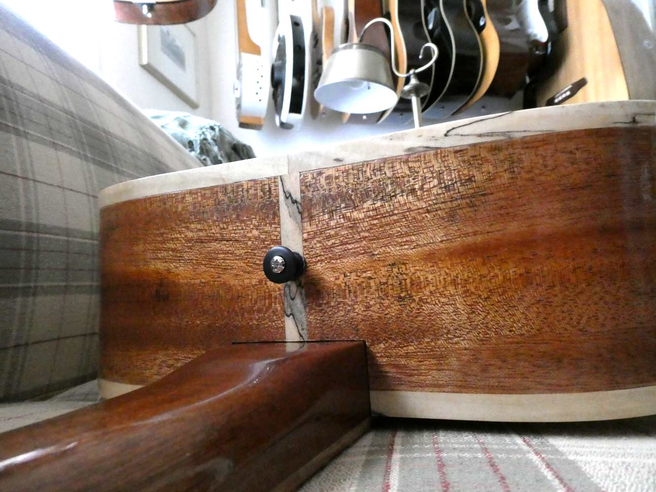

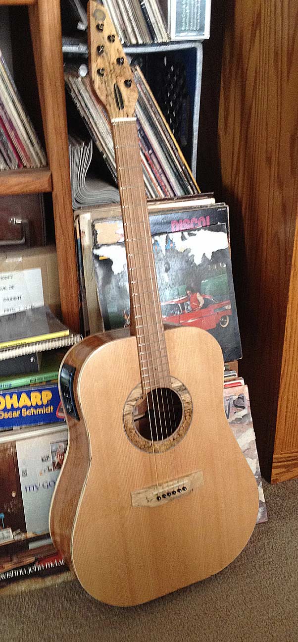

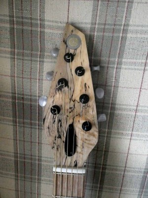

Finished another one of these: Mahogany neck, back and sides; spruce top; headstock, rosette, bridge, bindings spalted something (don't know what); Honduran rosewood fret board. I know bridges shouldn't be spalted, but this is a pretty solid piece of wood (time will tell.) Cheap UST and mic with preamp in the side (I know a lot of folks don't like this, but it was cheap and convenient) with blend, and sounds pretty good.
I love the adjustable neck - I can tune the action in perfectly to suit my playing style (light fingerpicking), and should never need a neck reset.

I really like the spalted whatever. It ties especially well between rosette and bridge.

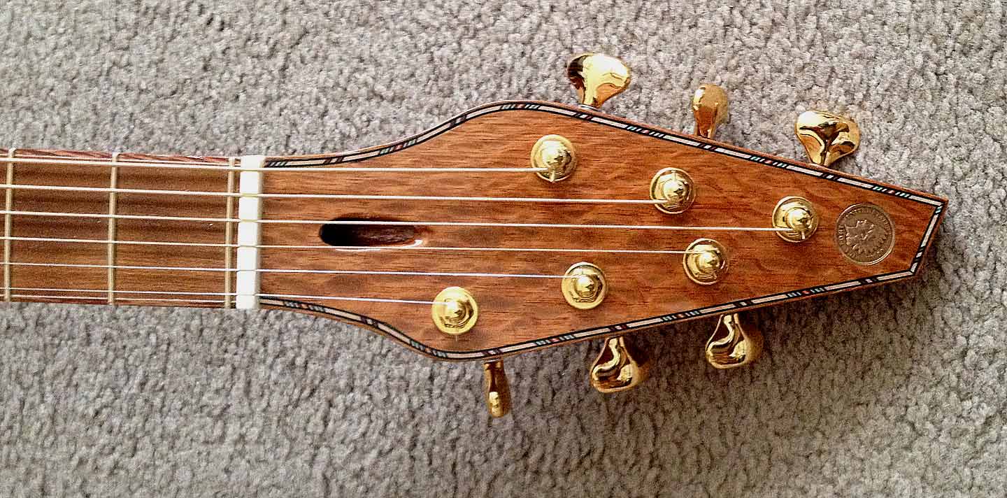

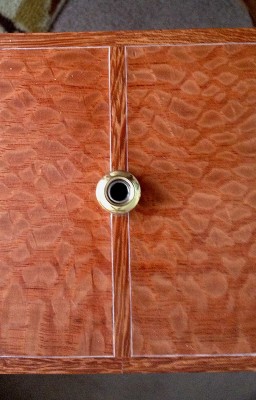

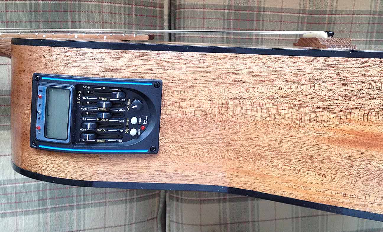

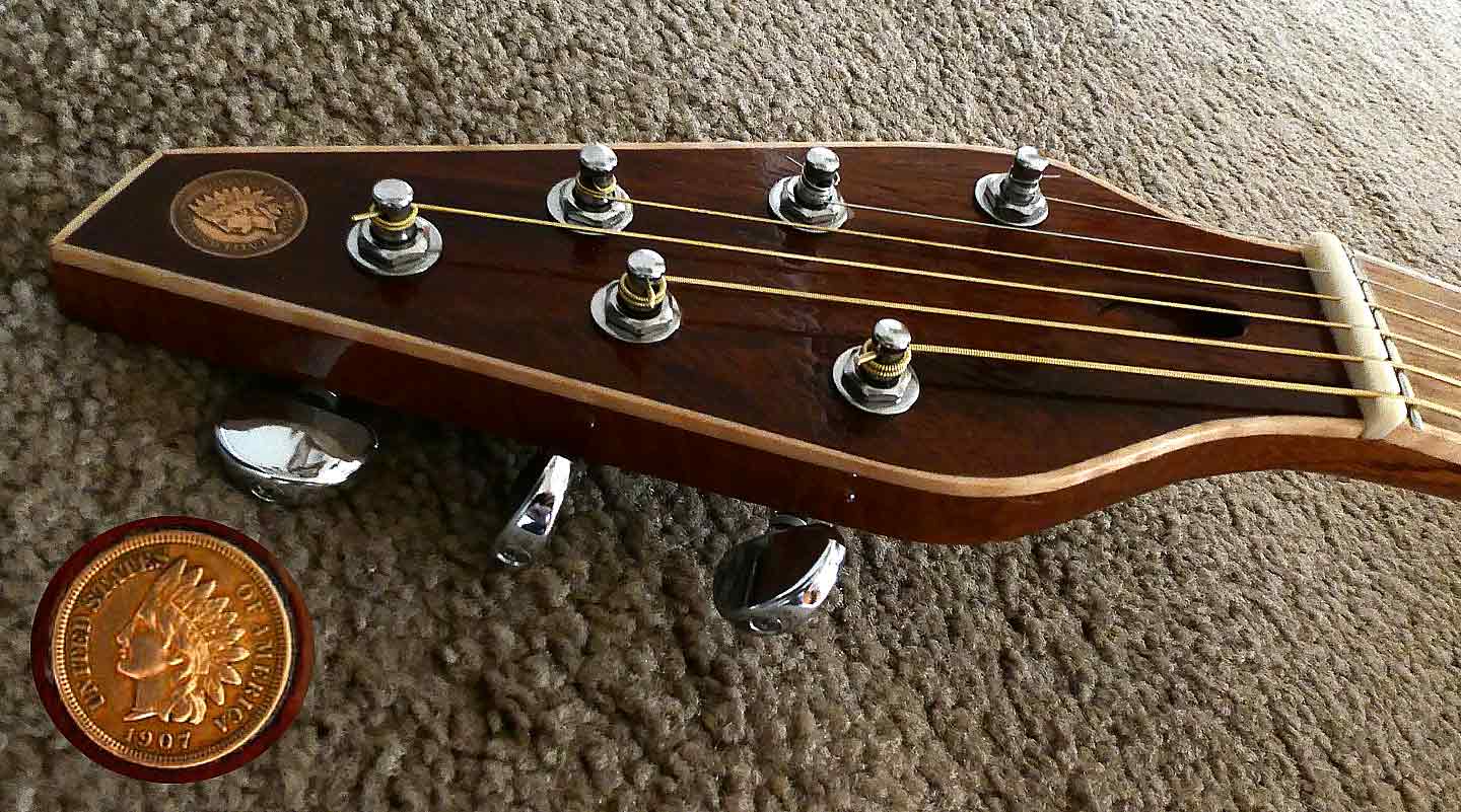

I've finished another. This one's a cutaway, kelobra back, sides and headstock veneer (I didn't pore fill), spruce top, mahogany neck, Honduran rosewood fret board and bridge, maple binding, marquetry top purfling, maple and walnut rosette, JJB-330 pickup. It's my first cutaway, and my first fret board and headstock binding.
The kelobra bent pretty easily - the only build problems were installing the pickup piezos on the bridge plate (lots of swearing, but I finally figured it out), and some too-small metal bridge pins. I drilled and tapered the holes for the pins, only to find that they were too small for the string ball ends when I went to string it up (more swearing). I had to increase the size of the holes from 11/64 to 3/16, and now the pins were too loose. I had some plastic pins on hand that fit the new holes.
Yes, that's an Indian head penny.

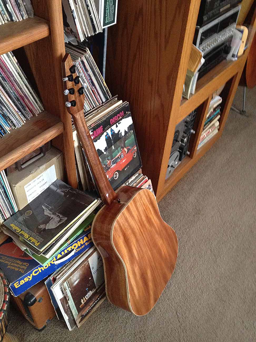

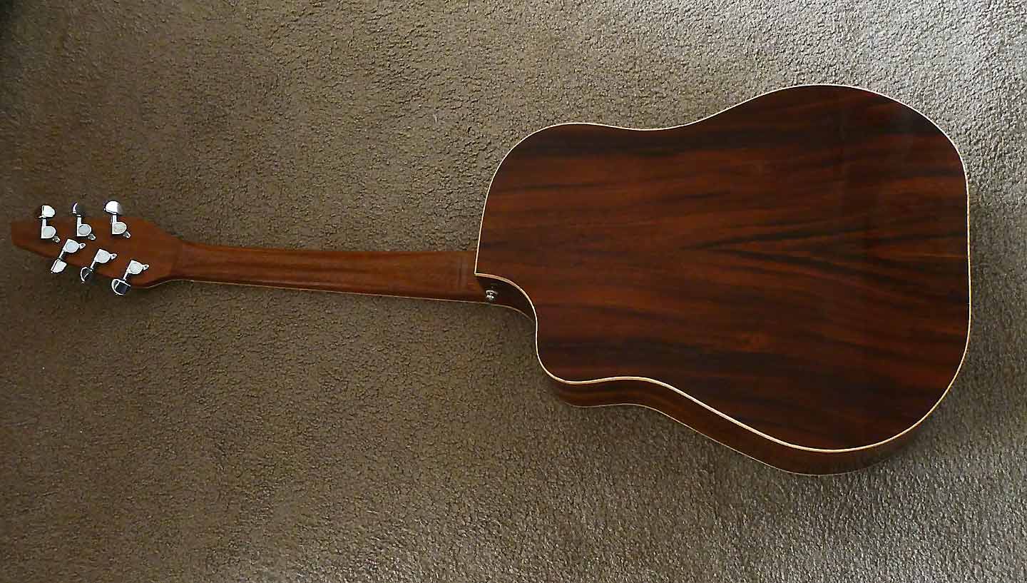

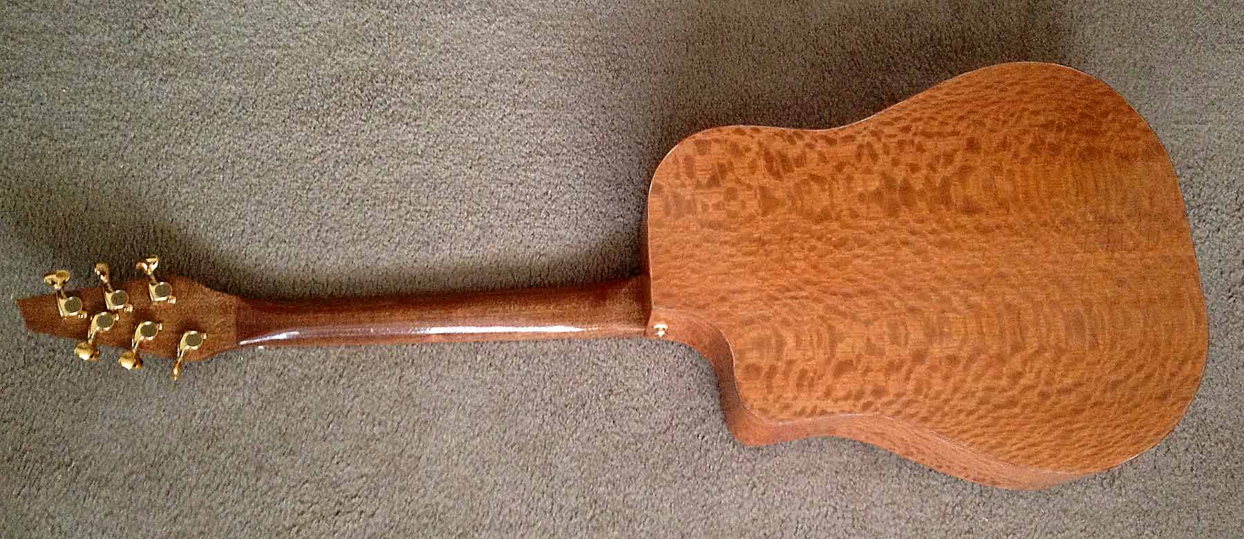

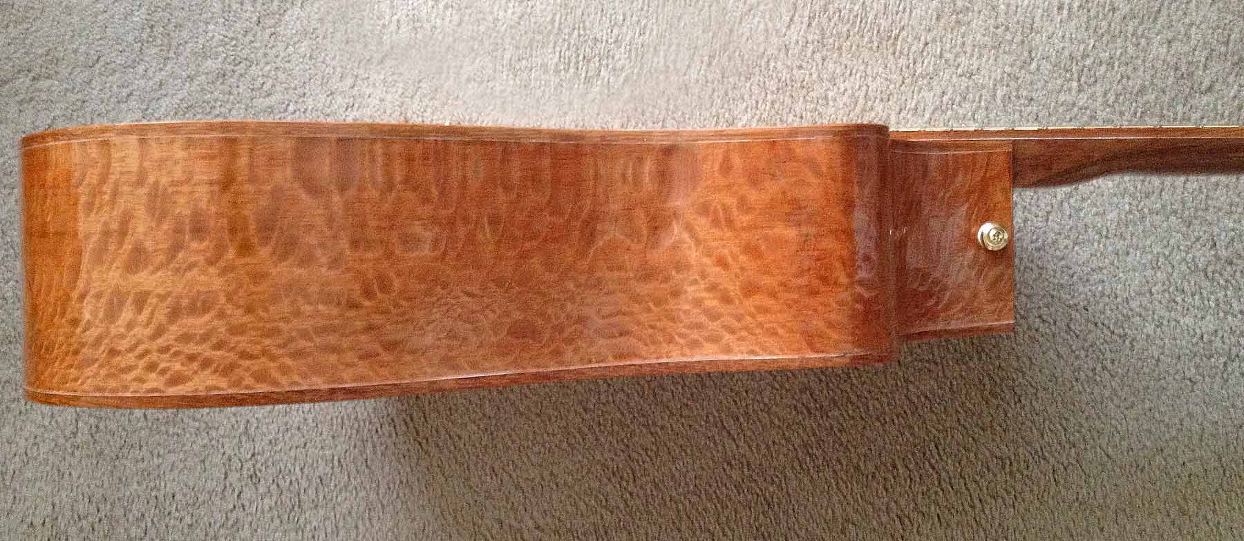

Well, this is the last of the four adjustable neck acoustic/electric dreadnoughts I started a long time ago. It's been a real learning experience, and reinforces my knowledge that I'll never make a perfect guitar. This one has Australian lacewood back and sides, and taught me that I'll never bend or finish this wood again. The wood is scalloped, the grain goes every which way, and filling it would have taken a quart of epoxy and added weight to the guitar. The cutaway side broke in half when I bent it - it was an interesting but far from perfect repair. I also need to be more careful preparing the purfling ledges, and 0.01" is too thin - any variation is readily apparent (at least in my builds.)
The guitar has a spruce top with some bear claw figure, bindings are lacewood but probably another type (from a different board), bridge and fret board are Osage orange, rosette is lacewood, osage orange and ebony with the same marquetry purfling as the top (from LMI), and the pickup is JJB 330.
- Posts: 1317
Re: Acoustic/electric dreadnaught, adjustable neck
More pics.
