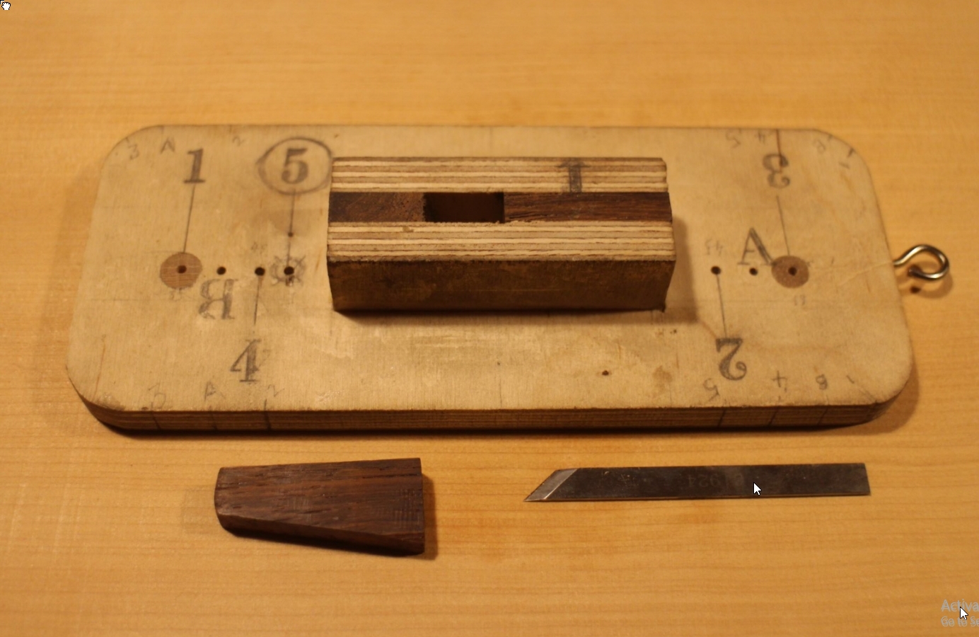

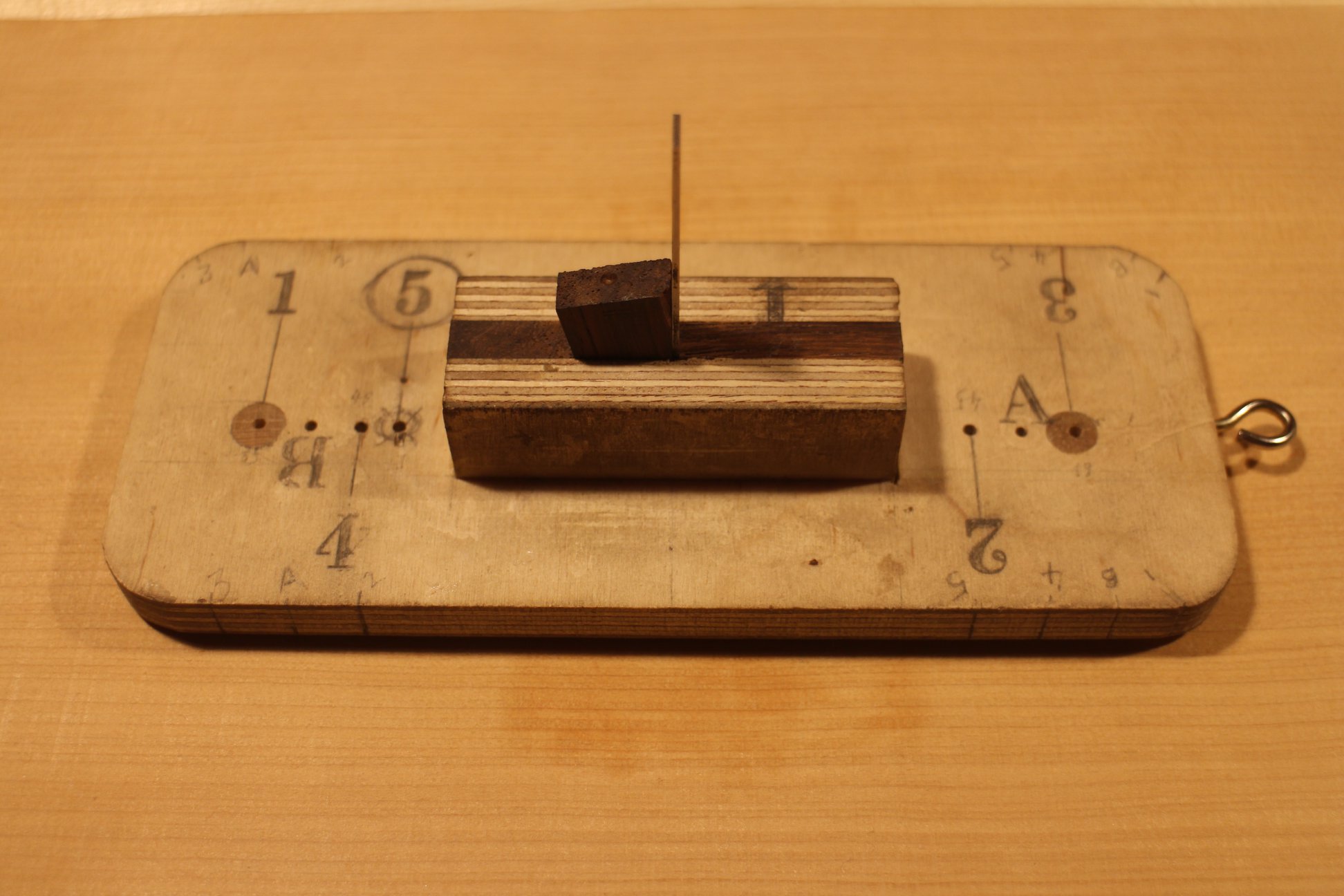

I became frustrated with traditional rosette/circle cutters so I came up with this & thought I would share it so you can make your own. With this design you don’t have to repeatedly adjust the position of the blade in relation to the pivot to adjust the diameter of the circles, instead of the blade moving, the pivot moves along a line of pivot holes, the distance between the holes & the blade tip is pre-set to the radius of the circles to be cut. Instead of having to remove, turn around & adjust the depth of the blade to have the flat side of it on the correct side of the cut (to have a 90 degree “cliff“cut on either the outside or inside of the circle) you turn the whole cutter around 180 degrees & use the holes on the other side of the blade, then spin the cutter in the reserve direction. Each pivot hole is numbered in the order I use them for each rosette. This design saves time, gives precise repeatable cuts & is simple to make.

Not at all mate that’s why I posted it, I’d be flattered. It would be good if you could post a picture of it here or send me one though, I’d love to see it! You could cut a little window out near the blade so you can see where you’re going with it. I draw lines on the top 30mm either side of the centre mark & have numbered marks on the side of the cutter that correspond with the number hole I’m using, once the corresponding mark meets with the line drawn on the top I know to stop so I don’t cut beneath the fingerboard (not that it really matters).
