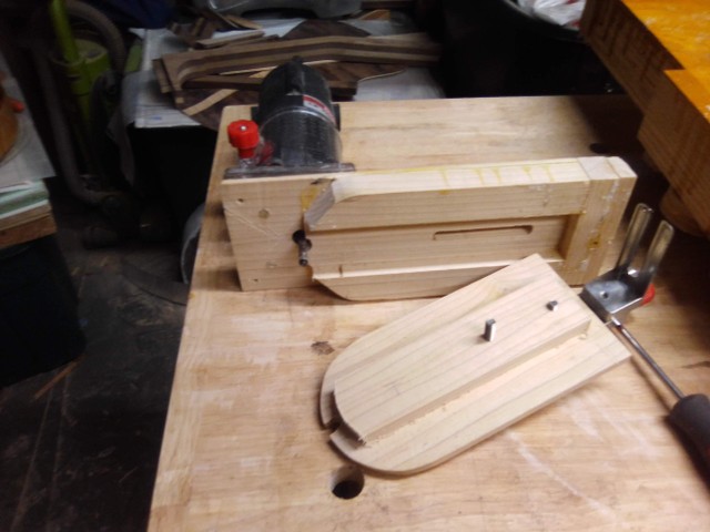

1) Here is the completed jig - Mk 3 since I have had to modify the prototype twice so far  :P The laminate trimmer is a cheap-o from Harbor Freight. The 'micro adjuster' came with it and I modified it to use with my jig. Things to note:<br />The router is supported by a 1/4&quot; piece of ash that is glued to the rest of the jig (also ash).<br />The router is aligned with the 'nose' using a 1/4&quot; drill bit exactly as described for the KMG.
The router is supported by a 1/4" piece of ash that is glued to the rest of the jig (also ash).
The router is aligned with the 'nose' using a 1/4" drill bit exactly as described for the KMG.
2) Here are the two pieces separated. Note:<br />The wide tongue and groove to keep things aligned<br />The two bolts to secure things once adjustment is complete.<br />The 1/4&quot; notch in the 'nose' to accept the router bit<br />The large recess above the 'nose'. This is for the top/back overhang before it is trimmed flush.<br />The wide nose. The curve was adjusted to just fit the curve in my cutaway while providing as much 'meat' as possible to contact the guitar while routing.
The 1/4" notch in the 'nose' to accept the router bit

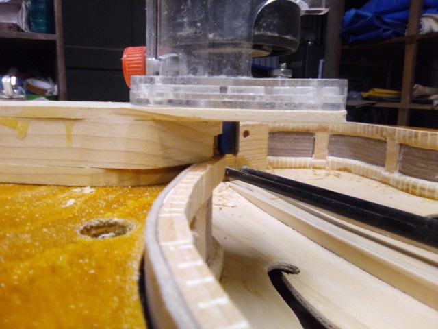

3) Here is the jig in action. The first step is to route the sides, neck/heel blocks flush and parallel to the form. To do this, I use a 3/8&quot; bit with the nose retracted so the bit flies over the sides and kerfing. The neck/heel blocks will require additional planing by hand as the jig will only cut ~3/8&quot; into them. This is done twice, once for each edge. Now I have a rib/blocks assembly that has perfectly parallel edges which are also parallel to the form when inserted and 'bottomed out'.
3) Here is the jig in action. The first step is to route the sides, neck/heel blocks flush and parallel to the form. To do this, I use a 3/8" bit with the nose retracted so the bit flies over the sides and kerfing. The neck/heel blocks will require additional planing by hand as the jig will only cut ~3/8" into them. This is done twice, once for each edge. Now I have a rib/blocks assembly that has perfectly parallel edges which are also parallel to the form when inserted and 'bottomed out'.

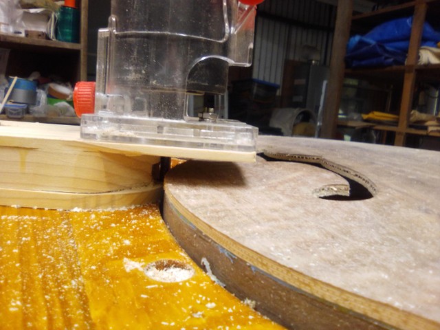

4) Here is the 1/4&quot; flush trimming bit retracted so the nose will be the bearing surface and I can trim the overhanging top/back just a little at a time, using the micro adjuster to slowly retract the nose.
4) Here is the 1/4" flush trimming bit retracted so the nose will be the bearing surface and I can trim the overhanging top/back just a little at a time, using the micro adjuster to slowly retract the nose.

5) Even at the waist, the router flies above the top without touching it.
6) Sorry for the bad pic, but here you see the nose retracted to where the bearing of the flush trim bit will index the sides for the final pass.
7) Here is the final pass with the flush trim bearing doing its thing.
8) The results. Nice and smooth
