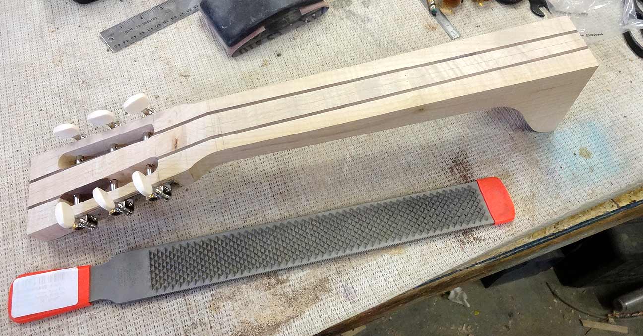

David King wrote:A discussion of rasps wouldn't be complete without mentioning the giant, super-sharp rasps used by farriers to tidy up horses hooves. These are widely available at farm supply places and tack shops. Heller is the kick-ass brand though I had a True Value Hardware generic for years that's still great and cost me all of $17 back in the day. There is simply no faster way to shape a neck and the smooth side will give you a shiny smooth surface if you hold it at just the right angle. Gloves are an absolute must with these. I always use them inverted and pull them towards me for more control. I will say they do require some 'horsepower" a great upper body workout but just as fast as a router if you have a way too hold the neck firmly.
A useful tool. This one, a Nicholson, was $16 but the price has gone up.
