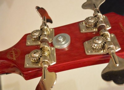

In contrast to some of the previous posters, i sometimes notice a significant effect of the mass of the headstock (and hence the tuners!) on the sound: on my basses, a heavier headstock leads to better attack, but also to a darker tone. If the headstock becomes too light, even the feedback sensitivity of the bass may change. And, of course, the mass of the headstock will also affect any dead spots.
Our possibilities to modify the headstock mass of a given instrument: vary the weight of the tuners. Add additional mass to the headstock.
On some of my basses i went for the latter and added a few large washers on the back of the headstock. If they weren't so ugly, that could be regarded as an important step in the setup procedure of an (electric?) guitar.
Example (Epiphone 1960s EB-3, shortscale) - the number of washers is obtained by trial and error:
