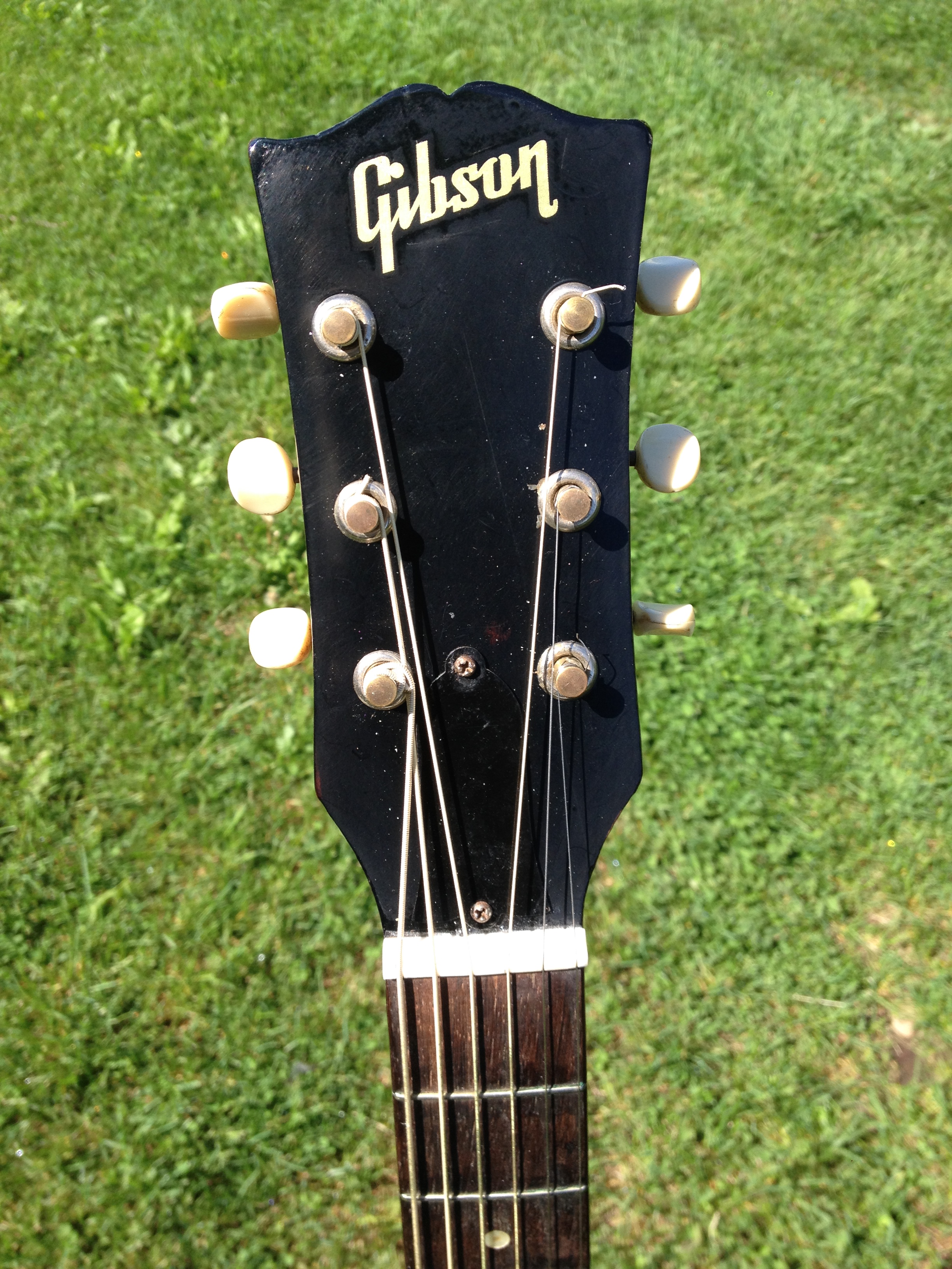

Postby Greg Steil » Wed May 04, 2016 8:21 am
thanks, I intend to tint the clear coats to do the back of the head. Also, the tuning machines cover a lot of the ugly on the back. Plus the rest of the guitar has it's share of dents dings etc.

Postby Eric Baack » Wed May 04, 2016 9:16 am
I'd probably still do a back strap just for structural reasons. The front plate doesn't add nearly as much to the structural integrity as the back plate does when you look at the torque induced by the strings to the headstock. I could draw up a free body diagram :p (engineering geek here)

Postby Todd Stock » Wed May 04, 2016 12:02 pm
27 years as an aerospace engineering/structures guy...not necessary, but it can't hurt. Already overkill for the small loads applied. I've done a couple of these that were in 7-8 pieces, and as long as there is adequate long grain area, not an issue. As long as the break does not run through the neck/peg head join/transition, not much of an issue with this type of break.

Postby Greg Steil » Wed May 04, 2016 5:21 pm
ready for clear coats. The back will get a lightly tinted spray.

Postby Greg Steil » Wed May 11, 2016 10:38 am
so far, so good.

Postby Greg Steil » Fri May 13, 2016 7:19 am
Hey, thanks so much for the kind words, I should have it all back together soon. But since it has been "down so long", I've been playing my 48 SJ, so this will probably go back in the case after a test spin! Thanks again.

Postby Greg Steil » Fri May 13, 2016 3:00 pm
well, here tis
