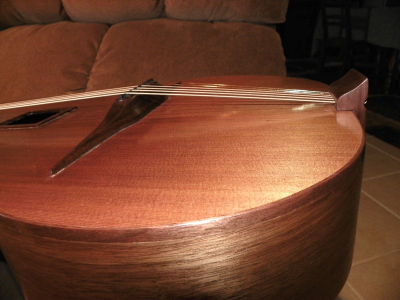

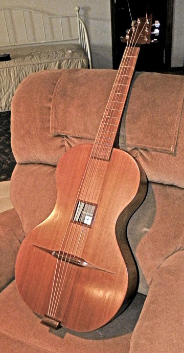

This is my first, I have a question about my second. This one uses an unusual bracing system which, I think is responsible, among other things, for a sweet but quiet, highs oriented tone. This is fine for me, but a friend wants one like it, but with a more conventional sound. His, then will have a more standard x brace system. My question is how much arch do I need in the x brace so that it won't go concave under full string pressure? IOW, how much deflection of the top, given a string break like you see in the picture, may I expect under full stress? I fully understand that a precise answer is not possible. I am perfectly happy with the most ballparky of ballpark answers.

That's an interesting combination of styles there, Joe. Sort of Selmer meets Panormo. Maybe you can tell us a bit more about the "unusual" construction details so we can understand what sort of departure is necessary to reach your goals.
Also, out of curiosity, how have you braced/reinforced that square soundhole? Without some sort of cross-grain treatment, it is very likely for cracks in the top to develop at the corners.

That's exactly what my question is though. Given an x brace of "normal" dimensions, say with struts 3/8 wide, 1/2 deep and about 15" long, the degree of string break over the bridge that you see here, very roughly, how much deflection should I expect under full pressure?
As for the one in the picture, there is a structure running the full length of the box and tying together the end blocks, which contacts the top at a small point right under the bridge, giving the bridge a very firm platform on which to sit and, I think, relieving the top of all pressure from any direction. There are then 3 very light cross braces ( 1/4 x 1/4), one below the bridge and one above and below the sound hole. For the next one, I plan to keep that structure, except for the point at which it contacts the top.

I would mention that the biggest brace (in most steel string X-braced guitars) is the bridge. With the long bridge in your picture, and the inside braces you describe, you probably have a lot of support on that top.
Of course, you might have such a stiff top that it does not move very much. That is one of the balancing acts on instrument building. Keeping the design on the edge of failure, without failing.

I'm unable to make myself clear, apparently. The part of the interior brace in the guitar above which contacts the top won't be there in the next one. With regard to the top, it will be conventional bracing. I understand the fuzziness of the question, but I'm not looking for an exact answer. The top will be red Cedar, but for the degree of exactness I'm looking for, I doubt that the species of wood in the top is a relevant consideration. The braces will be a quite hard wood, in this case Hard Maple. I'm only curious whether 1/16 is reasonable, or should I allow for a quarter? I understand completely that expecting better specificity than that is hard. Thanks for the responses.

This isn't exactly the answer you're looking for, but I think it's close. The top usually has a 15' to 20' radius dome, so that's about 1/8" if I understand what you're asking.
The top is usually braced in a radius dish that forces the dome. Some are built completely flat, but those have pinned bridges, so the top is pulled up behind the bridge and pushed down in front of the bridge by the torque on the bridge.
With the trapeze tailpiece, the force will all be downward, so you do need a bit of dome on the top, and this is usually expressed as a radius. I believe you've expressed this as the offset across the guitar, and 1/16" is a little flatter than usual and 1/4" is more curved than usual, but your guesses are certainly in the ballpark.

Sure, make your X-braces 1/4"-5/16" wide by 1/2"-5/8" tall, splay them 90-100 degrees, position the X under the ends of the thicker bridge segment, fill out other "finger" braces and "tone bars" as you see fit, and arch it as much as you think will do the trick. Maybe move your sound hole (window?) north about an inch or so to give the X some room. Oh, and then make the sound hole big enough to put your hand inside to shave down the braces if they turn out to be too big (the small sound hole and its location might also be contributing to the softer voice).

Thanks very much, I think about 1/8 of arch sounds sufficient. I'm not married to hardwood braces and I think the Spruce is good advise to take. I imagine the small hole is a contributor, and the first time it needs strings, I may enlarge it some and see. The hole(s) on the next one, btw, as per the wishes of the guy it's going to, will be the outline of a feather or 2, to go along with a bridge in the form of a steer skull.
