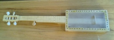

A rectangular banjo with a soda-bottle (PETE) plastic head and fishing line strings with friction tuners is a little more sophisticated but can easily be done in two days. The head is shrunk tight with heat from a blow dryer after tacking it on the body frame. Make it fretless but mark the fret positions with a Sharpie for simplicity.
