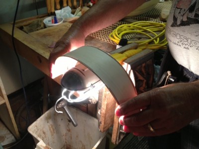

Since I got no suggestions on whether or not to inlay before bending, I decided to lower my sights a little and proceeded to install some banding on a piece of 1/16" thick maple and then try to bend it. It actually worked out fairly well with no obvious damage to the binding that I can see. Maybe at some point I will undertake another more ambitious cover, using two layers as I described earlier and see if that would work.
Incidently, I couldn't find a suitable piece of pipe to heat up and bend around so I used my trusty trouble light which I found worked very well for this 11" diameter bend. It took a little longer than bends that I have made with a 2" piece of copper pipe with a propane torch stuck in the end, but there was minimal chance of charring the wood either.

Yet another bending tool!

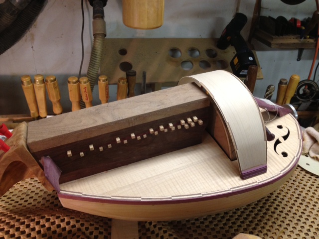

Are you using anything like hinges or magnets to hold the keybox cover on?

I think I'll use hinges. I have some small brass ones kicking around. Not exactly authentic though. I think I will use a magnet to hold it shut. I also have a few 1/4" diameter real strong ones which should keep it closed. I also have to figure out some kind of decoration for it.

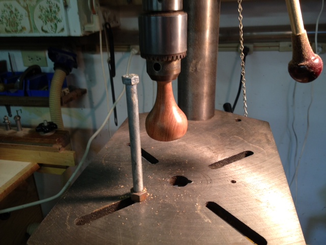

While I am trying to decide what to do about nut/bridge spacing (see above post) I decided to try to make a knob. I sold my lathe a couple of years ago since I really didn't enjoy turning wood so I decided to give it a try using my ancient Sears drill press. It actually didn't turn out too badly.

You've got to be careful with that kind of turning with a drill press. If the chuck-spindle attachment is a Morse taper fitting, they don't always withstand the lateral forces from turning or sanding and the chuck can loosen and come off with disasterous results. Or at least so I've read, fortunately I don't have that problem with my Shopsmith as the spindle for the drill press is also the spindle for the lathe.

Good point. I actually had the table a bit higher so there wasn't room for anything to fly out except at the end when I did the bottom part. Also I was wearing a face shield. It's funny but I used to have a General 260 lathe which in it's day was a Cadillac of lathes around here, but few things turned out as good for me as this knob!Jon Whitney wrote:You've got to be careful with that kind of turning with a drill press. If the chuck-spindle attachment is a Morse taper fitting, they don't always withstand the lateral forces from turning or sanding and the chuck can loosen and come off with disasterous results. Or at least so I've read, fortunately I don't have that problem with my Shopsmith as the spindle for the drill press is also the spindle for the lathe.

I did a little research on this 30+ year old Sears 113 drill press and discovered that the chuck is held on by a screw on retaining collar which requires a spanner to remove. I love this drill press. It has an 8" quill which I find to be very useful as I rarely have to raise or lower the table.
