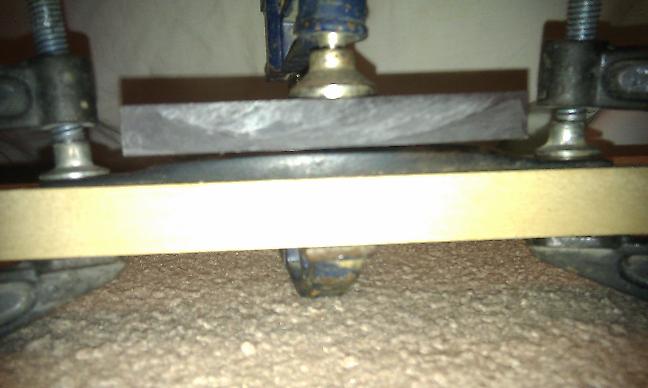

I'm working on an Alvarez with a really bad bridge belly. as usual the bridge is pulling off so I went ahead and removed it. When it came off it was extremely warped and twisted. (Imagine the St. Louis Arch after being hit by a tornado. I exaggerate of course, but you get the idea.) I wanted to see if I could save it rather than having to replace it. so I clamped it to a straight caul on the bottom to get the warp out and clamped each end flat to take out the twist... then put it in the oven for a couple hours at 225F. Took it out and it was flat as a pancake. after looking at it for just a minute I quickly put it back in the clamp set up to set overnight and hopefully get the wood to fix it's memory in that position.
I just made this up on the fly as I was doing it. Has anyone else ever tried something like this? If so can I expect long term results or will it just go back after I let it out of the clamps? or does that all depend on how long I wait to put it back on the guitar?

I have flattened bridges with heat before, and it works. We bend sides, and expect them to stay put...why not a thicker bridge? I heat and clamp it, and then will sand and scrape the bottom level, that gives me a fresh surface for gluing too.
I think I'd just replace the bridge plate and re-glue the bridge and that will get rid of most of it, the rest should be manageable. Avoid heating the whole top.
