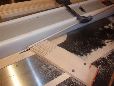

When I make braces I like to use my table saw for making the top braces. I have a slick jig for cutting in the top radius. The first thing I do is to size the stock. I do this by ripping the spruce on the band saw then using a thickness sander, You can rip your stock out any way that gets you good results. When ripping on a table saw THINK SAFETY. Use feather boards and press sticks. Here is a pic of my set up

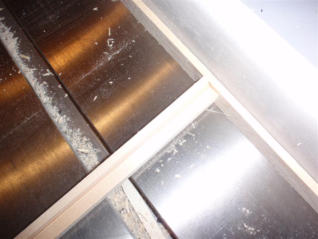

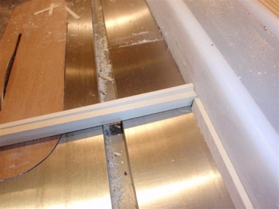

Once ripped and sized I will but the side angle using the same holding mechanisms. after the sides are rough shaped I cut the radius . I like to use a 28 foot radius and use this jig on my table saw.

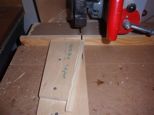

End shaping can be done many ways. Here is my favorite

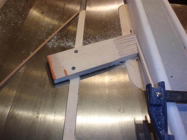

The final step is notching for the X lap joint. I figure the thickness of the saw kerf and make a stop block to work with my rib fence. This way I get a nice consistent fit. I use the miter gauge of the saw.

Hi John, nice to see you back at MIMF. So, the jig for cutting the radius on the braces has stops or hold downs or something, that allows you to bend the brace at your desired curvature and hold it in that position while it is cut, and after it is released from the jig, it springs back, with a nice curve along one edge. Is that it? I believe I've seen a commercially available jig that works on the same principle. Do you glue the braces straight off the saw, or do you touch up the glue surface at all (plane / abrasive / other)?

The way I made this was to set 2 stops ( those are the dowels) Then I set up the clamping point with the toggle pad at the point of the X brace intersection. I then tweaked at this until I hit the curvature I was looking for , in this case 28 feet. I found this to be very repeatable. I use a Forrest brand blade and it cuts nice so I can glue right off the jig. After I set the curve I set a screw in for the upper stop. Now I have a set of braces that will match.
It took a while to dial in this jig but it was worth the effort. I have seen others that are commercially available. Use what works best for you.

John I'm not sure what you are doing in Photo 1 and 4, why is the brace clamped to the fence ?
John Hall
Posts: 27
Joined: Sat Jan 21, 2012 5:49 pm
Re: Making braces
Post by John Hall »
that isn't a brace it is a hold down feather board to hold the braces to the top for sawing

John, is there a picture missing somewhere ?
I can certainly visualise how one could cut a 28' radius on a brace on the tablesaw (although personally I would do it on the router table) but all I see in these pics is the workpiece tight up against the fence, which isn't going to give a radiused cut.

router tables will work but the jig uses the flex in the wood. Look close at the stops on the jig. the spring on the radius relaxes and the arc is 28 foot. These jigs are actually common.
There are 2 dowels that spring the blank, the screw toggle is set to the X joint. There is a screw that is the stop for the upper bout section of the brace. This works very well.
