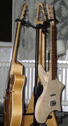

Hi,
this question concerns a guitar project i have already shown in a sketch:
Meanwhile the instrument is short before i can put strings on it (saddle is missing, will be brass).
My idea is to use a transparent varnish as a finish - intentionally leave the structure of that cheap wood visible. My idea tends toward a deep blueish violet. First attempts with violet stain (Clou) were pretty discouraging: the coulor is more purple than blueish. Moreover i am afraid that the end-grain portions of the spruce will become a lot darker than the surface, and andy staining result will become grossly uneven.
So i am looking for transparent varnish. Unfortunately i do not find anything in violet.
Any suggestions?
Thanks
Beate

Mark Swanson wrote:First, the way you're posting the images isn't working and they don't show!
Thanks for the note. I am just using a reference to an external image in IMG-tags. I did not recognize that You must be logged in that other forum in order to see the images. At present i am not logged in there, but still see the first of the two images. Do You see that one as well?
Beate
PS: here the photo in question...
PSS: meanwhile i learned that it is possible to use alcohol solvent stain to color nitro varnish. Maybe the best idea to procede? What i did not mention - i am planning another instrument - an ergonomic bass, fretless, top figured pear, body light walnut. Neck an old Framus neck from maple, rosewood fingerboard (stabilized by a polyurethane finish). In that forthcoming instrument the violet is almost a must. The guitar is more or less a pre-study for that bass.
