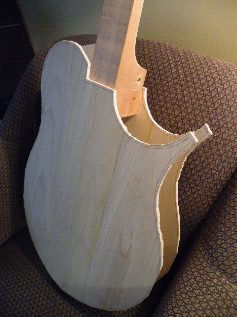

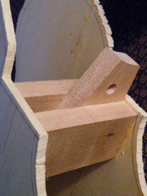

Hi Peter ... the soundboard and back are now glued to the 2 blocks. So, the mahogany will be glued around the outside of the guitar.
Posts: 1216
I suppose that will work if those posts are pretty close together, and if there is one glued to each side of the heel block that you can glue the mahogany ends to. Are you going to pre-bend the mahogany, or make it thin enough that you can bend it as you glue it?

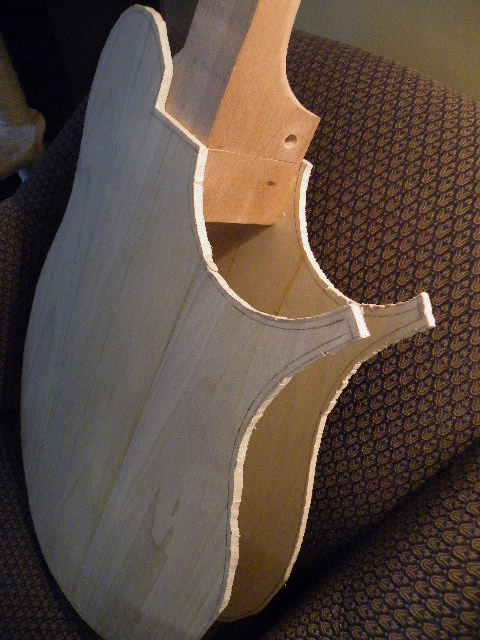

Post by rob bowen »

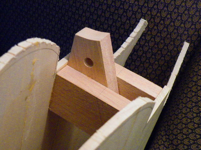

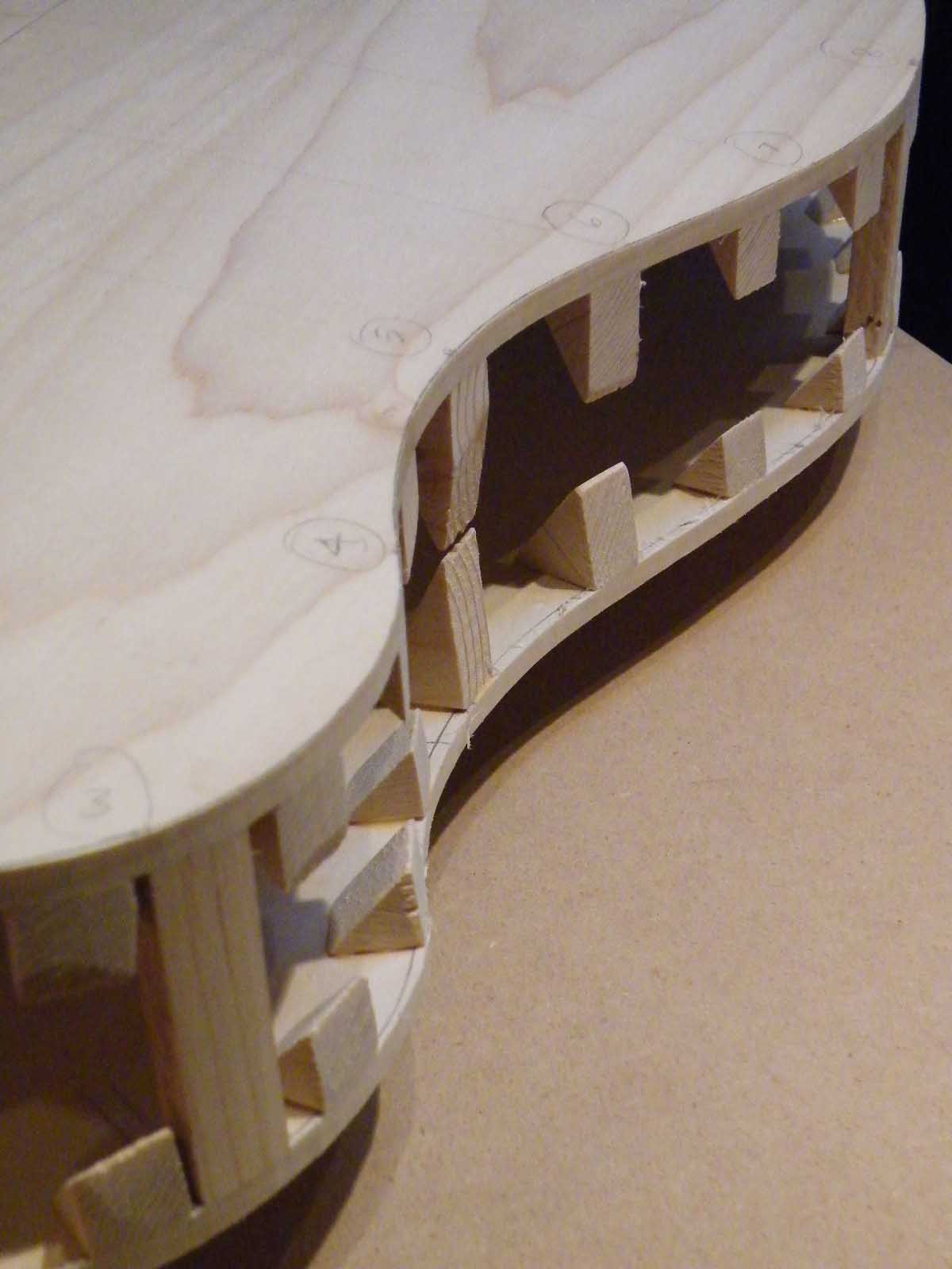

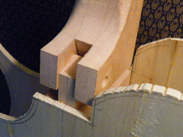

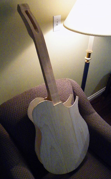

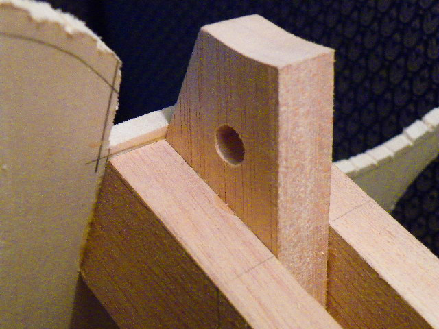

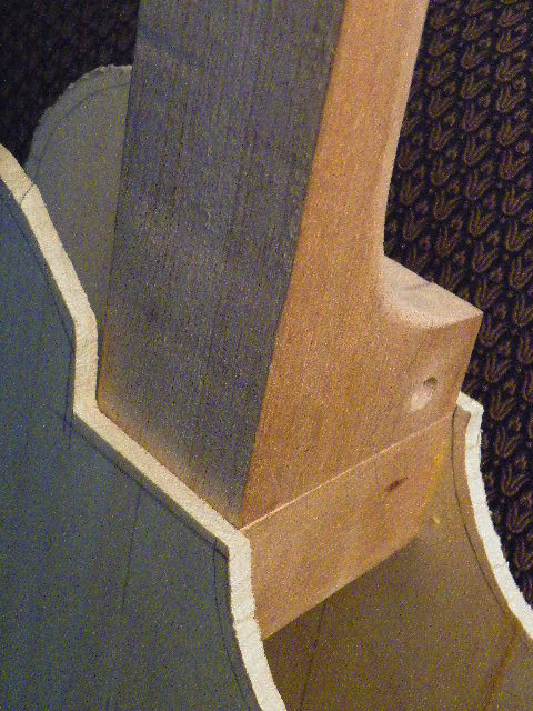

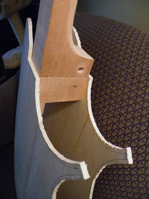

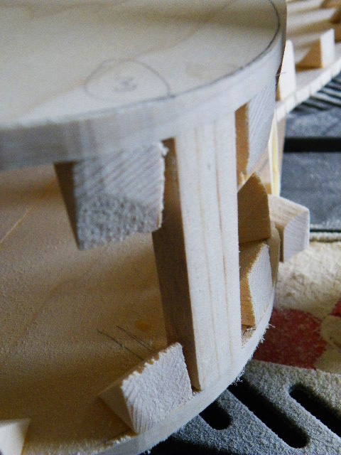

It's starting to look like a guitar ... but I know there is a LONG, LONG way to go. Today I am creating trapezoid posts for the inside outer edge, particularly for the lower cutaway points ... as it appears they could snap on the grain at any time :o I will be cleaning up the sounboard and back of the guitar where they meet the neck block with a chisel .. any excuse to use my chisels ... I love them :D I am very pleased with how the neck slips snugly into the neck block, without hanging up on the soundboard and back edges. I could not be happier with the project at this time. :D

Posts: 1272
Is your fingerboard going to end at the neck, or is it going to be notched out at the end to go over the soundboard?
rob bowen
Posts: 122
Location: Vancouver, BC
Post by rob bowen »
I am envisioning the fingerboard extending out over the soundboard like a diving board over a pool ... but not parallel to the soundboard ... kinda on the same angle as the strings from the nut to the floating bridge. By the way Bryan, when I spoke to this fellow at the guitar shop yesterday, he suggested tying on cat gut frets ...he says lute makers still make them that way. I asked him if the individual knots get in the way or impede comfort ... he said "no". Hmmmmm.

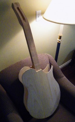

Having braced the inside of the lower cutaway, this morning I wanted to see how the guitar would sit on my lap, and how it would feel overall ... I like it so far.

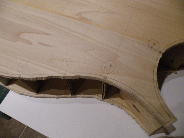

Post by rob bowen »

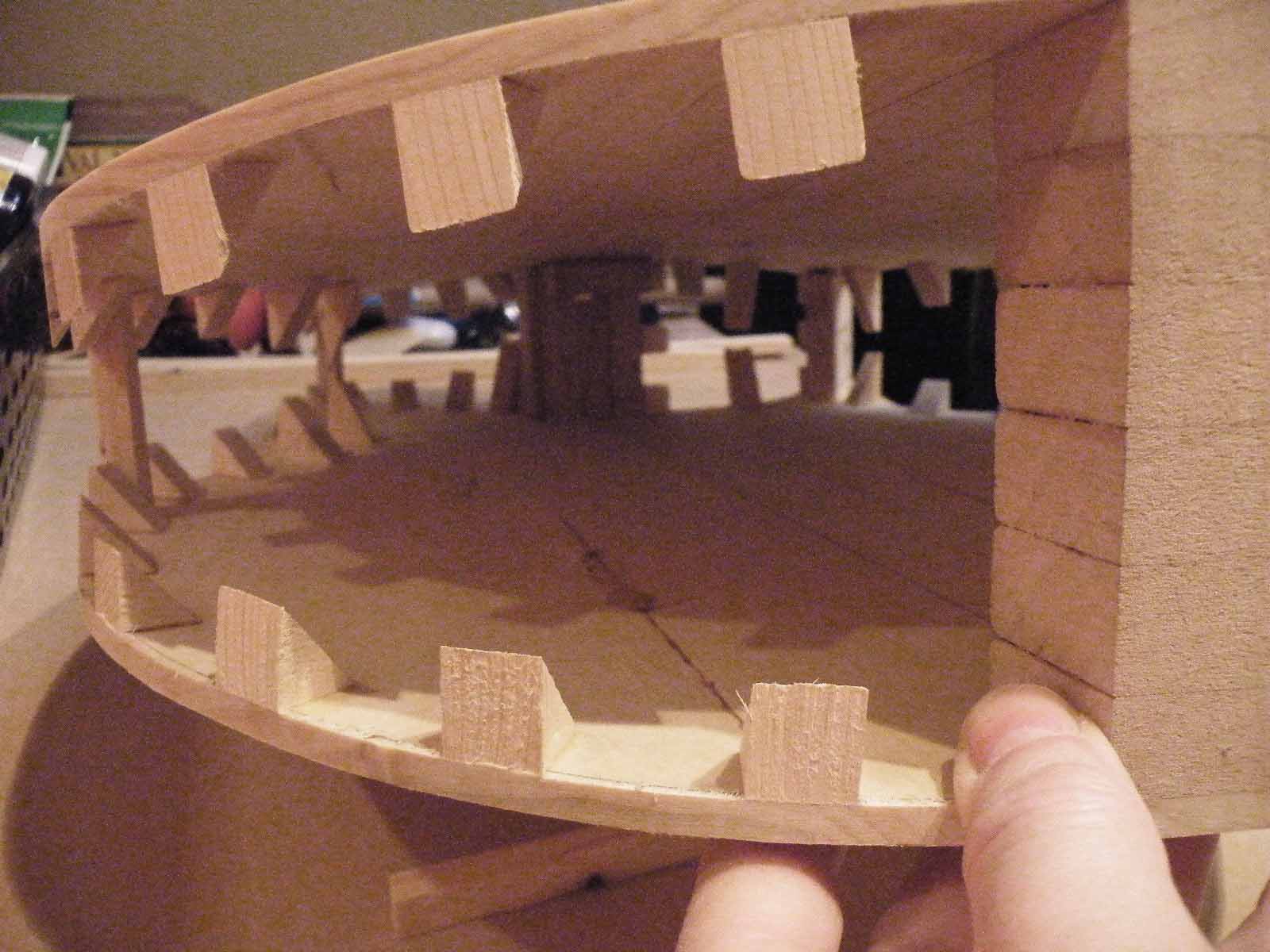

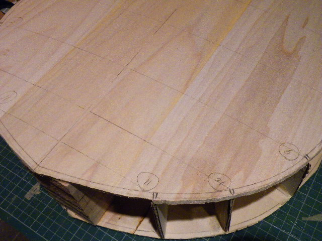

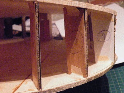

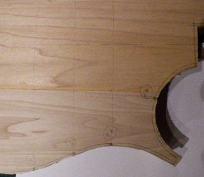

This afternoon I made a trip to my neighbourhood guitar shop .... first visit as I just moved here recently. I chatted to the repair / builder fellow who was very amicable and extremely helpful. I purchased 2 pieces of bone .... one for the nut, one for the bridge. This evening, I have made cardboard templates for the trapezoid supports for the perimeter of the body. Starting at the neck block, by the time I had fashioned them as far as the endblock, I considered checking their fit for the opposite side of the soundboard. Drawing a pencil line across the soundboard at 90 degrees to the center line, I positioned the first several and discovered a near perfect fit. I was quite surprised, as I did not expect the soundboard to possess the same curve on both sides. :o
Posts: 2754
With those big tie-blocks and the thick hardwood top, you may not be getting much acoustic response from that guitar. Planning on having a soundhole?

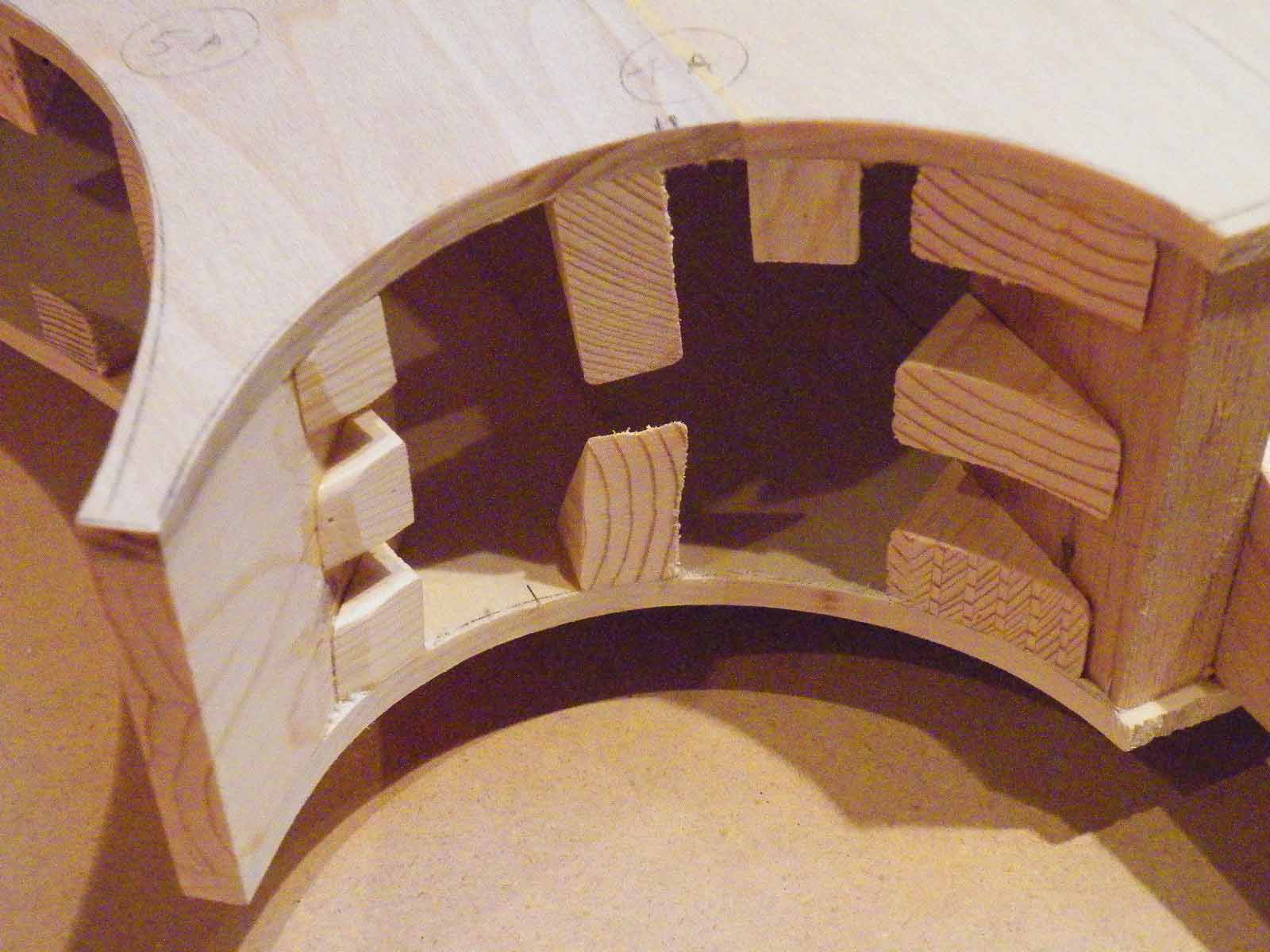

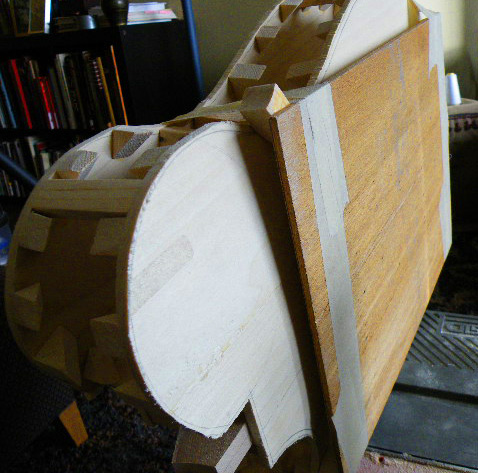

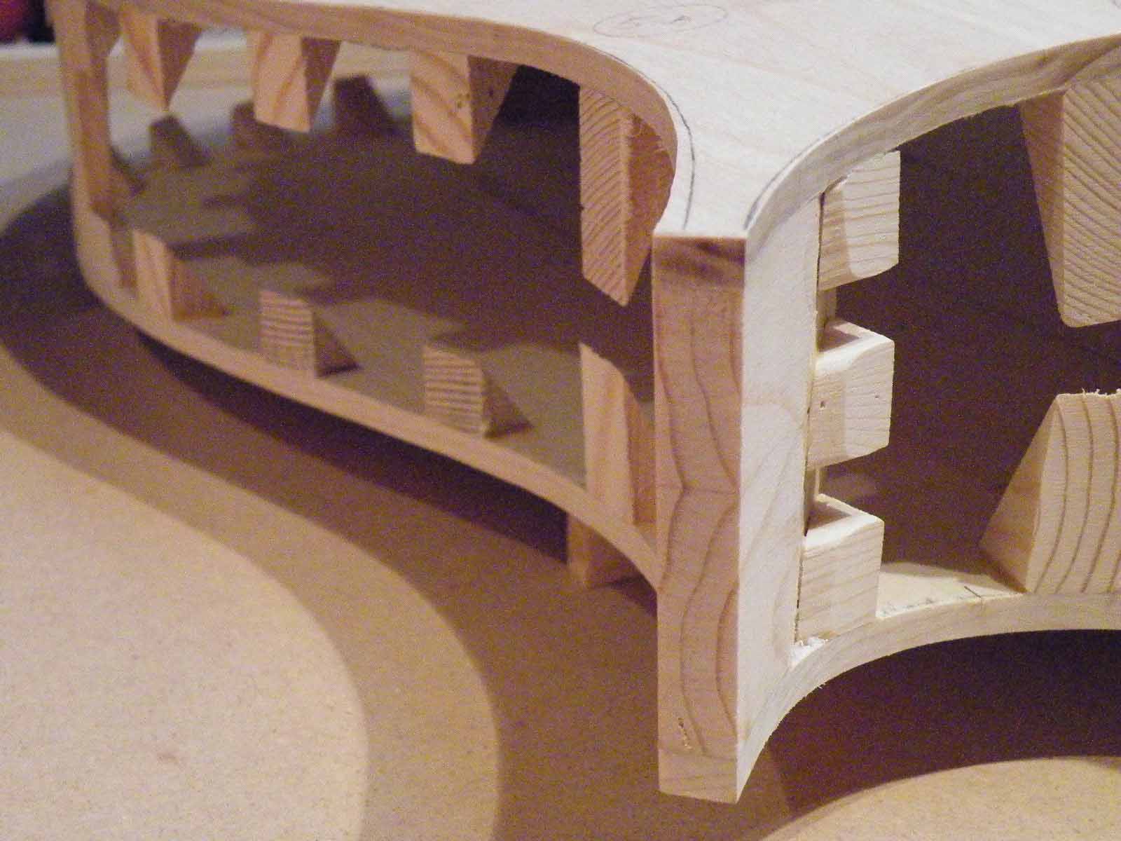

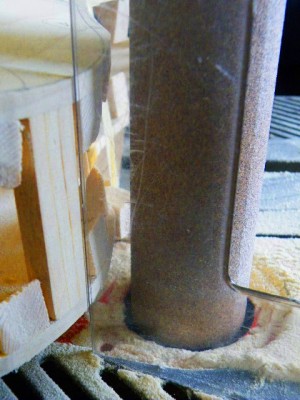

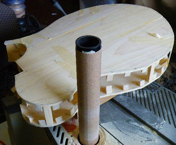

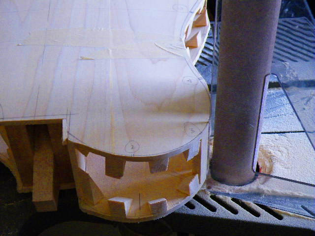

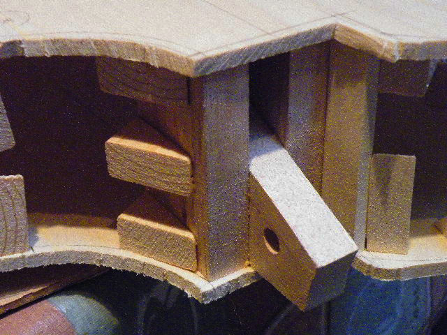

So, I decided I the guitar didn't need "posts". I opted for making small triangular wedges along the inside outer edges of soundboard and back. Kinda resembles a venus flytrap. I did add a few posts though. I set myself the task of figuring out how to extend my spindle sander. Decided upon using a 12" length of ABS 1.5 " plastic pipe .... coincincidentally fitting the rubber sleeve of the spindle sander .... hooray. :D This afternoon I made a cradle for the underside of the guitar to rest upon while being sanded ... keeping the outer 2 edges at in liner vertically ... still with me? Blah, blah, blah ... it lined up once I began sanding the edges ...I checked it with a set square ( see pic ), I'm pretty pleased so far. :D

Post by rob bowen »
I completed the sanding on the outside edge of the body last night. Well, as much as I can do with the spindle sander. I will be dressing it a bit by hand before the sides glue on. Next is the thickness sanding of the soundboard and back. I need to make some thickness calipers.
Posts: 1272
Some of those glue blocks look to be oriented to crate endgrain glue joints. In the cutaway area it looks like a me you have endgrain glued to the heel block and where the side wood will attach. I'm afraid that as the string tension try's to rotate the heel block forward some of these weaker (endgrain glueups are not a strong) joints may come undone. Especially the side wood to glue lock endgrain, I immagine Thea will be difficult to clamp tightly the begin with.

rob bowen
Posts: 122
Post by rob bowen »
