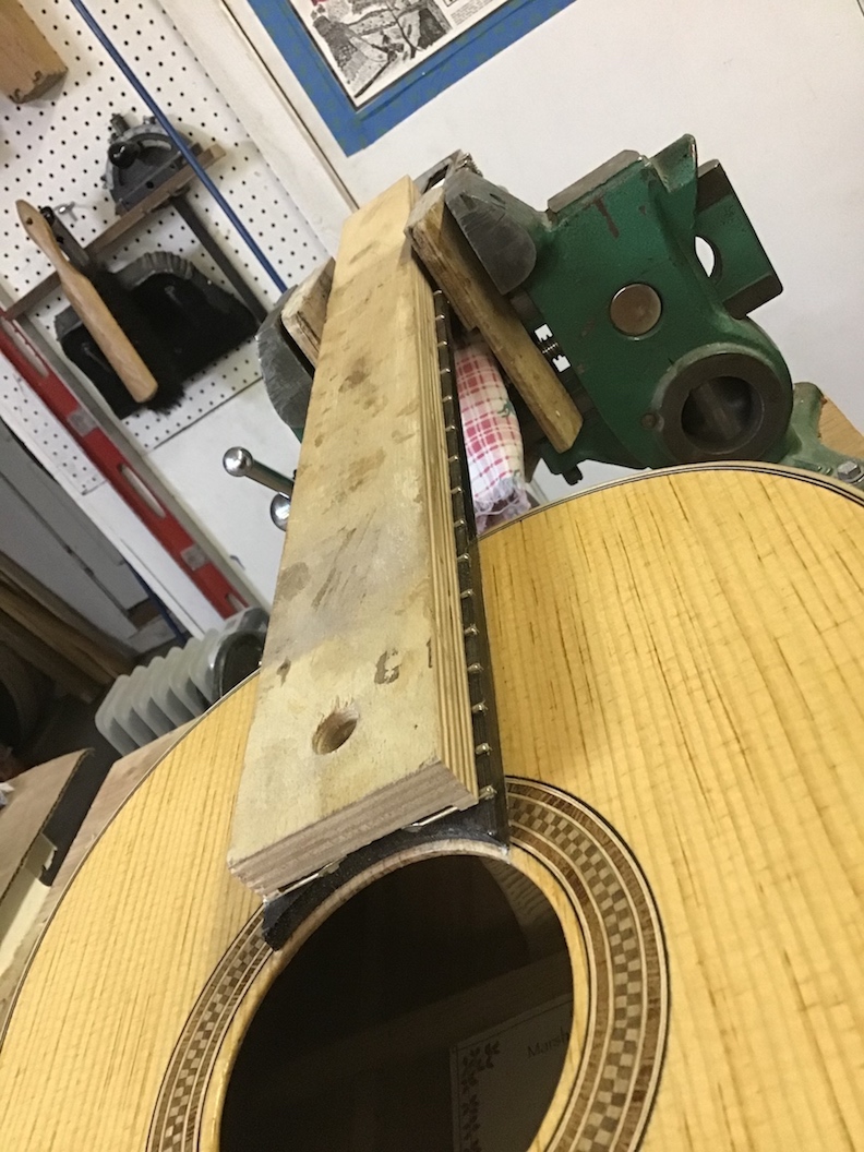

Hey Pete, Here are some pictures of what I use. It is not as rigid as I would like and will probably put some re-inforcment in one of these days.Peter Wilcox wrote: ↑Thu Sep 24, 2020 1:43 pm
...suggestions on how to do things differently/better/easier would be appreciated, since I'm going to do another one soon...
I do my boards pretty much as the steps you listed except I radius and slot the board before tapering. I put the frets in first before gluing to the neck, also. The one thing about the bound boards with the overhanging fret ends is that should (when?) the fretboard shrink the little tangless ends can be caught and pulled up. Then they need to be glued down. Had this happen to a guitar I made in 2003 that was kept in a dry climate for 17 years. I use the Stew-Mac fret nipper.

I fret my boards before I glue it onto the neck too. I don't use any caul at all. I use index pins and a bicycle tire tube cut into about a 1/2 " strip that's real long. You wrap that tight and it's clamped. Also I always check my fret board along the edges especially after I radius it. I use a piece of fret wire with no barbs, bent up and stuck into a little wood handle. The radius might make the edge of the board have too shallow a slot and that's not good if your using binding along the edges.
