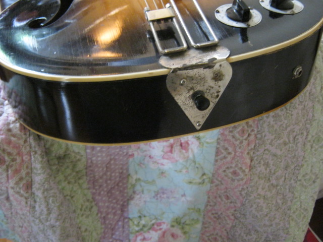

Ooooo! Please post a picture of the tailpiece anchor-part! I want to see this rare piece of hardware.

Here is what the original tailpiece would have looked like. Note that it goes all the way to the back of the guitar, which is a little over 3" thick, is triangular in shape, the pin is a wooden press-fit tapered pin, and the engraving is Frequensator Pat. Pending. This one is on my 1946 Zephyr, seems a factory fitment even though it would have normally had a trapeze tailpiece stock.
Posts: 842
Re: Can this live again? 1941 Epiphone Triumph
Postby Roger Rosenberger » Fri May 31, 2019 10:56 pm
Brian- That’s it. That’s exactly what the tail piece looks like.
