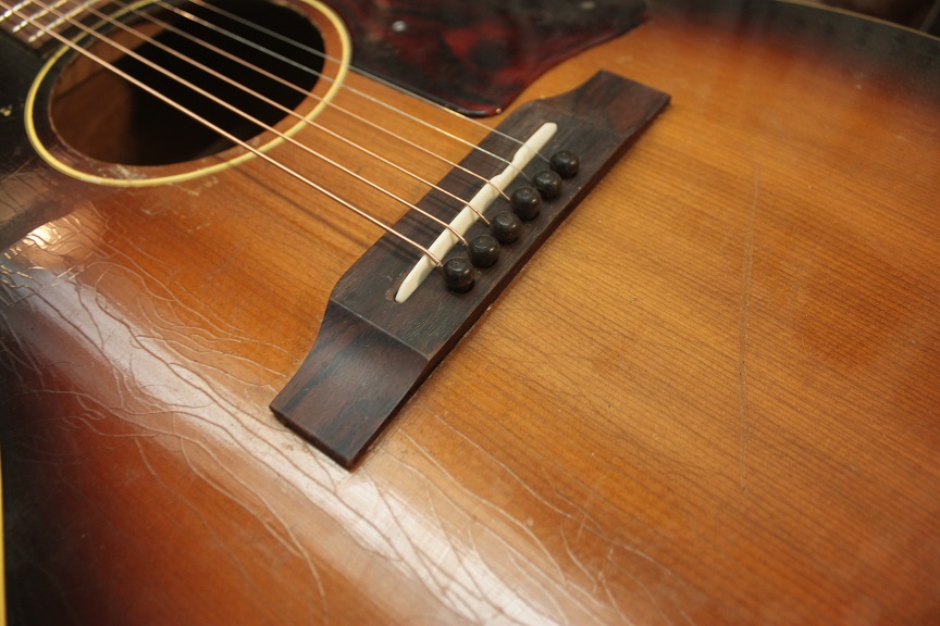

Postby Freeman Keller » Sat Apr 20, 2019 12:11 pm
I replaced the plastic saddle on an LG-1 with a rosewood one and cut the slot at the scale length plus 1/16 on the high E and scale length plus 3/16 on the low E. I gave the saddle the usual B string notch and the intonation seems pretty good on this funky old guitar. Also had to reinforce the bridge plate and top which were pretty badly damaged, plug some holes, remove finish under the bridge footprint - the usual stuff
And yes, there are a whole generation of Martins from the 70's with the saddles in the wrong place. And of course the dilemma of what to do about them

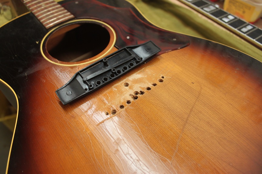

Postby Darren King » Fri Apr 26, 2019 9:00 pm
Hey Freeman,
I have just looked at you photos more closely. OMG! Is that injection moulded monstrosity really what Gibson were fitting to their acoustics in the 70’s? How on earth did they maintain their reputation?

Postby Matt Atkinson » Mon Apr 29, 2019 4:01 pm
Did you cut that saddle slot twice? The last pic looks like it's cut right behind a filled slot? I was going to make a new one but if I use the bridge I took off it will look very much like that! That pic helps a lot because I was worried the low E string pin would end up crowded towards the saddle but I think I will end up right about there. Thanks!
