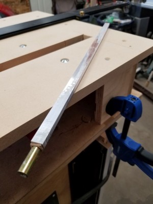

After removing the fret board and cleaning the surface, I removed the old truss rod.
This thing was 15/32 wide and 23/64 deep, and had rounded corners on the bottom.

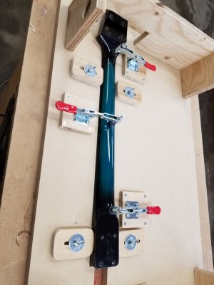

Here is a shot of the bottom where the neck gets clamped.

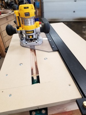

Here is a shot of the top with the tool guide and home made router base.
