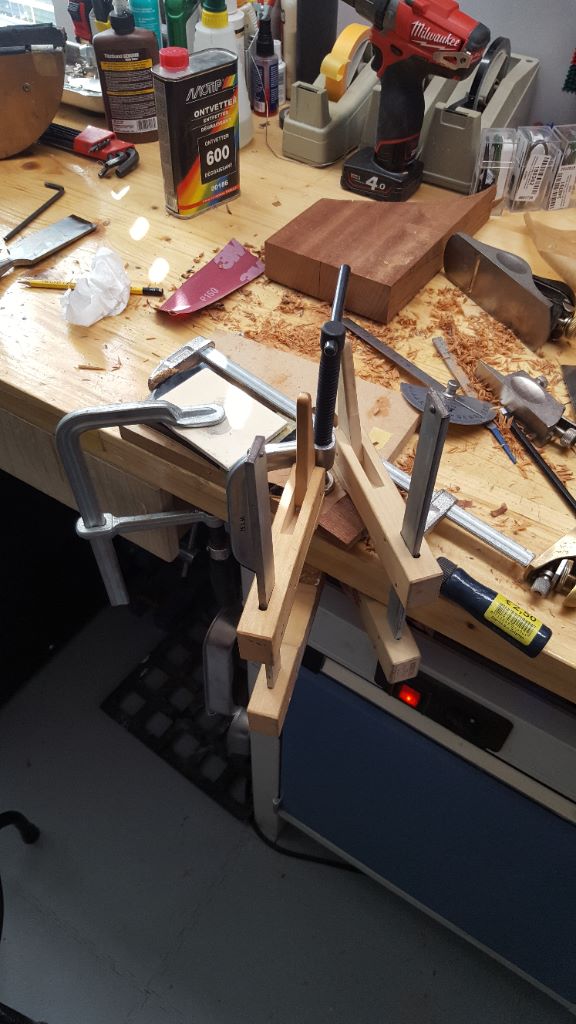

Postby Mario Kessels » Mon Feb 25, 2019 6:28 am
some update. Still hoping my method is going to work guys
clamping like a man.
not the same mahogany but since allmost of all of this will disappear anyway i dont mind too much. It is just to full up a tiny cavity with proper wood instead of filling it later with other material
this is my new glue surface. Should work in theory. Nice to see the glue lines of the epoxy, quite good.

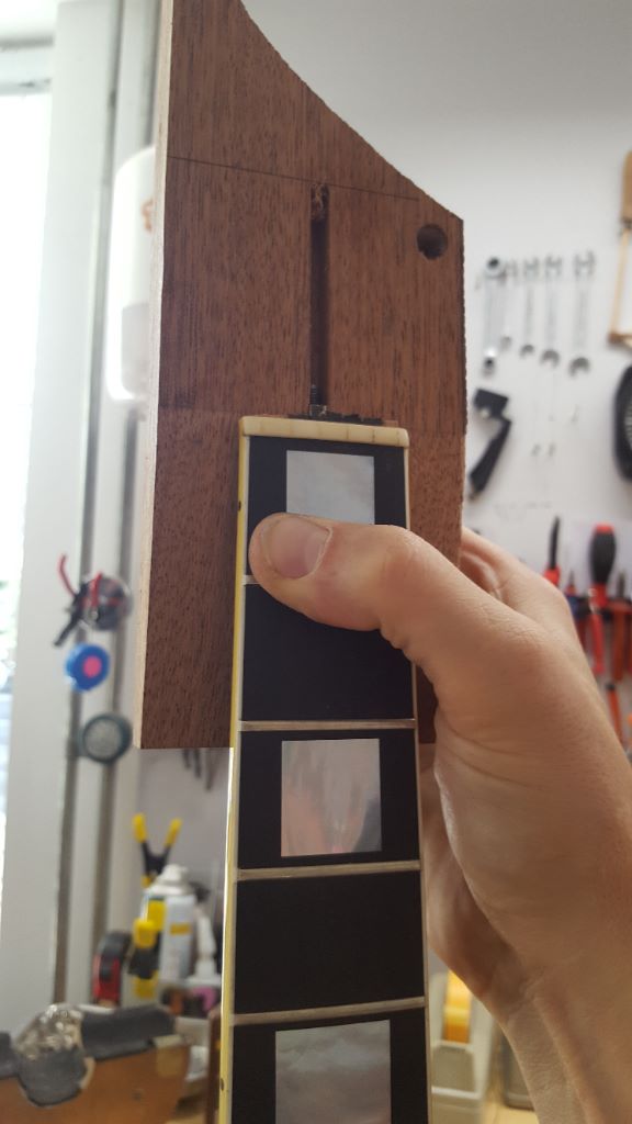

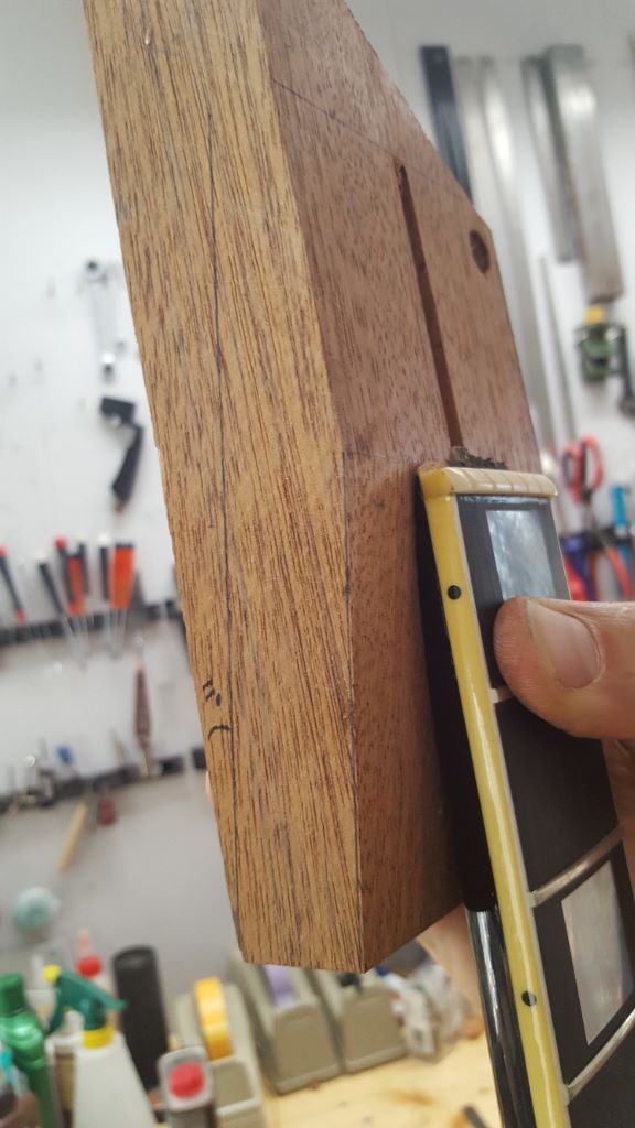

Postby Mario Kessels » Wed Feb 27, 2019 10:51 am
And some more progress. I still have good hope this works out. .

Postby Mario Kessels » Wed Feb 27, 2019 4:46 pm
Thanks Barry. Should work like this. and the original headstock can stay on. Do you see any problems I am forgetting about at this moment?

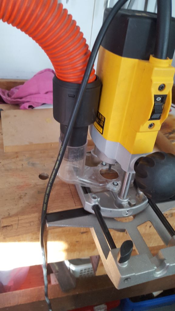

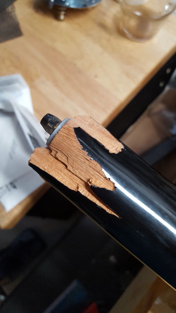

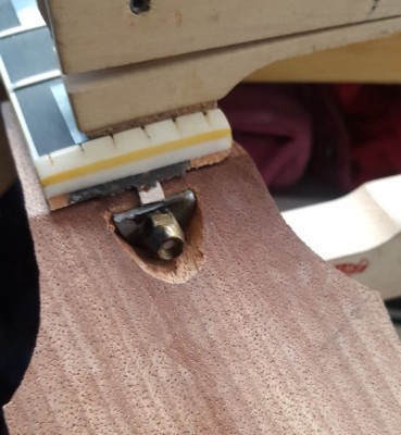

Postby Mario Kessels » Mon Mar 11, 2019 12:34 pm
Created some space for the washer and the nut
