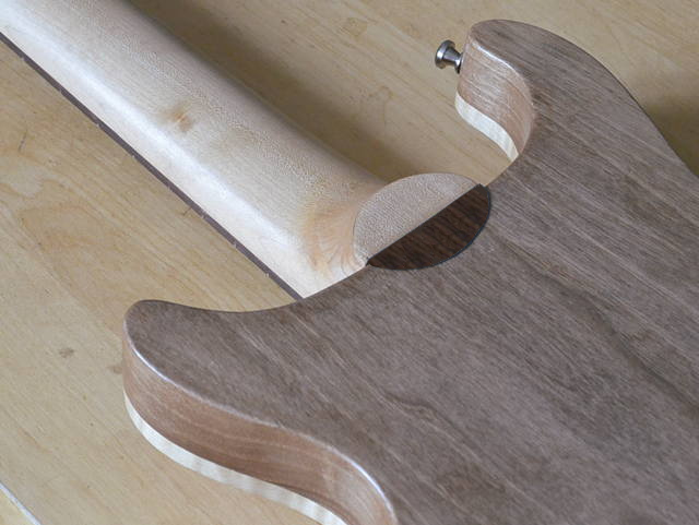

Postby Beate Ritzert » Sun Apr 28, 2019 8:48 pm
Well, the same neck: a nasty mistake while fitting it - the neck pocket was so tight that i did not fully see that misfit because the neck never was correctly in the pocket :-( The gap appeared to be a lot narrower as you can see from the slice of maple it dit already fit into the slot. And i should possibly not work at 3 o'clock in the night... And i needed to deepen the neck pocket a bit after sanding the body.
Anyway: the opposite side seems mostly "ok" although not "perfect".
Well, as a repair i am considering filling all three sides with a narrow stripe of rosewood. Intentionally make a contrast. Or would You use maple or walnut for that?

Postby Carl Dickinson » Sun Apr 28, 2019 9:40 pm
Use ebony to match fingerboard.

Postby Carl Dickinson » Mon Apr 29, 2019 9:26 pm
Oops....fingerboard is rosewood. :oops:

Postby Chuck Tweedy » Mon Apr 29, 2019 9:39 pm
i agree - use a dark wood to make the contrast - you can see how it would look in your photo where the shadow is acting as a dark line

Postby Beate Ritzert » Tue May 07, 2019 6:41 pm
What do you think of the following idea to hide the gap frm the back (where it is widest)?
Regarding the gaps on the sides. These are much more narrow. I am considering to do a very narrow inlay of, say 1.1-1.25 mm (< 1/20 in), but i am completely unsure on the best way to cut such a slot. The cutaway would enforce a cutting angle of about 45° if i used a large chisel. And my smallest chisel is 2 mm, so i need to buy something appropriate.

Postby Barry Daniels » Tue May 07, 2019 8:43 pm
I like the back inlay. Looks intentional instead of corrective. Very creative.

Postby Beate Ritzert » Wed May 08, 2019 6:39 am
Thanks.
The main reason why i did not just do it is the questions on tools and procedure for the slots on the sides, which need to be done first, see Image
