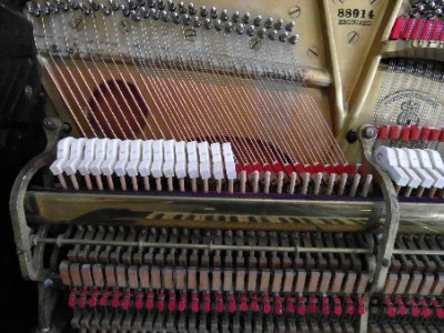

While you have all of this out, inspect the hammers and dampers.
Check to see if the flange hing bushings are good (little or no play). Look to make sure all of the little springs are working correctly and in place. Tighten all of the screws to be sure they are in place.
Look at the wear on the hammers and if the dampers are in good shape or need to be replaced. Look at the back check felt. If it holds the hammer after it strikes the string, it probably can be left unchanged.

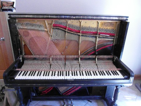

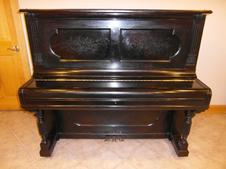

Steinway upright rebuild-- This is the steps I went through working on this piano.
The piano is a 52 inch upright dating from 1896 or 1897.
The piano had water damage on the top. The rest of the case was acceptable for age.
The tuning was way off, at least a half step down, with very few notes tolerable when played.
The ivories had 2 keys with small chips and one which had most of the lip gone.
When the front cover was removed, all of the hammers and mechanism worked and all of the keys played. The hammers and dampers were black from all of the grime and smoke and dust the piano had been around.
I found no evidence of mouse habitation. (The 1887 Steinway I worked on previously, and this piano had metal screening on the back of the piano to keep the mice out.)
The bridle straps did need replaced. This was the second (or more) set of bridle straps that had been placed.
The single bass strings on the lowest section of single strings sounded fairly good. The double bass string area on this piano looked like they were steel wound. They sounded awful.

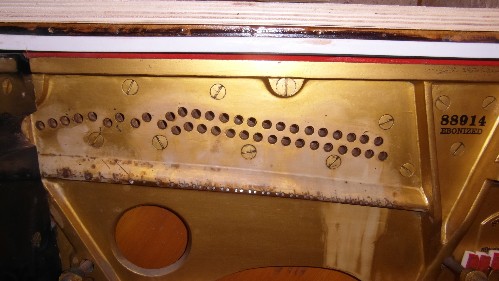

Some staining of the steel plate was present. I think someone had tried to dope the pin block with polyethylene glycol. It did not seem to work.
I shortly realized that I needed to redo the pins and restring the piano.

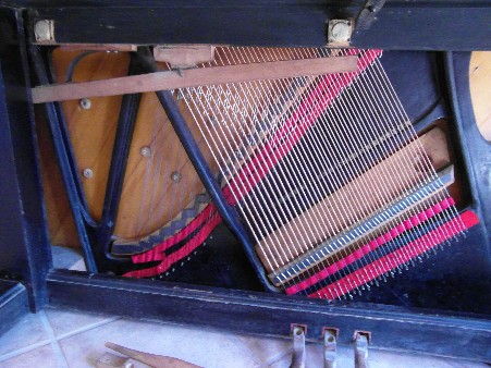

I removed all of the strings, and got the bass strings ordered. I ordered a few more of the unwound strings that I needed. (I had some around from the last time I restrung a piano.) I knew it would take 4-6 weeks to get the bass strings.
I cleaned the piano top to bottom. Removed the keys, strings and tuning pins. Vacuumed and wiped off all of the casework inside and outside.
Three keytops were damaged. Two had small chips, and the third had the front lip mostly gone. I had a lot of old ivory from old pianos. This was mostly .040” thick. The Steinway ivory was .045 “ thick, and about 1/8” longer than the other piano ivory I had.
I took the most damaged ivory off of the key top, knowing I would replace it. I used small files and chisels and saws, and scarfed in a repair using a small piece of the ivory I took from the one damaged top. I used superglue. These repairs worked well, and I have to search to find the repair.
I ordered a couple of used ivories, and was lucky enough to get the correct thickness and color and length to replace the third damaged ivory.
I leveled the key bed.
One flange bushing needed repaired.
I took off all of the damper felt.
I took off all of the hammers.
I cleaned the mechanism with brushes, and vacuums, and wiping off a century of grime and dust.

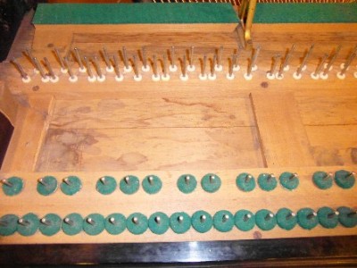

Somewhere along here I took the tuning pins out.
I carefully cleaned the iron plate, vacuumed everything out of the pin holes, and replaced the pins with the next size pin. Standard pins are usually #2. The next size up is #3 and is .004 “ bigger diameter.
Pins are available in more than one length, so be sure what you are ordering. I replaced with nickel plated pins to look nice, and avoid rusting problems.
To place the new pins, you are supposed to hammer them in rather than turn them in like a screw. I hammered them but was not able to seat them as deeply as needed with a hammer. So I “screwed” them in further with the tuning wrench. I did not feel comfortable hitting the pins any harder than I was.
I had about 3 weeks wait while the hammers and strings were being shipped. During this time, I worked on the case.

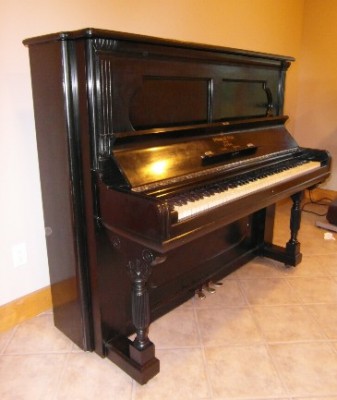

The piano was black lacquer/paint. I used the vacuum press I built to veneer the portion I could place in a bag. The veneer on the piano was a 2 layer veneer. On the portion I could not place in a bag, I used weights to glue the veneer down . The original glue had been hide glue. I used Weld wood, a water based urea formaldehyde resin.
The legs, fall board, key front, top front panel, and bottom front panel come off easily. They had slight wear and tear to the finish. The front of the piano below the key bed had a lot of injury, probably from moving the piano. None was very deep, but it was marked a lot.
I suppose I should have steamed the areas where the wood was dented, but I simply spray painted black. The areas where I added the veneer were spray painted with rattle can black, 3-4 coats. I did put some clear lacquer over the parts where new veneer had been placed after they were painted black.
As I was trying to figure how to make the finish look right with part new and part old finish, my wife suggested shellac.
I started with the bench, which had finish cracks as you would expect. A small chip of the veneer was missing on the bench, and I repaired this, and sprayed black paint to match the color.
I used the shellac, and pumice. The pumice ground down the surface, moved black into any of the areas of deep finish loss, and sealed the surface. I did not take this down to the point of hiding the old finish, but more to fill defects with the black color.
I did the same with the piano. This worked well to fill some defects, and to even out the finish over areas which had been painted.
I shellacked over the logo on the fall board by building up several layers and avoiding the pumice over that area.
I did not buff out the piano. I did not want a piano that was gloss lacquer. I did not mind that it had a pattern consistent with it's age.

The tuning pins were in place, piano had been cleaned on several occasions. The action was removed from the piano.
The under wire felt was placed, and I started stringing the treble section. The catalogs list a lot of different felt products, and it is confusing finding exactly what you want and matching what was in the piano. Save any of the parts until you are sure you know what you are replacing.
As with any instrument, the downbearing on the bridge influences the tone and volume of the string as it is played. I don't have a “downbearing gauge”. If you wanted, you could easily make a gauge prior to removing strings. I was not going to replace the soundboard or rebuild a bridge, so I simply copied the thickness of the felt as well as I could. In addition, I don't know what the original down bearing would have been, and when the soundboard changed shape sufficiently to lose the down bearing.
When restringing, it is important to have your pins in the pin block at the depth they are supposed to be. If you screw them in, they will some how go into too deep sometimes. As you string, you need to make tight coils and keep these pulled up from the pin block area.
After the tenor section, the bass section is quick to string. Try to turn the bass strings in the direction that tightens the windings rather than loosening the windings as you place them on the hitch pins.
New strings will stretch. You can buy a “stretching tool”, or on the unwound strings, I stretch them by running a wooden stick against them. The strings will need about 3-4 tunings over a month or more to stabilize. Do not take them to a higher pitch. You will probably break the casting on the piano.
With the strings in place, I glued the dampers. The screws which held the dampers were very rusty and many were frozen. After help from the mimf, I placed some mineral oil on the screws, and heated them with an electric soldering iron. This loosened them well.
Make sure you don't move anything that does not need moved. The multiple wires and dampers moving next to each other can be tricky to keep from touching each other.
The dampers are easy to glue in place if you have the hammers removed. Much more difficult with the hammers in place. I used white wood workers glue, but hot hide glue would work well also.
The Steinway has double dampers on the first few strings in the tenor section. Getting these aligned and positioned so the hammers strike the strings without interference is quite time consuming. If you have these, be careful to note how they are positioned, and try to not change them if you don't have to.
When you are having trouble getting the dampers and hammers sitting on the strings correctly, make sure your strings ( in the tenor and upper sections) are spaced correctly. They can be slid over a little sometimes (unintentionally or intentionally).
If a hammer is not aligned well, you can heat the shank and bend it slightly, or you can loosen the flange screw and shim the flange with a 1/8” slip of paper on one edge.
After the dampers are installed, make sure all of the hammer shanks look well positioned. Make sure the hammer shanks are cleaned of any old glue and that the hammer heads slip on easily. Glue the hammers with the action in place.
I used hot hide glue. I put a couple of drops in the hammer hole, used a nail to make sure all sides were covered and that there was not too much glue then placed the hammer on the shank. Push the hammer forward so it contacts the strings. Wiggle it one side or the other if it needs fine adjustment. As you glue them, they should all look perfectly aligned.
The bass section all had the same angle. The upper treble section was all straight.
The middle section had a changing angle. I had to plug the holes that had been drilled, and redrill all of these with a gradually changing angle. I used the jig that I have discussed in the piano tools posting and copied the angle. Some of the hammers were plugged and redrilled more than once when I did not get the angle perfect. This did not seem to be a problem and the hammers seem to be glued well and function correctly.
One of the problems that arose was the double damper section in the first part of the tenor section. The hammers have very little room to pass between the dampers. I had to fine adjust the dampers, slightly bending a couple of wires, and sanding the upper corners and lower corners off of the hammers. The face of the hammers was untouched, but the upper and lower corners were eased back a little to make sure they cleared the damper wires.
In the upper treble section, the hammers were striking the strings over the casting (not striking the vibrating section of the string. I had to take the hammers off, and shorten the hammer shanks by about 1/8”. I made a bent metal jig with a hole in the end. This slipped over the shank, and I used a fine toothed saw to cut the end of the shank. I smoothed the end with a little sand paper, and then glued the hammers again.
If you are more than 4 foot away, you don't see any repairs or realize that part of the finish is spray paint or shellac.
While taking the piano hinges off, the screws in the area of water damage did not come out well, and several broke off. I had to drill these out, plug the holes and redrill.
Buying nickel plated #6 oval head 7/8 inch screws was difficult. I finally found some, but they are not common.
I used cleaner, and pumice to polish up the nickel plated piano hinges before reinstalling them.

I assembled all of the covers, and case, replaced a few buttons which were missing, and I was Finished!!
The entire process covered about 3 months. The most time consuming part was working on the action. Adjusting the double dampers took a lot of time. Gluing the dampers and hammers really did not take much time. Drilling the hammers with the jig was actually very easy. Without the jig, it might have been much harder.

New Strings in place. Action removed, keys in place--
Keybed with part of keys removed
Underside of keys --
Closer look at the key bushing--

This is the Bass section of the piano--
No pins or strings. Note the discoloration around the pins. Probably from doping the pin block to tighten the pins.
Now with the strings in place--
Now with dampers and some hammers--

Another picture simply showing the lower portion of the strings
Pedal work view--
Pedal work view--
