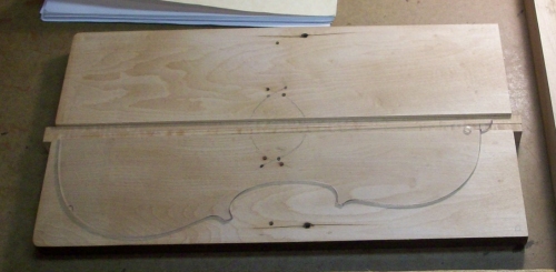

I'm recycling an old piece of wood for a guitar top (lightly spalted Maple). From it's previous incarnation, there are 4 little (less than 1/8 inch) screw holes that there was no acceptable way to exclude. Who has the best method for patching them?

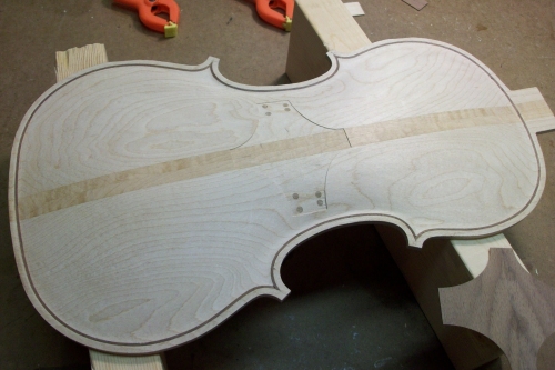

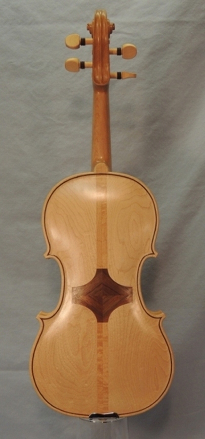

I know you said it is no place for contrasting inlay, but this is what I did for a piece of maple salvaged from a kitchen table that had screw holes in it. At first I thought of just plugging with a contasting wood, but didn't like it, so put an inlay in.
Not quite invisible, but maybe something to think about.

John, great job on the fiddle!

How about ripping along the grain right through the hole jointing and regluing. No more holes and almost a grain match. A picture would be nice.

I love the inlay on the violin!
