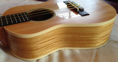

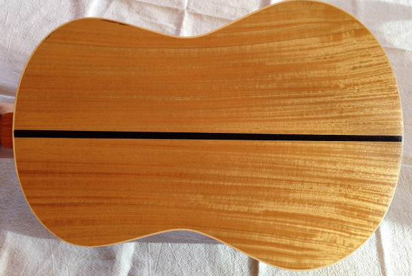

I've been away for a while and just completed this flamenco style 'ukulele based on 1951 Barbero Flamenco, Ex Sabicas (plans from The Big Red Book, Vol. 5 or from GAL Plan). While not an exact copy (not a typical Spanish heel) I tried to stick to the design and look. It is strung up an a
Woods: Spanish Cedar neck, Ebony fingerboard, Spruce top, Ceylon Satinwood sides/back
Tuning: standard re-entrant G
OAL: 27"
Lower bout: 8.5"
Upper bout: 6.5"
Depth: 3.125"
Weight: 22 oz.
Bracing is copied from the Barbero plan
The bulk of the instrument was built in late 2012/early 2013, but hung uncompleted until 2014. I put the finish on several months and have just gotten to installing the bridge, pegs, saddle and nut this past week. It has a deep (for a 'ukulele), strong sound with good sustain. Overall I'm quite happy with it, not perfect, but each 'uke I build seems to get better.

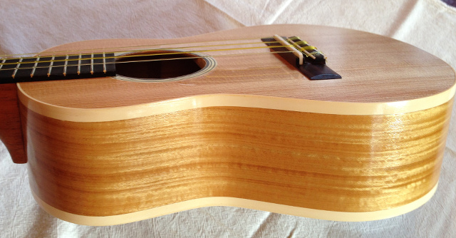

Side view, showing the Ceylon Satinwood
Back
Back

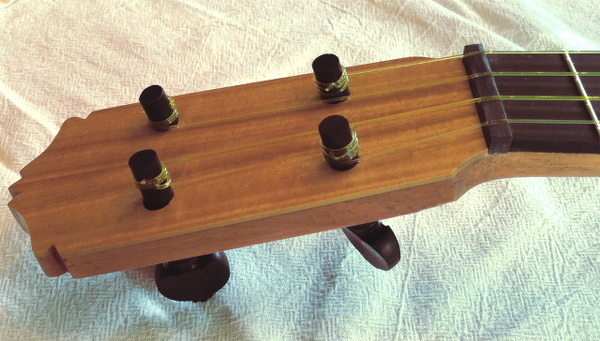

Headstock
Headstock

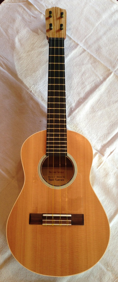

Somehow I missed posting the "Overview" picture!
Overview picture of Flamenco 'ukulele

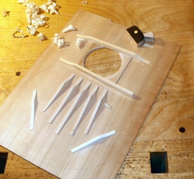

It looks really nice. What is Barbero bracing when applied to a uke?
Neal Carey
Posts: 98
Re: Flamenco Ukulele - based on Barbero 1951
Post by Neal Carey »
Thanks Patrick and Clay!
The bracing is the same as shown on the plan in the link above (GAL Plan). Pretty typical for a "classical" style guitar, but note the slanted brace just below the sound hole in the plan picture in the link. The braces are pretty light given that it is a 'ukulele. I tried to stick to the plan as much as possible, except for using a Spanish heel which would be pretty typical for Spanish classicals/flamencos.
Here's a picture in progress during brace shaving.
Shaving the braces
Shaving the braces
