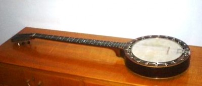

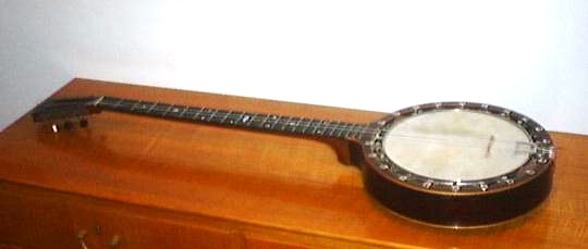

No, the zither-banjo is functionally just another 5-string banjo, but with a few peculiarities. First, the short 5th string runs from the 5th fret under the fingerboard in a tunnel to the peghead, so there's no side peg in the way of your thumb when going up the neck. And since 5 pegs look a bit unbalanced, they usually have guitar tuners, with one machine unused.
Then there's the pot: it's more like a resonator, with the tone ring and tension ring set inside it on brackets. This gives the zither-banjo more sustain than an "Ordinary Banjo", or even a resonator banjo, so you can play more legato on it. That's why it was the weapon of choice for the English banjo virtuosos of the decades around 1900. And the steel high strings give it more presence than the then usual gut. I mostly play classical arrangements of art-song tunes on mine, or use it for song accompaniment.
Here's one I restored some time ago (a Windsor No. 5): Cheers,
John
You mean, like a Ukelin?
