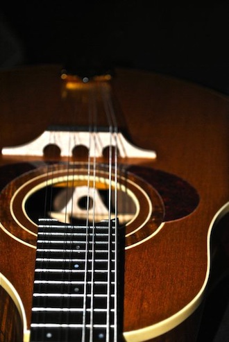

Postby Barry Guest » Sat Jun 08, 2013 6:11 am
I know that it has been tried in guitars. However, I recently tried in a mandolin with a quite amazing result. The system I used was not a soundpost per se, but what I call a "truss". It improved the sustain and the amplitude noticeably and the guy I sold it to raves about it. Sorry about the poor quality pic....it's the only one I have.

Postby Bob Francis » Sat Jun 08, 2013 12:42 pm
Interesting to say the least!
Was it mounted between the braces?

Postby Barry Guest » Sun Jun 09, 2013 6:55 am
Bob Francis wrote:Interesting to say the least!
Fitted to the curved surface of the back directly behind the bottom brace and fitted onto a flattened surface of the belly brace. What you can't see are three "half diameter" cutouts mirroring the bottom of the bridge....hidden behind the back brace.
I have to say that this mando was hollow in sound and lacked projection without the truss. Only God knows what made me do it! But on this instrument....it works. I am not recommending it as a panacea for the ills of an instrument, and I don't believe it would work in a guitar. However, being open to all manner of crazy ideas, I do believe that there is more to know about this phenomenon.

Postby Andrew Porter » Wed Oct 02, 2013 3:45 pm
Barry G. - What was the motivation to try the truss?
Andrew Porter
Posts: 98
Joined: Sun Jan 08, 2012 8:49 am
Location: The Banks of Sleepy Creek, NC, USA
Re: Experimental sound post in an acoustic slimline guitar?
Postby Barry Guest » Thu Oct 03, 2013 3:45 am
Andrew Porter wrote:Barry G. - What was the motivation to try the truss?
Andrew,
My motivation was to see if I could "deaden" the hollow sound that the mandolin initially produced. I had no idea if it would work, but it did.....increasing sustain and clarity.
