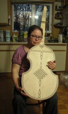

I finally had some shop time to move forward on Nicole's viola da gamba. Little by little this is getting done. I fit the bass bar, which was no simple thing! Carved it, then glued the soundboard to the body. This represents a MAJOR milestone for this project!
Showed it to my wife,Nicole, last night, she liked it.
Now onto the relatively easy and straight forward parts of making the fingerboard and tailpiece, pegs, and finishing.

Nice work. It looks great!

Beautiful job!

Looking great. What are you going to varnish it with (and what colour)?

Thanks, Rod.
I expect that I'll probably use my main go-yo varnish, which is Epifanes. I use a lot of it on my canoes so I know it well. I've used it on guitars, as well, and it performs very well. Sometimes I use it as a base and then shellac over it.
For colour, I was talking to her last night about that, and we're thinking the same thing. It will be a light brown/tan colour with a slight red hint. Neither of us are thinking dark browns or very pale, blonde, maple. So, something in between. The Fingerboard and tailpiece will be dark, probably Ziricote, and will have some inlay and borders. Pegs to match.
I deliberately made the back inlay and the front purfling bold in order to look purposeful under finish. I don't really care for the too thin lines of some purfling, it just gets lost and looks like "what's the point?"
